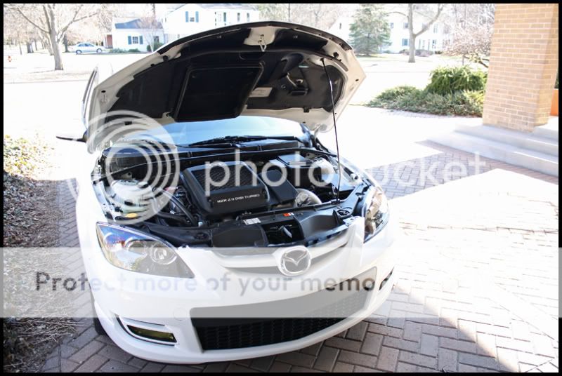

I got the RKM BOV/BPV today from ProtegeGarage. Initial impressions were that it was made a lot better than I thought it would be...seemed like it would be kind of cheap construction just based on the price, but it actually feels like a solid piece. Everything looks pretty quality on it, and it feels like it has some substance, especially compared to the plastic stock piece.
Install was alright...a bit hard at first because it comes with no instructions. I had to think a bit to figure out that the front section had to be removed to be able to insert the bypass fitting. Once I got that figured out things went a bit smoother. It was difficult getting the C-clamp in place, but doable. I got a pair of c-clamp pliers and compressed the ring, then slid the "open" side in the groove and pushed the other side (the "back") down into the groove with a screwdriver. It took a couple of tries, but I got it eventually. Then I used a screw driver and small hammer to lightly tap on the c-ring to make sure it was down all the way around. One other note is that you need to make sure you either re-use the stock gasket on the bottom of the stock BPV or get a new one.
I did have to make two modifications to get it to fit right. I had to cut the corner off the plastic intercooler cover...the bit that would have covered the stock BPV. It won't go on without cutting that piece. I also had to cut a hole in the plastic hood ducting where the vacuum line fitting is because it rubbed against that and cut through the vacuum line within a matter of minutes. Just cut a small notch where I saw it was rubbing, and it seems to be clearing just fine now. That might be avoided depending on how you install it, but the way I had it in there it just wasn't going to work without a hole cut in the duct.
Performance wise, I'd say it's great. Sounds great and holds boost very well. I was surprised how much different it was compared to the stock BPV. Seemed to be getting a lot more boost than I normally was. I guess my stock BPV was leaking more than I thought.
I'd recommend it to anyone who isn't afraid of cutting some plastic bits and wants a good alternative to the Forge unit. As a side note, I originally had the Forge BPV but sold it because I didn't really like the way it sounded. It's been a while, though, so I can't do a very good comparison of the two other than I like the sound of the RKM unit better than the Forge, and I like the fact that there is nothing to adjust on the RKM. No springs to change...no shims...just put it on and go.

can you take a picture of the part you cut under the hood ducting? I have the actual HKS which is still the same thing, but haven't tried recirc-ing it because it appears impossible to get the valve angled downwards enough to get onto the tube without the vac line and back end of the valve hitting the hood.
Id like to see what you cut to see if I will just do the same thing to my hood duct

hood duct cut pics if you can
I'll take some tonight. I may have cut more off than I needed, but I kept running into issues where it wouldn't seem to be hitting at first, but I later found the line had cut. I can show you how I did it, but I suggest taking something like anti-seize or some other stiff grease, putting it on the vacuum line where it sticks up, and closing the hood. This will show on the hood ducting where it is contacting the line. Then just cut around that area, and repeat until you don't see any grease left on the hood duct. Again, I will post up what I did, but I cut off a lot more than is probably necessary. It worked fine, though...got through a 700 mile road trip over the weekend with no cuts or wearing through!
