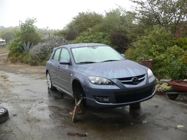

It is possible to install the front yourself. Just give yourself plenty of time. The only thing you need in addition to the things you would normally have around your shop is a big torque wrench for putting the sub-frame bolts back in.
However, try to pick a day it is not going to rain.(boom06)
