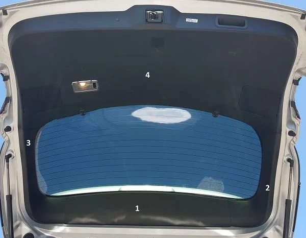

First: remove rear hatch paneling, there are 4 pieces.
attachment.php
Pop the first panel off.
Remove the 2 exterior clips holding panel 2 & 3.
Then pop those panels off.

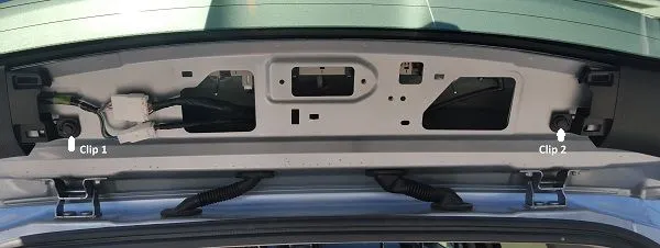

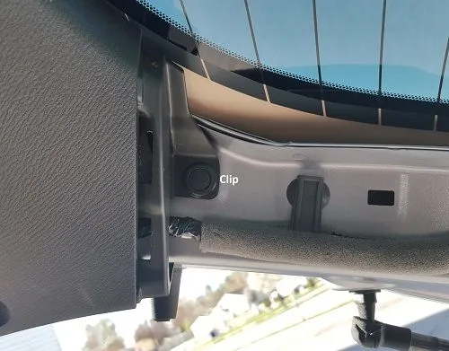

Remove the 2 exterior clips for panel 4, one from each side (they were underneath panel 2&3)
attachment.php

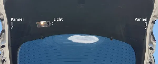

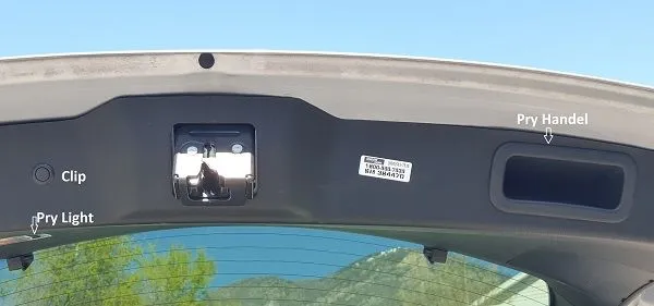

remove the two panels inside panel 4 and pop out the light fixture
attachment.php
Remove the final exterior clip and the handle on the base of panel 4
attachment.php

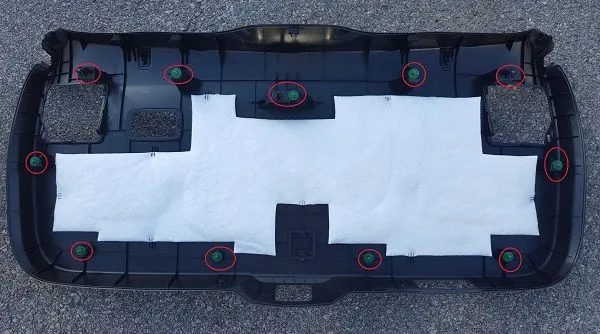

Next remove the 4th panel, here is a picture of where the clips are:
unlike the side door panel clips these ones do not break, or I am getting a lot better at this.

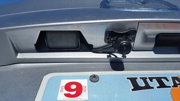

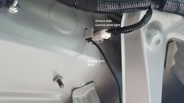

I chose to attach the camera right above the license plate.
So instead of drilling any holes, I ran the camera through one of the license plate light holes.
here is an interior view after I have reattached the license plate light:
attachment.php
Here is what the camera looks like form the outside:
attachment.php

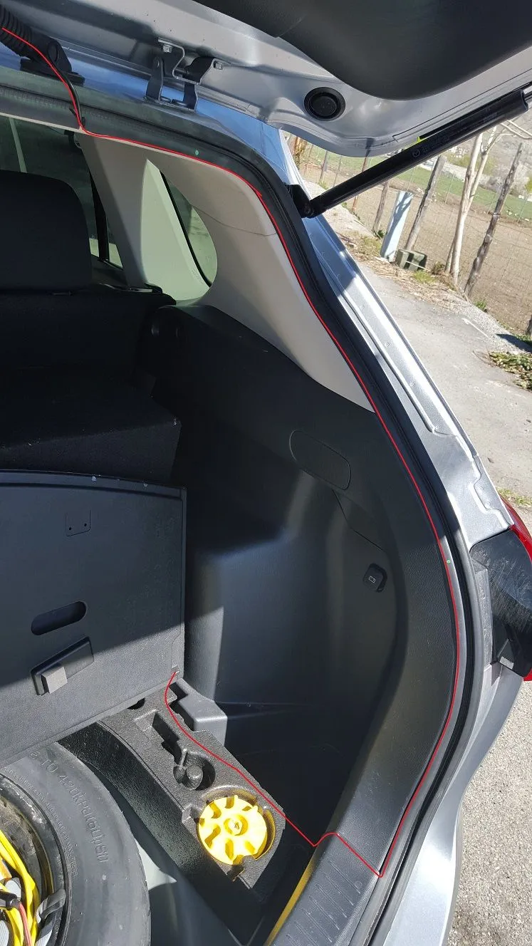

Now run the video cable and signal wire through the car.
I ran the cable loosely in between the body and the paneling that you are about to put back on.
Then I ran it into the body of the hatch and into the rubber conduit from the hatch to the main cabin.
However, you still need to get your wire into the main cabin. I cut a small hole in the rubber conduit.
I then ran the wire outside the conduit and into the main cabin.
I then tucked the wire into the weather stripping from the top all the way around to the bottom.
I then ran the wire under the plastic trim for a few inches and then underneath the foam space holder.
attachment.php
I then went around the seat and tucked the wire under the side trim.
I was able to tuck the wire from the back seat all the way into the glove box compartment without removing any trim.
This is where I ran out of wire length. So I attached the video signal extension, and spliced a few more feet into the signal wire.
I removed the glove box, and ran the wire to the back of the head unit.
