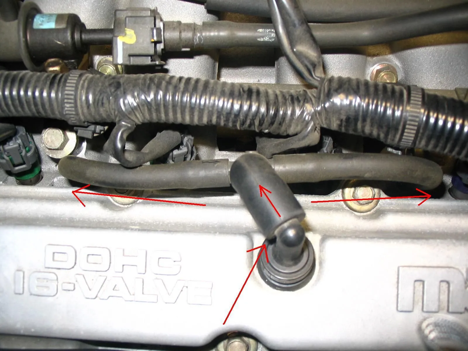

I want to do this before I take my car out this season. I would like to see pictures as well. People who have done it please post pics of where you poured the seafoam.
Alright I haven't done it yet but from what I've read the picture I just took should be the best place to let the seafoam get sucked from. To get the seafoam evenly distributed throughout the manifold the the T connection should be left intact and only the PCV valve (small black L shaped plastic piece) should be removed from the tubing.
It seems that the vaccum tube is very short so I will be adding additional tubing which I will drop into the seafoam can.

Notorious_V.I.C said:
I'll be buying two bottles of this if it is $5. one for the mani and the gas tank
You'll be fine with one, you'd be surprised what one can will do. The smoke screen will cover your whole street. Becareful to do this in a well ventilated area and just use one bottle. If you still don't notice a change after one you just might not notice it at all. Good luck guys.
