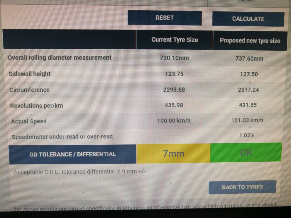

245 50 19 is as close as you can get in comparison to stock.
I've seen cx5s with 235 55 19 and 235 50 19 as well. Former is a bit higher, while 235 50 car sits a bit lower but looks very nice. even with 235 50 19 the cx5 looked much nicer than 225 55 19. Which look too thin especially with the black rims. Its even funny looking to me :)

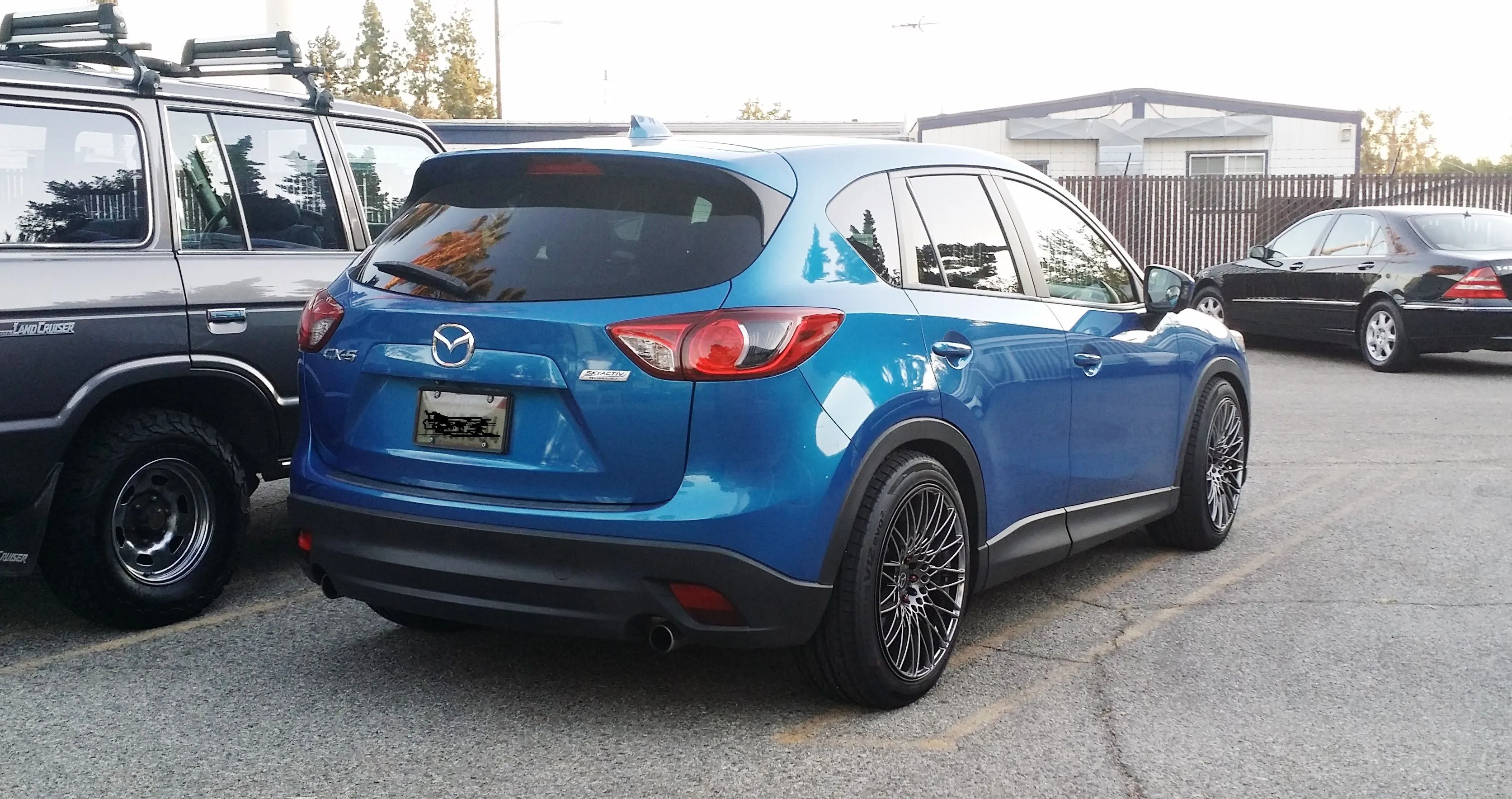

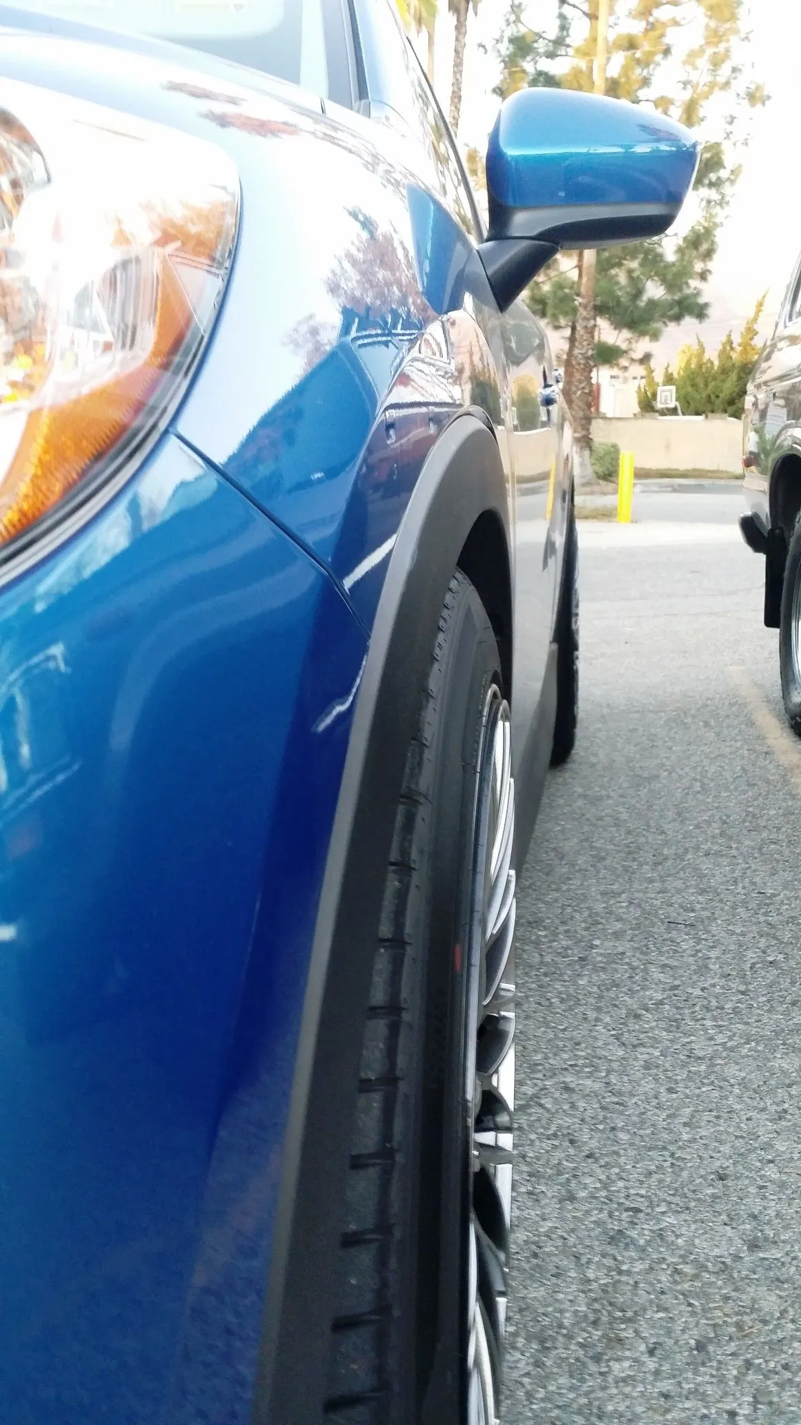

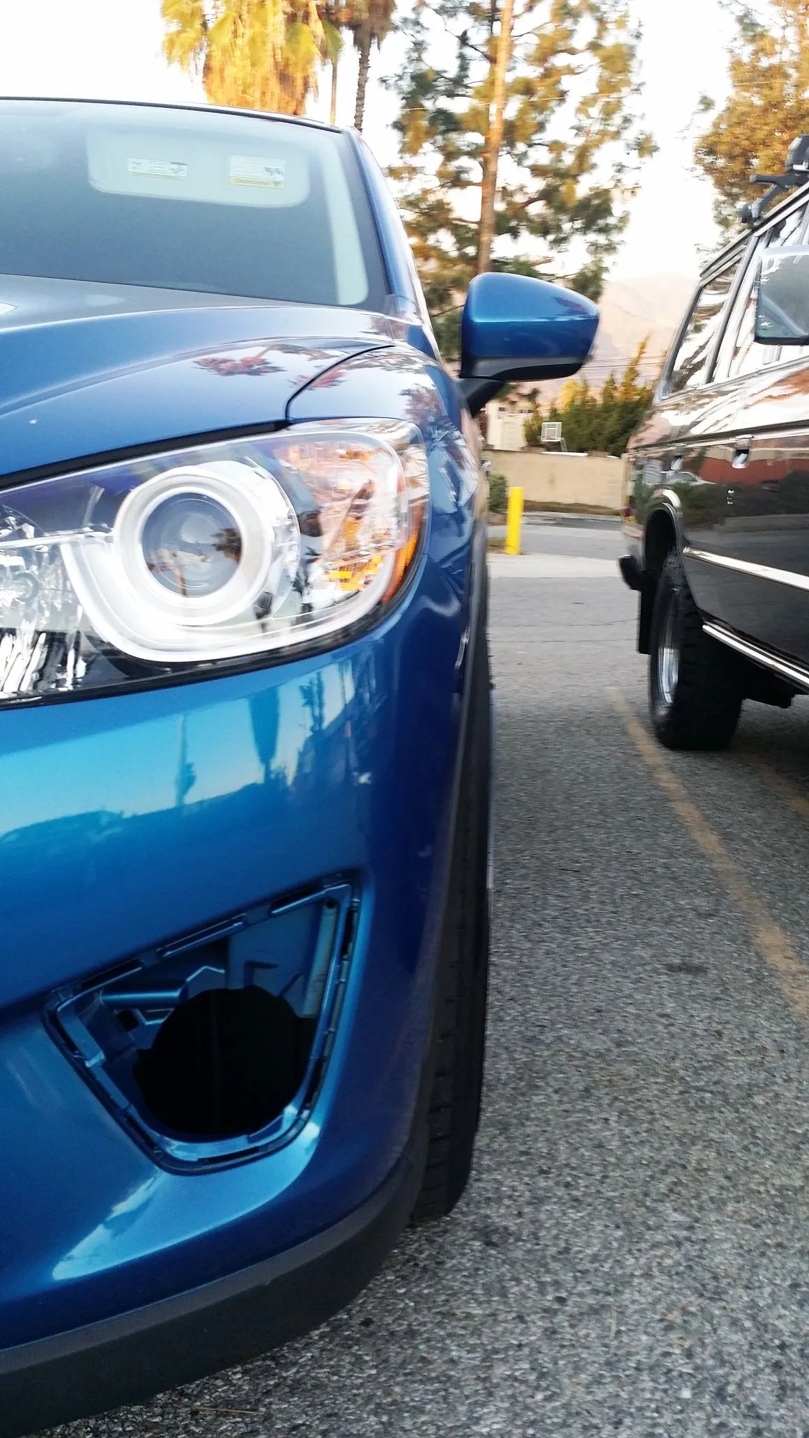

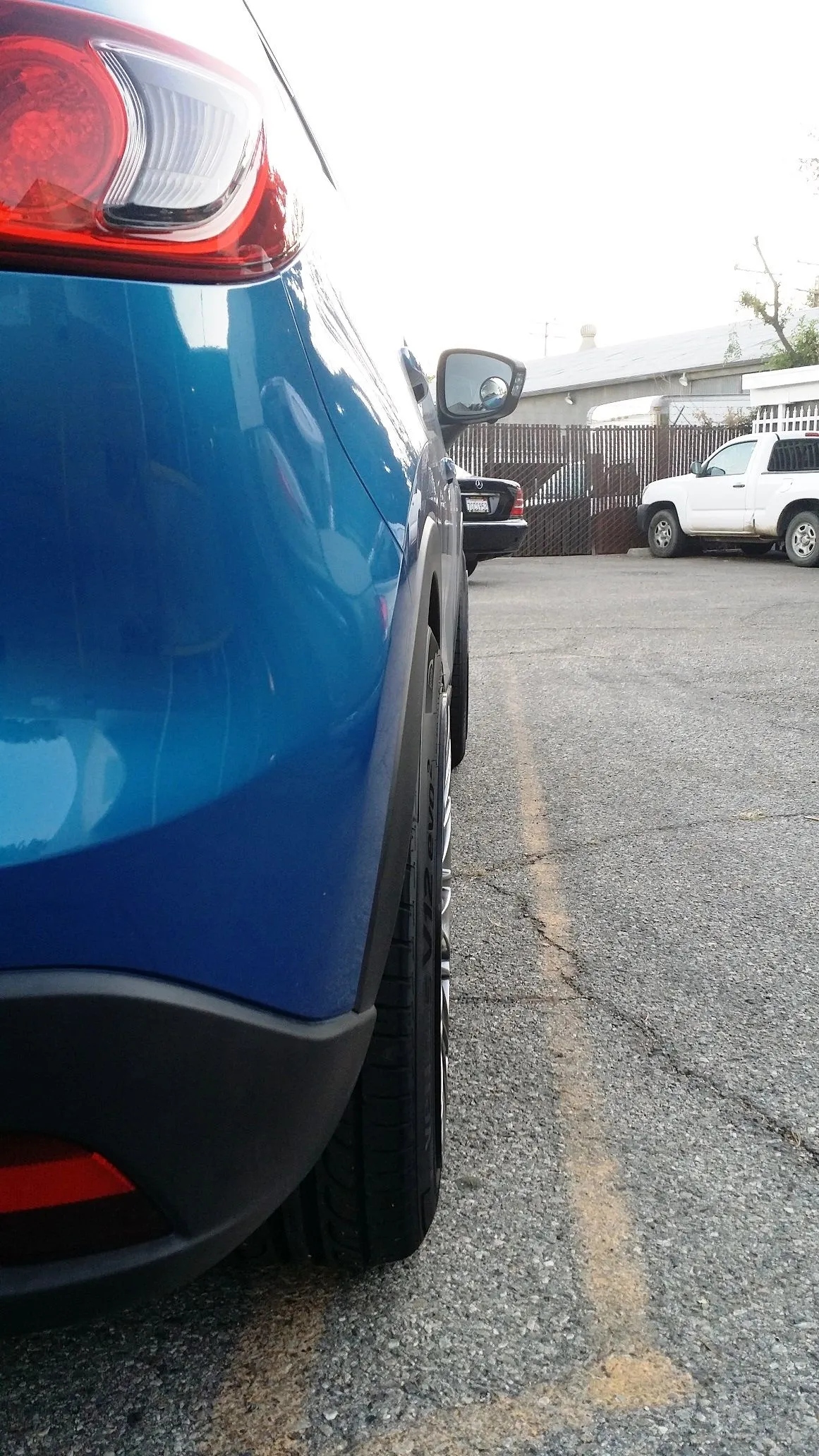

This is my setup, but it is 20x9.25xET35 XXR 553 wheels, tires are 245/45/20.

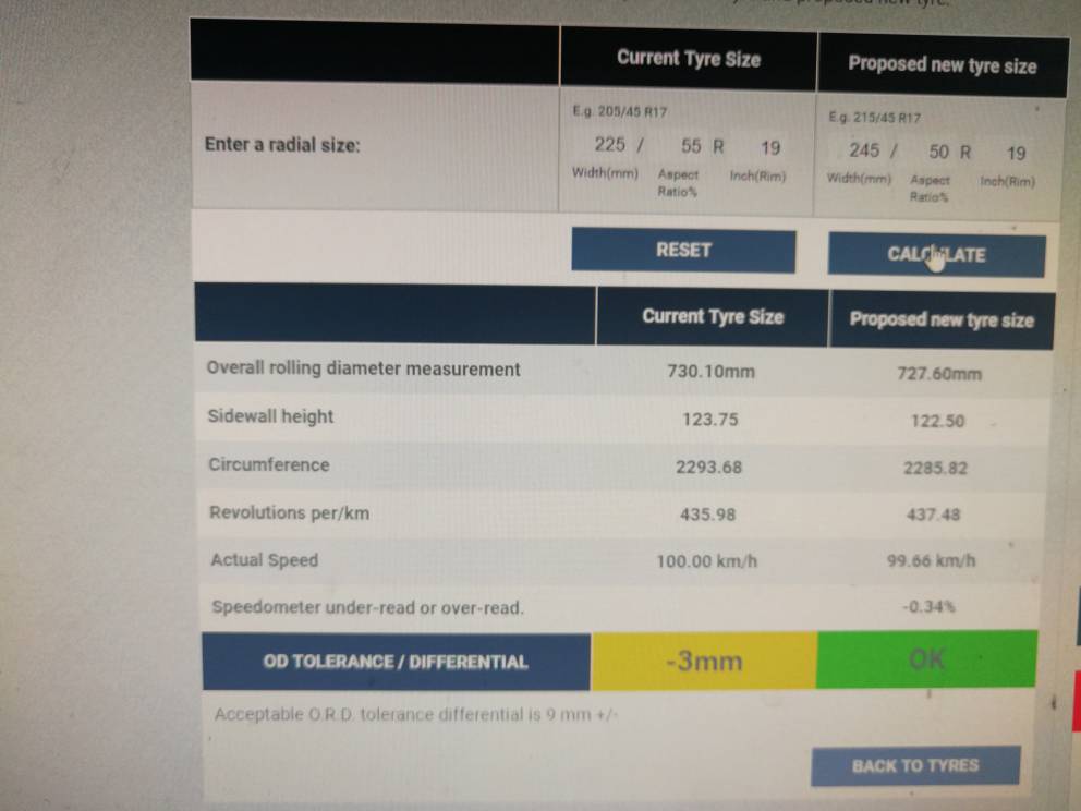

Thanks for your input. The 235x50 will have a - 3mm OD difference and the 245x50 7mm difference. They say it must be +-9mm OD difference. Others have said there is the old school methods were 1.5% and - 2% and the new specs it must be +3% or -3% difference.
