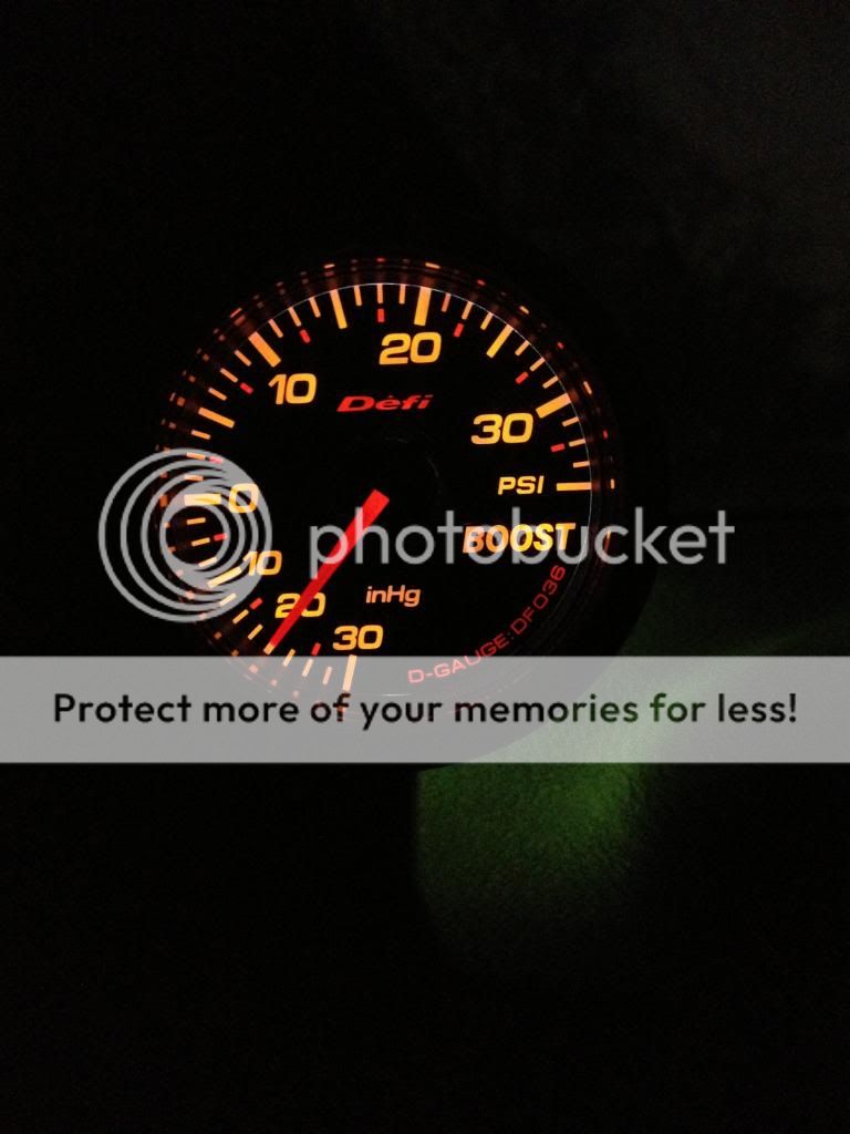

This is where it sits while idling after I have started it and let it warm up for about 10-15 minutes before driving it...where it should...
Now when I got to work, it was dipping slightly below that as it was fluctuating (20-25)
