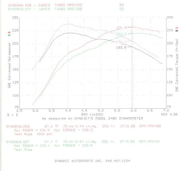

We made 260 WHP in our P5 with stock internals with no problems at 14 psi of boost. Anyway, we later went with forged rods and 8.5:1 compression pistons (Mazda Pistons) to be in the safe side. The only weak part inside the FS engine is the connecting rod.
Here are my suggestions:
FMIC KIT
Larger GT28R or GT28RS Turbo
Haltech F10X for fuel management or E6X for Fuel and Ignition control.
Pauter Rods
Lower compression pistons if no ignition retard system is used.
ACT clutch
Cold PLugs
2.5 Cat back exhaust.
With these modifications 300WHP on 100 octane are easy to get and 250 WHP reliable on 91 octane fuel.
Here is a dyno run at 10 psi
Juan
