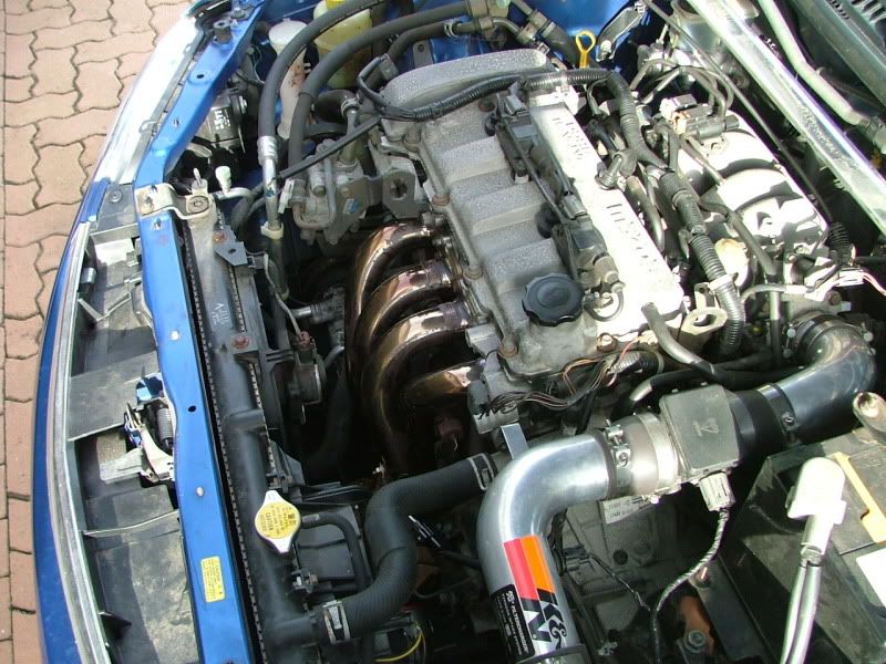

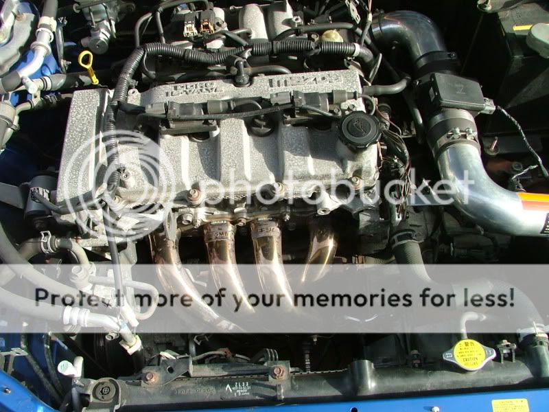

Heres some photos of the Headers pre install:
There pretty expensive, but represent the best off the shelf items. Only thing that is possibly as good is the AWR header (never seen a set/measure etc). Shame that so few headers for the protege are actually tuned can only think of three off the top of my head :(
This is what they looked like installed on my old car:

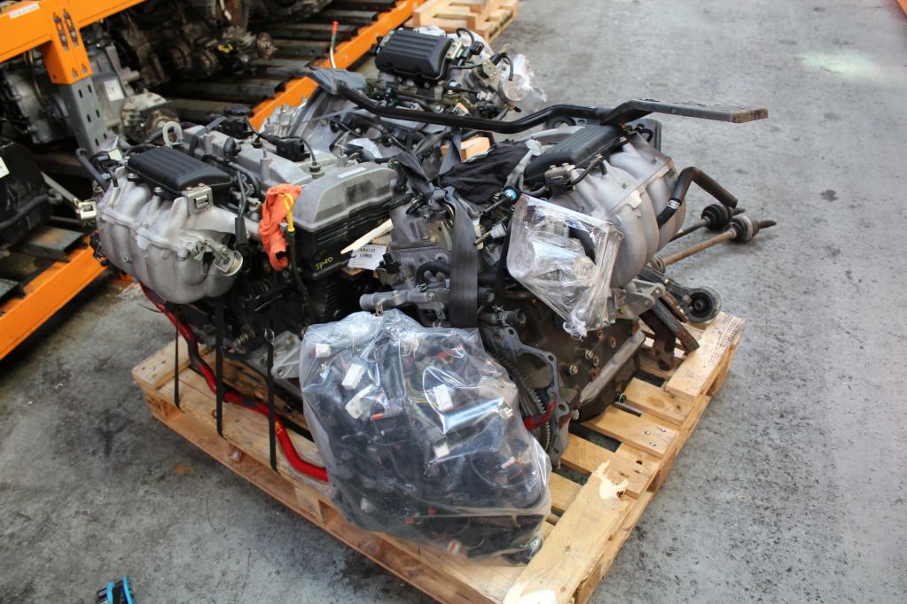

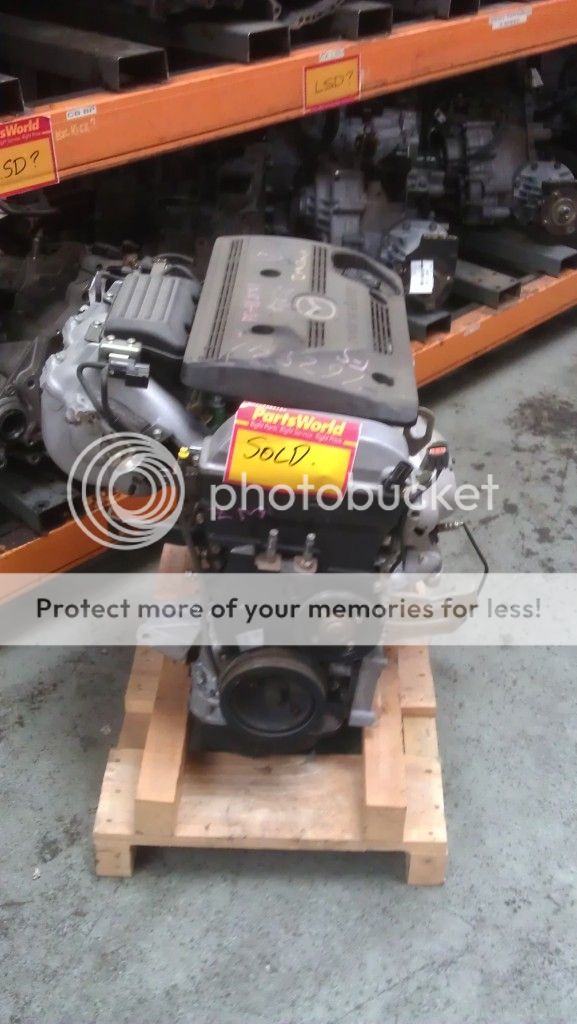

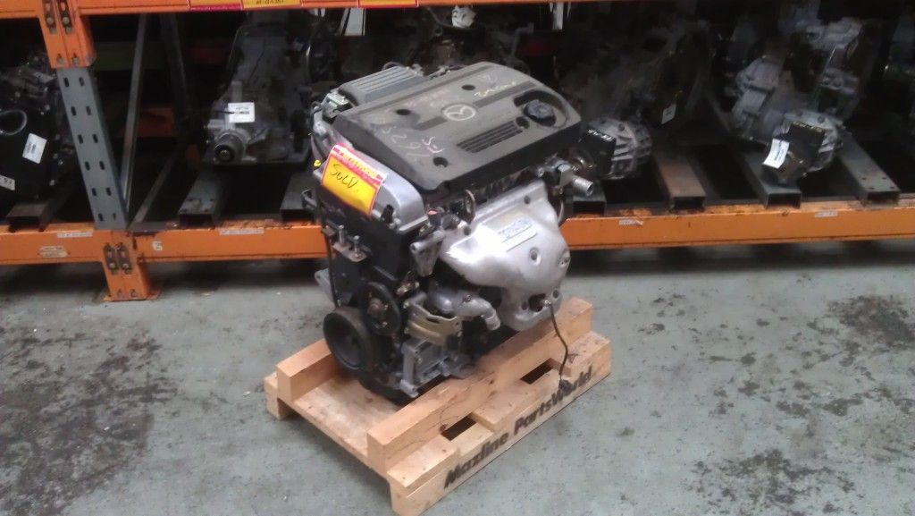

Alrighty, thought I'd upload some photos. Here's my engine and some other engines we got sent over in a pallet:

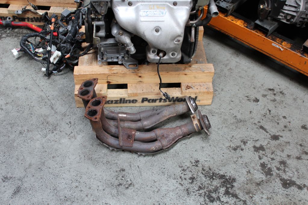

This is what the second piece of the FS-ZE Header looks like as I don't think many have seen it before:

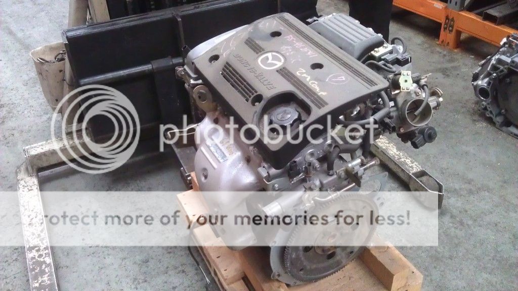

Some more photos of the engine:

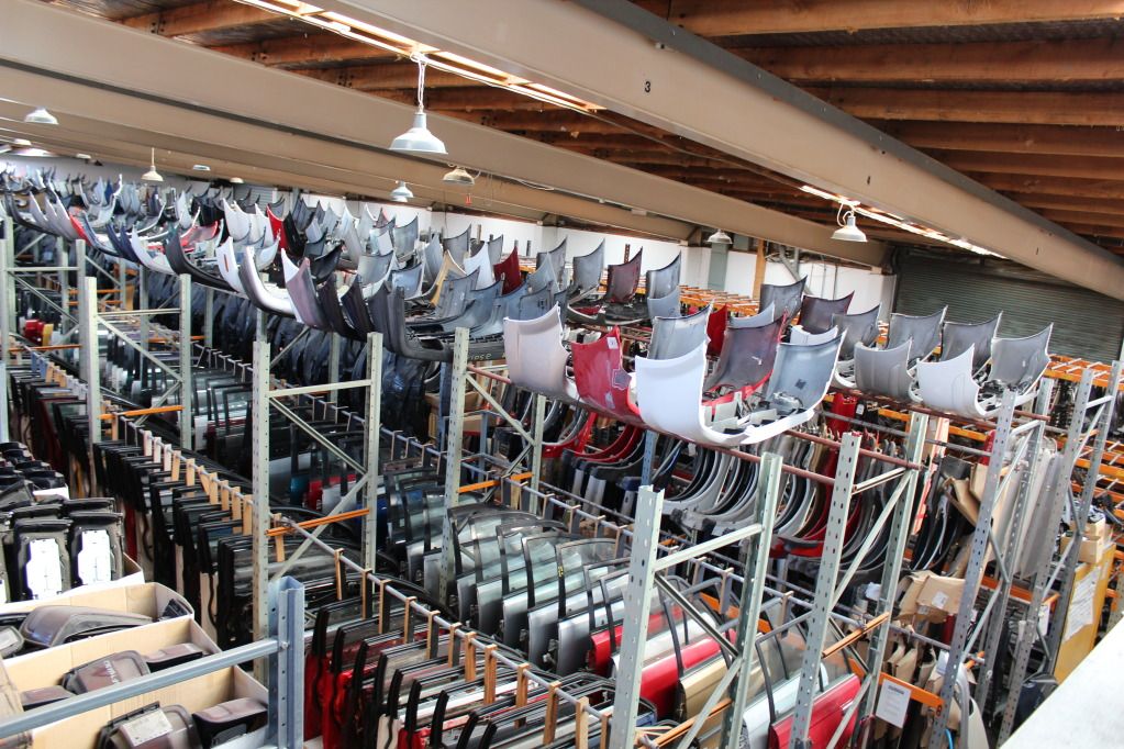

Not sure what the wreckers are like in US but in NZ its pretty crazy:
Thanks to Phil who a) went and got got my engine and b) for the photos.
