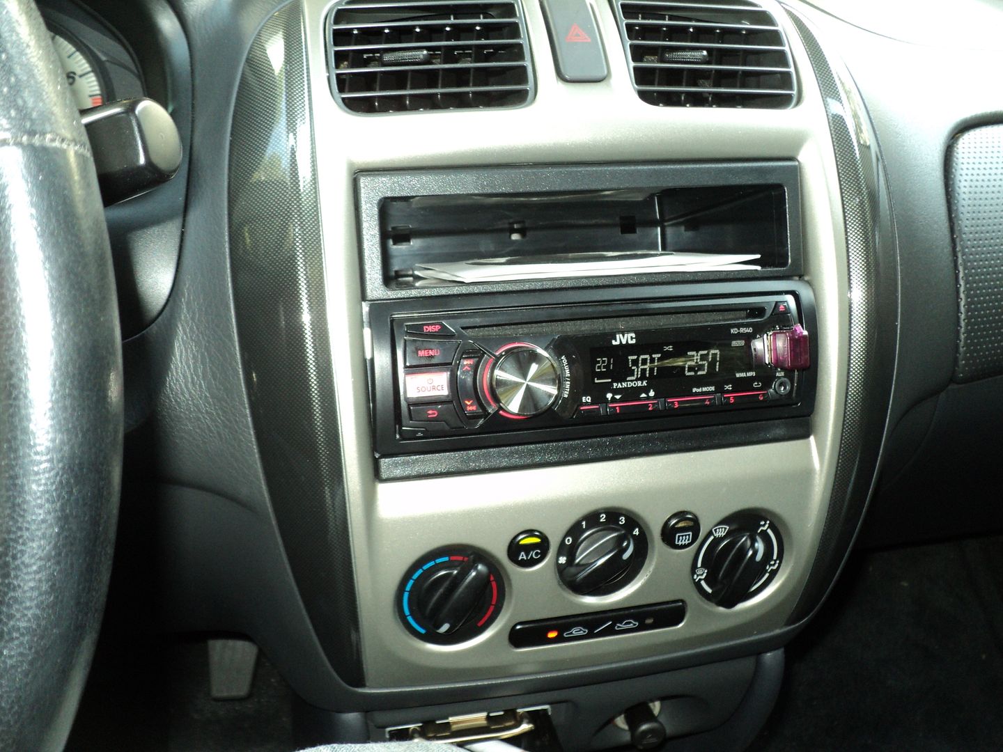

up next was the fix for the first issue found on the ride home: the rear speakers did not work. at all. on my last one, the internal amp in the radio had gone bad and caused this same issue. so I assumed that it had happened again. also, the head unit would not accept cd's, so that was an issue. the first radio I ordered from crutchfield as a really nice, double DIN pioneer. big easy to read scree, big buttons, great sound. really liked the unit.
until I drove it at night. with the thing dimmed as afar as it would go, I could still read in the back seat from it. way too bright and distracting. crutchfield was cool about it, and we selected a JVC replacement that doesnt sound quite as good and is a little harder to use, but has lights that you can all but turn off. it does hat I need it to do, and does it well. also matches the style of the dash really well.
this did not correct the rear speaker issue entirely. one was obviously blown, and the other wasnt operating still. so I pulled the rear door panels to investigate.
and swapped in a pair of 6.5 inch cheap, crappy speakers that were functional. (no pic)

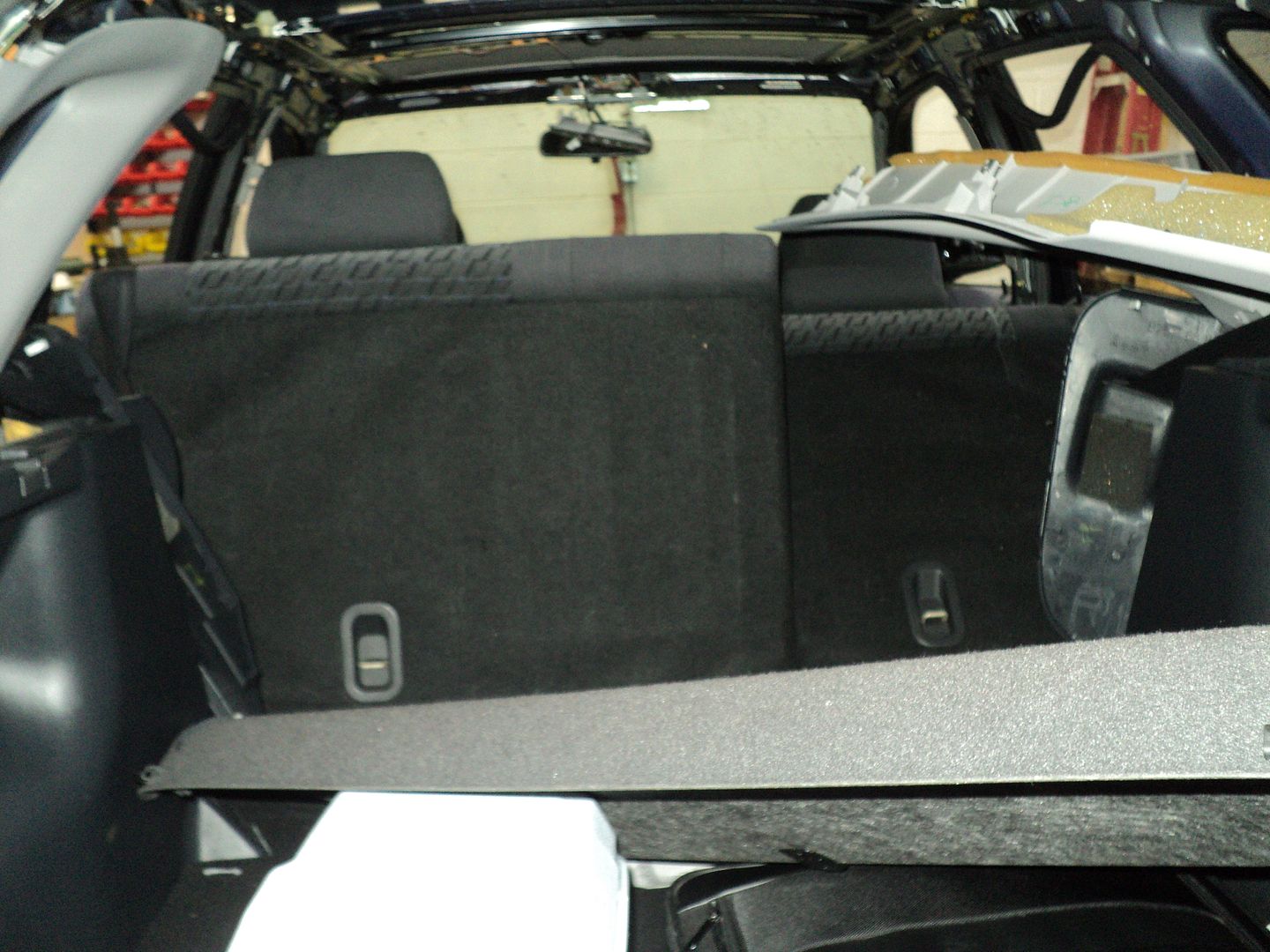

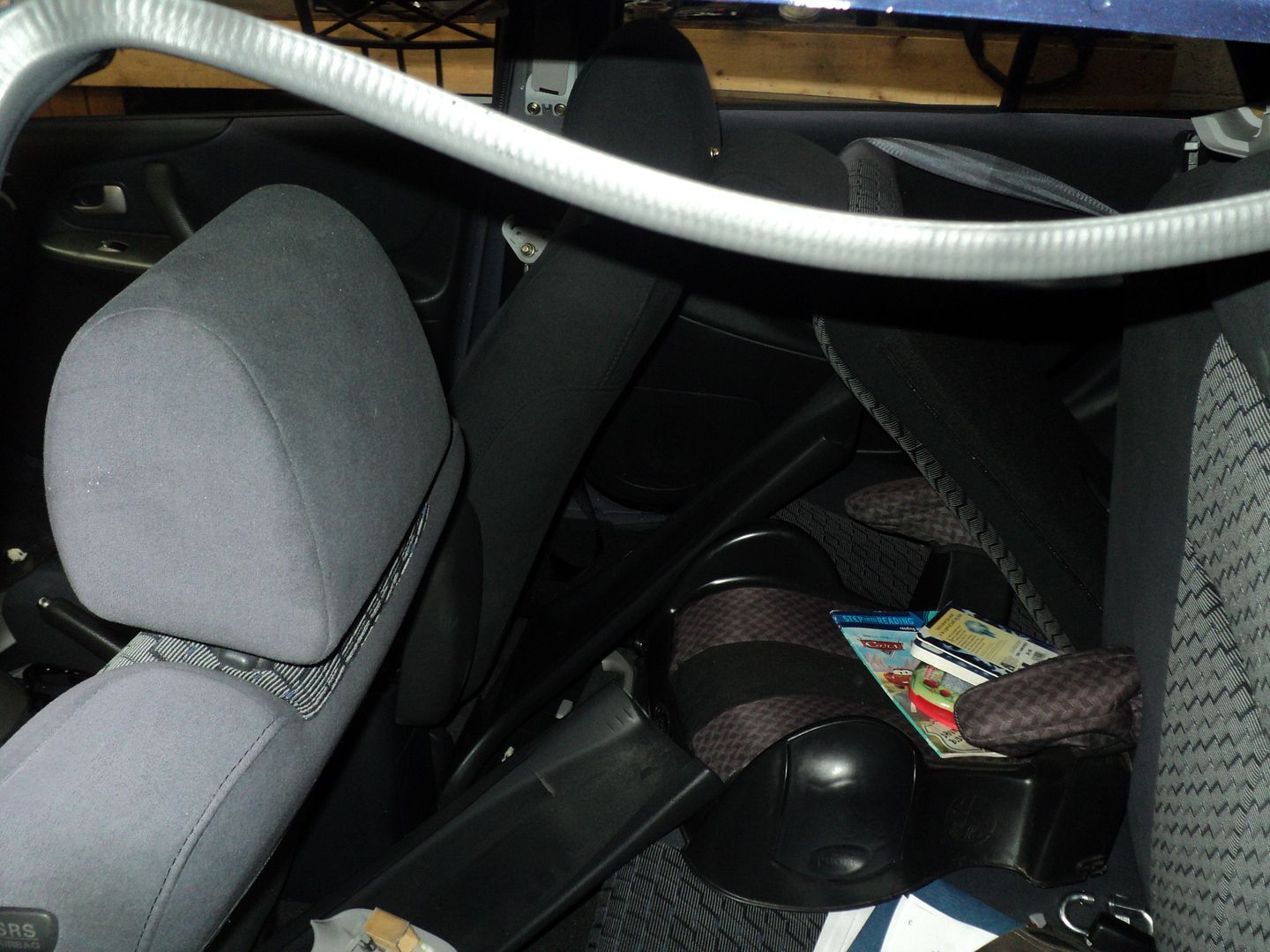

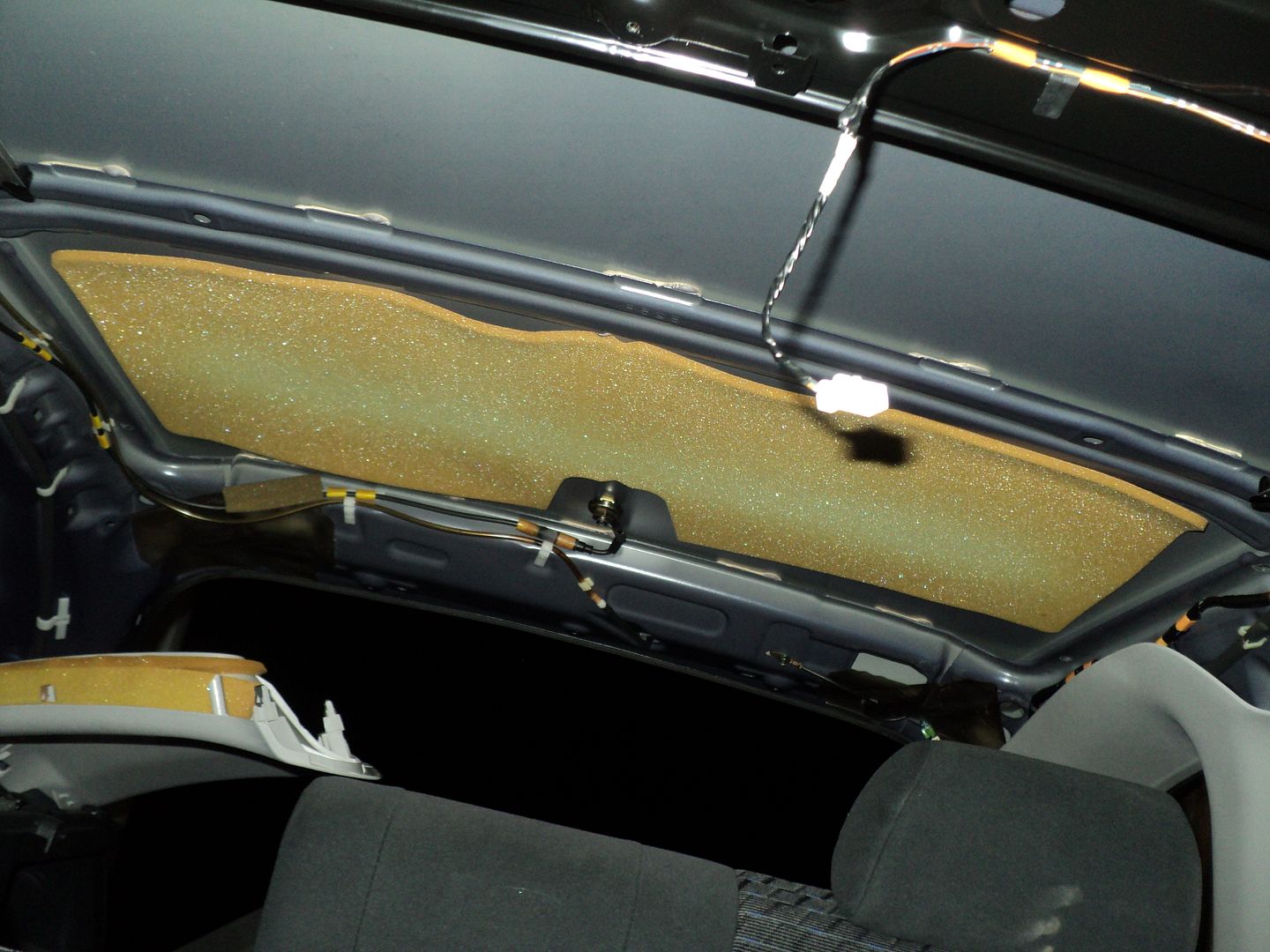

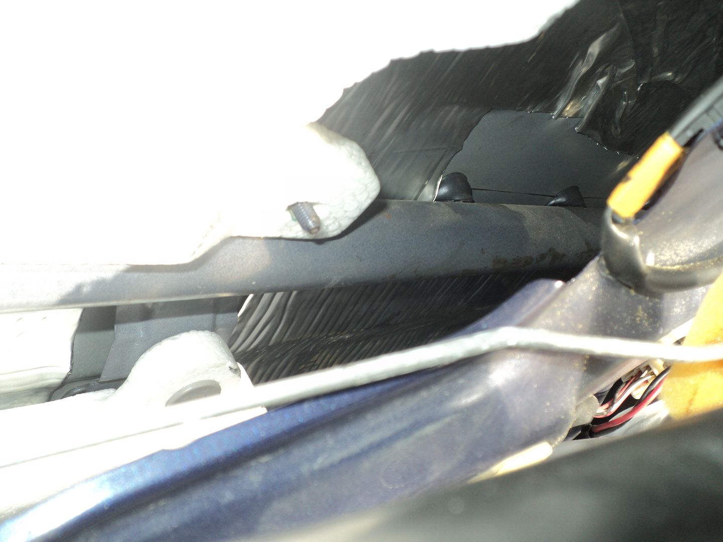

while I was in there, I decided to try something I had been reading about on the forums for a while and was skeptical of. guys have been using the aluminum backed peel and seal from Lowes for sound deadening. I have my products that I already use and really like, but figured id give this stuff a try before condemning it. so I did my rear doors.
the outer panels have TONS of flex in them, and are very tinny sounding. when the door shuts, you could also hear the radio, at moderate volume, from outside the car just as well as you can from inside. this was unacceptable, as well as the sound the doors made when shutting. figured I had nothing to lose by experimenting with a new product here. went to Lowes, and picked up a roll.
to get resonance out of the doors rear doors, I had to do a 125% surface area coverage. this is dramatically more material than what I am used to, as my normal stuff would do it with a 60-75% coverage. the peel and seal is also more flexible without a heat gun, and adheres better out of the box at room temp than my usual stuff, but is harder to work as it does not stretch at all. finally, it is also only about 1/4 the thickness and weight of my usual deadener. it did do the job, though, and I have added this to my arsenal for specific uses. such as areas with little clearance, flatter areas, or areas that would be remarkably difficult to access with heat gun/j roller combo.
the rear doors, when completed, have a much higher quality sound hen shut, and the road noise reduction was noticeable, as well as the music outside the car problem. the speakers (free!) suck, however, and need to go away.

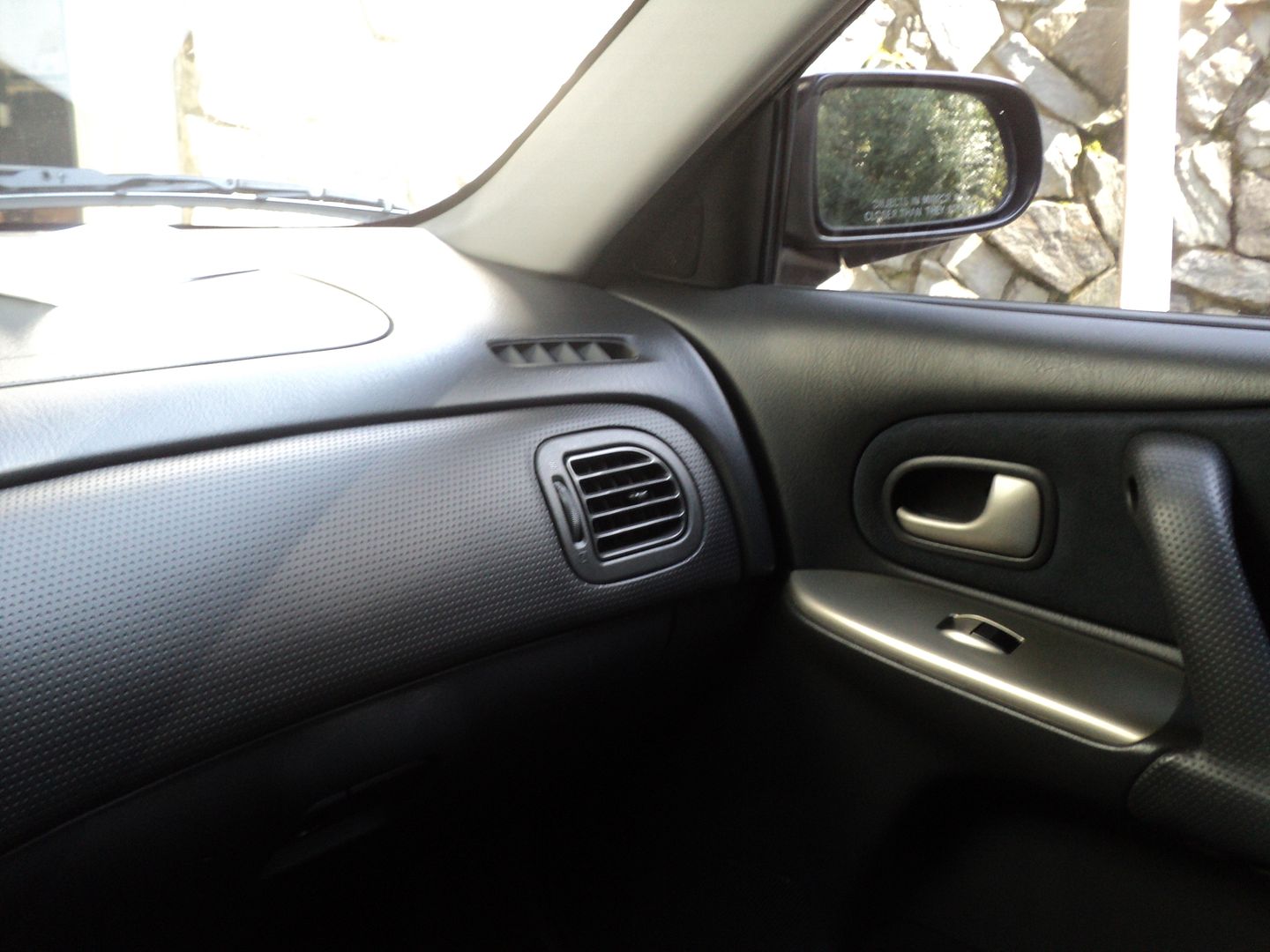

I also managed to nab a pair of sail panel tweeters to bring my front soundstage up (see the 6 speaker option it didnt have?? it does now!) and I installed those yesterday, as well as finished up the door sound deadening project with peel and seal. in total, for acceptable results with it, I had to use 2 rolls in 4 doors and the inside of the hatch.
sound 100% better now, crappy speakers and all. the stereo is not done, however, as I want to do the rest of the car with sound deadening/insulation, as well as replace all door speakers with infinity reference series speakers (always wanted a set). additionally, I have plans to build a small fiberglass enclosure in the hatch to house a single 8 inch sub.

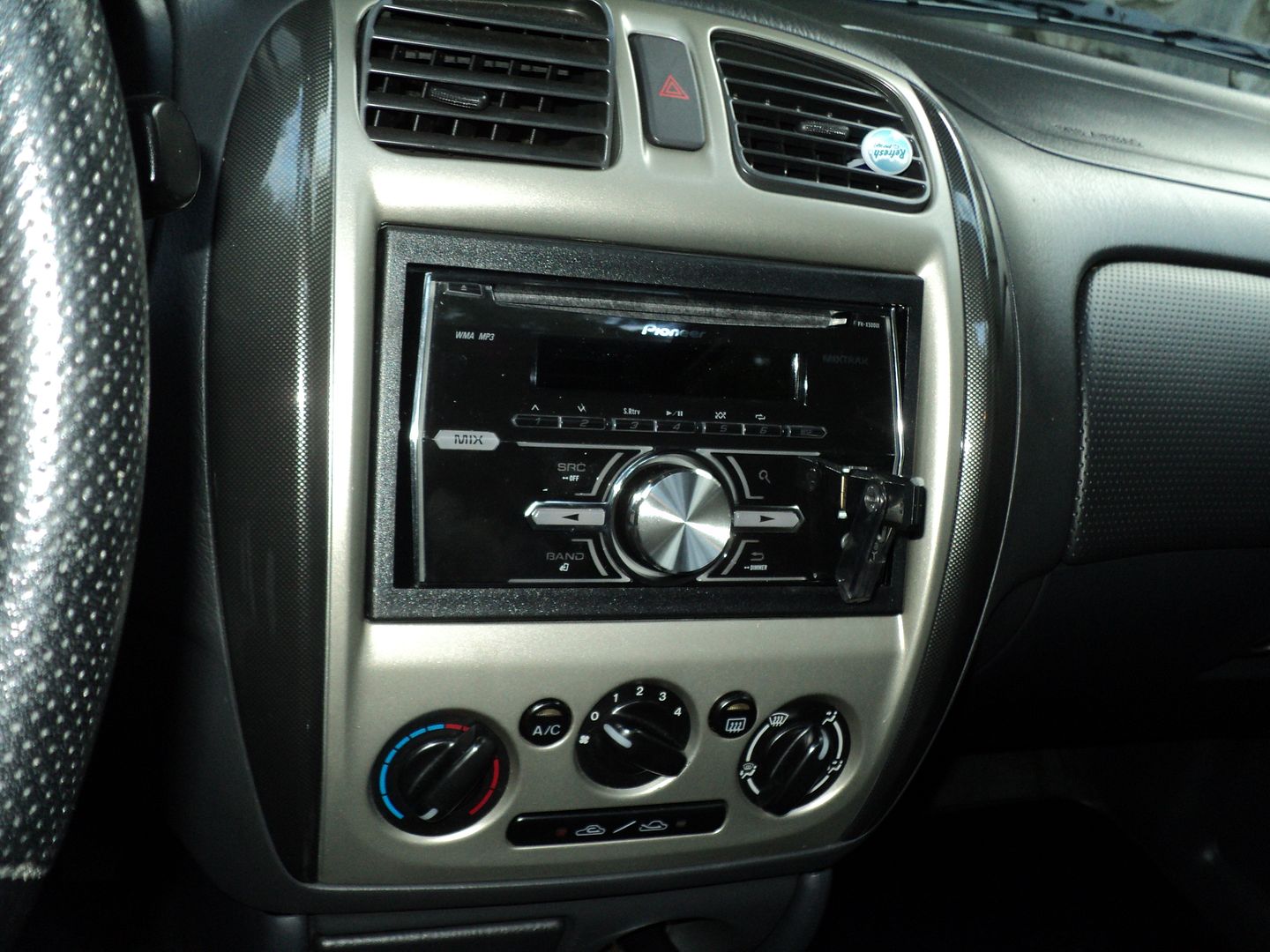

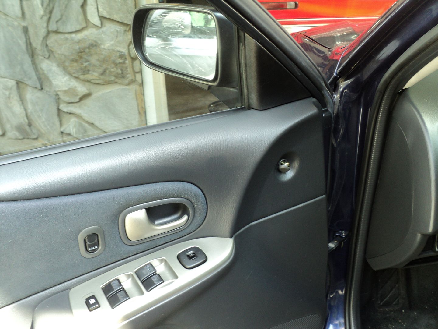

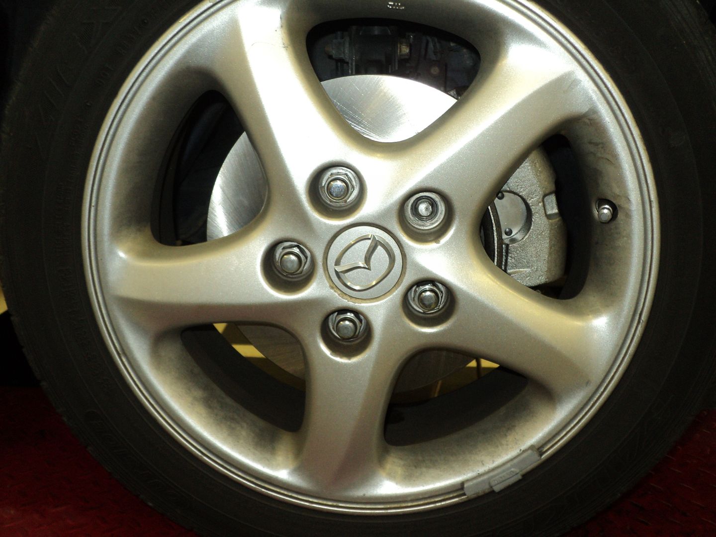

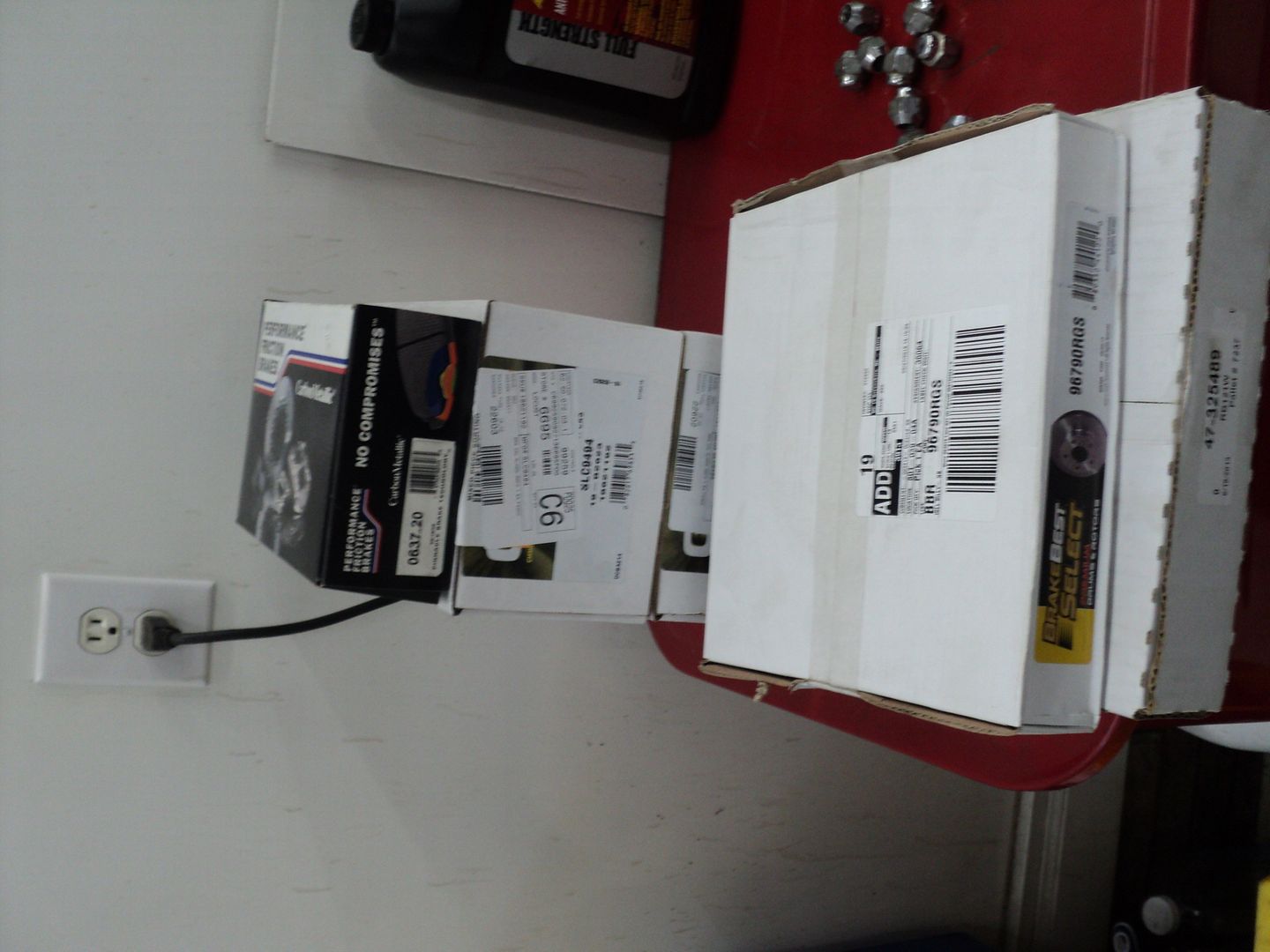

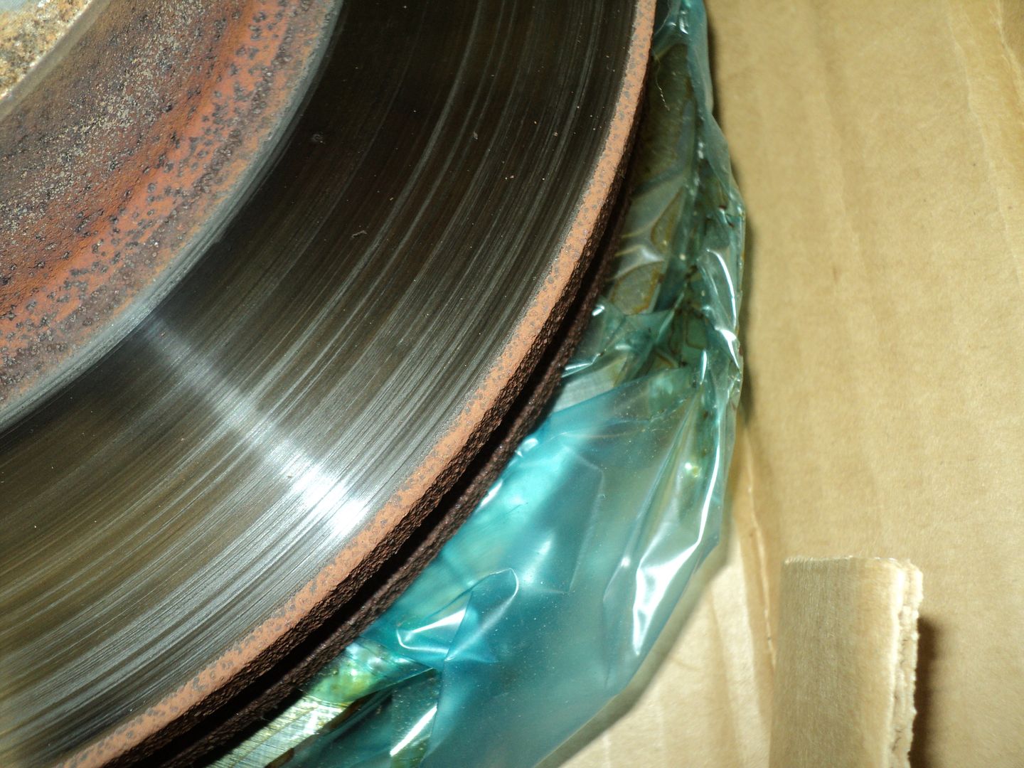

up next is my complex solution to a simple locked up brake caliper: BIG BRAKES!!
the right front caliper took a dump on me. I had thought the brakes felt a little funny when I bought it, but chalked that up to crappy pads/old fluid. I as wrong on that count. no one had ever greased the sliders. couldnt get them to budge with a 3lb hammer. so I knew I was in it for calipers and pads as well as a rotor turning. for not much more money, I did the following:
I use performance friction pads on every street car I have that they're available for, not only are they made in south carolina, they have great initial bite and low dust. I love them. little more expensive, but worth it. the calipers and rotors are 2000 Mazda 626 v6 parts. same as the mazdaspeed protg brakes. the rotors are about an inch bigger, the pads probably have 30% more contact area, and the calipers are much beefier. it also all bolts on like stock. once bled, and bedded, the increase in brake performance is dramatic.
I still need to do the rears, but they're not giving me any trouble at the moment, so why mess with them?
