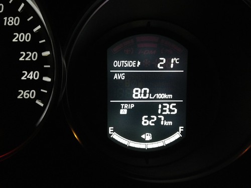

I stumbled across this when looking at photos of my display.
Look carefully at:
http://www.flickr.com/photos/glennstewart/7050616983/in/photostream
You'll notice the i-DM feature exists in the display. This feature is available in Japanese spec cars only and provides signals to the driver to aid smooth driving:
http://www.cx-5.mazda.co.jp/driving/idm.html
I thought at first the Mazda was saving money by just including the same display in all cars, but then thought this couldn't be possible. The Japanese display is VERY different because it displays Japanese. Because the character sets of hiragana, katakana and kanjii are so complex, the Japanese display is simply a matrix of pixels.
Our roman alphabet and symbols don't require this complexity, so we get the simple digital clock style LED setup (clearly seen in photo)
I suspect that the US displays are exactly the same as mine. Anyone able to check and confirm.

Interesting, I'll take a look at this tonight. I can't seem to see this right now but it may be due to glare.

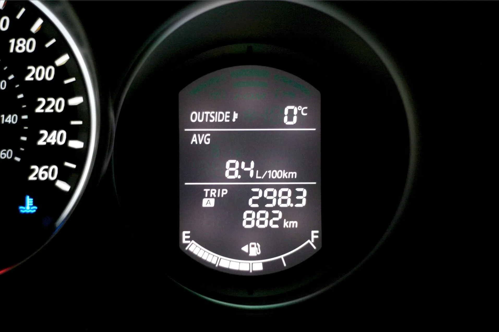

Seems like I have the same display in mine. Picture ain't that good unfortunately, but you can see the i-DM portion.
If the displays between Japan (because of complex characters) and rest of world differ, then I still can't see why it would be there unless it could be turned on by software.

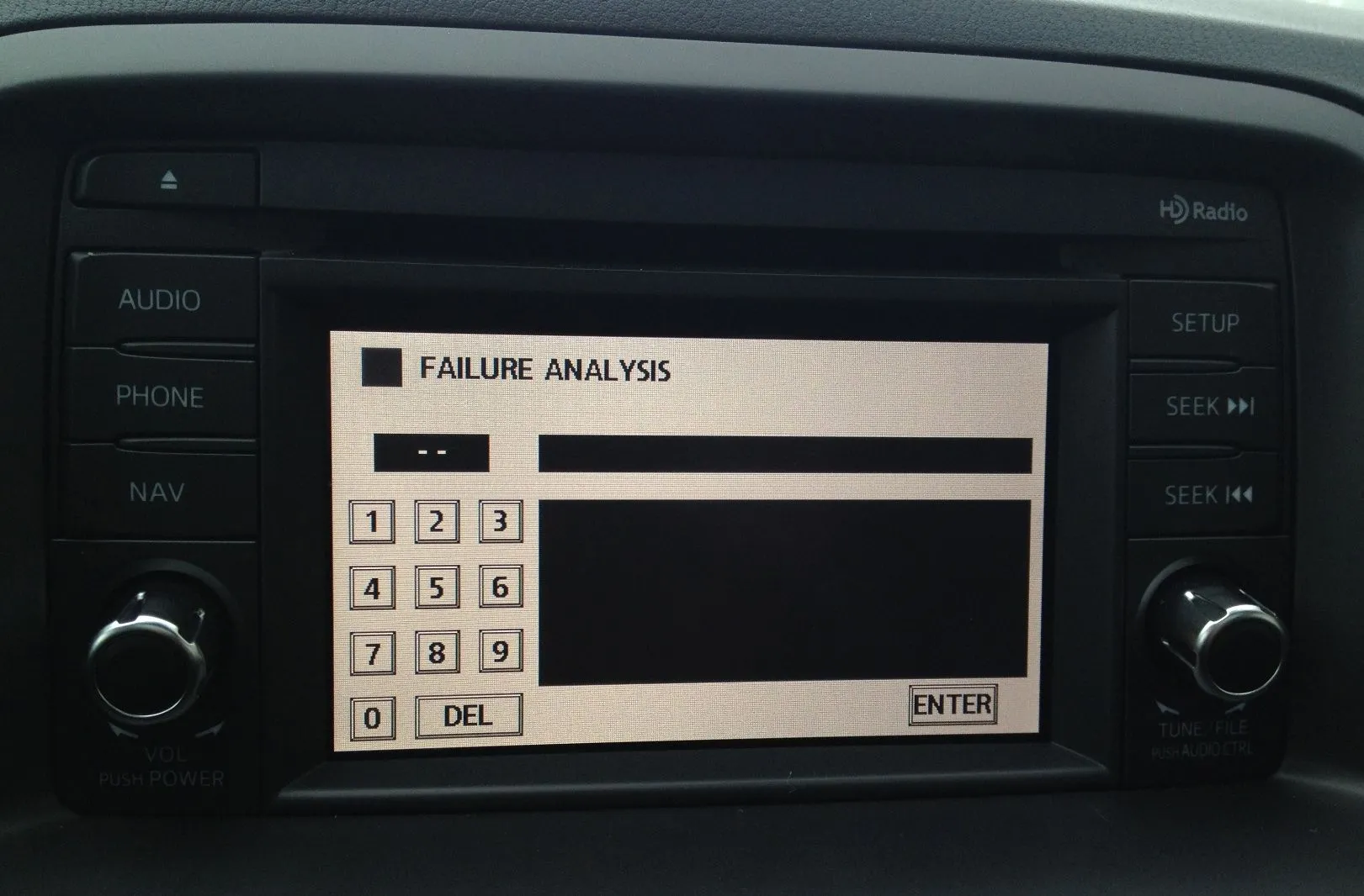

I wonder if there is more hidden functions like this that my indicate if i-DM or anything else can be enabled by software. This one seems to be for diagnostics only though. Accessible by holding the volume/power button and pressing seek forward as documented in the navigation install document.

Thanks VK. I wonder if there are any other settings you can get to this way.

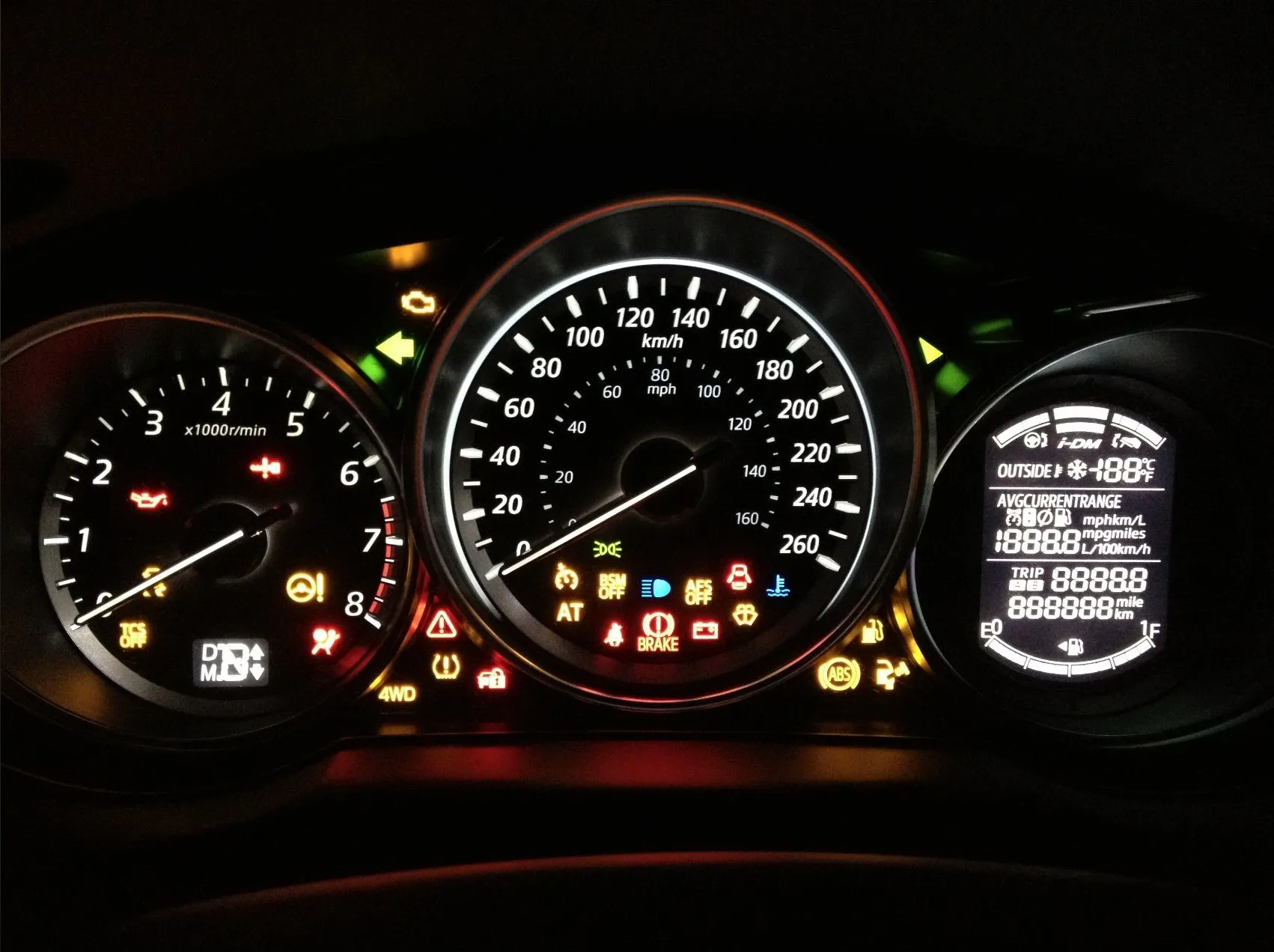

Sorry to dig up a somewhat old thread but I just tried instrument cluster test mode on my CX-5, and it seems to be working just like it was on my Mazda 3. However, with this we can clearly see the "i-DM" portion of the display, but still no ways to activate it so far.
attachment.php
For those that would like to try test mode, hold the trip button then turn into accessory mode while still holding the trip button, when it says "Test" in the cluster display you can release the trip button. Pressing the trip button will cycles through the various test modes available.
