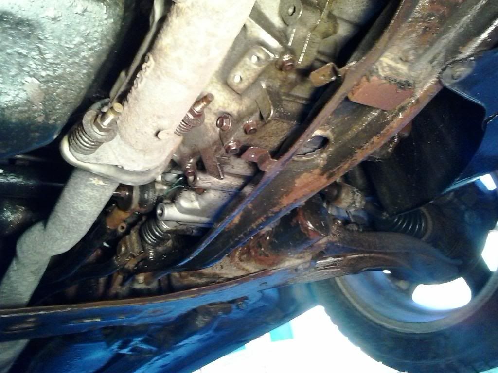

I got a new camera (cell phone). I think this is better:

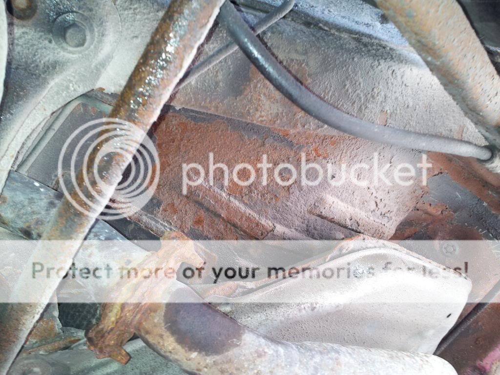

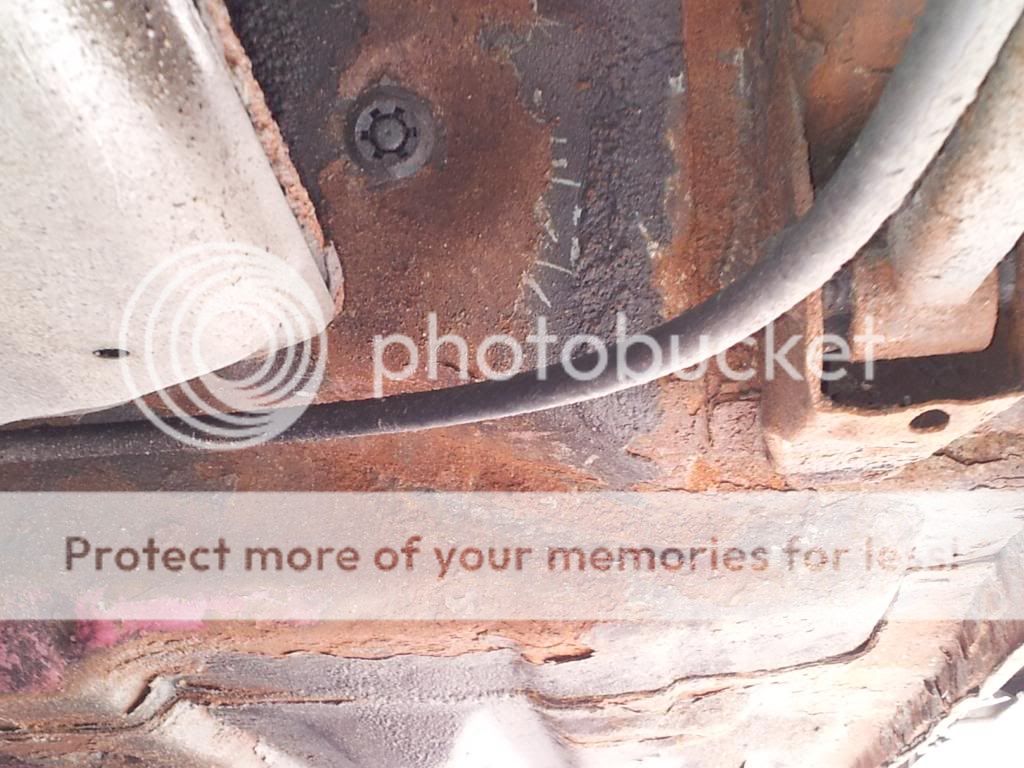

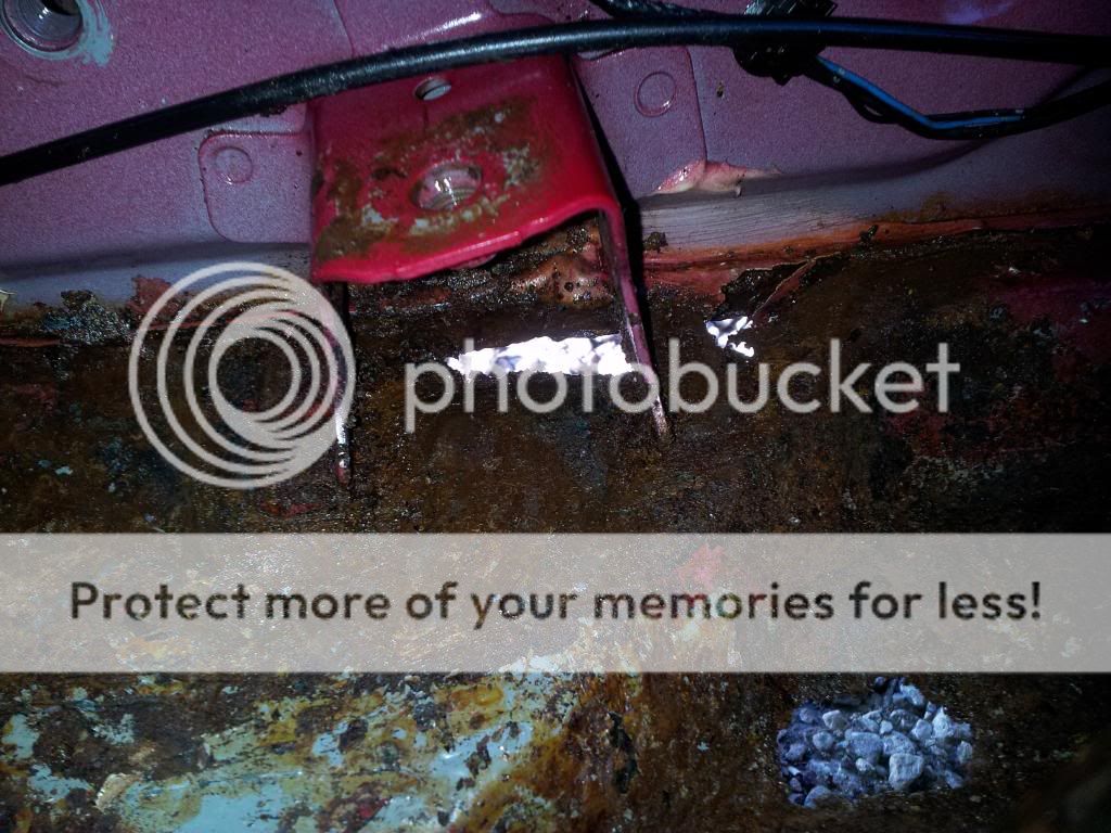

This is part of what I'm up against: (that spot had little holes in it,... so didn't last)

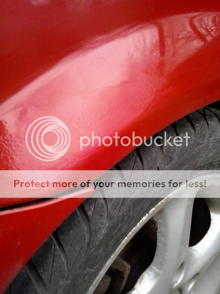

This is an example of my painting skills from last year (lots to be desired but the rust didn't come back !!)

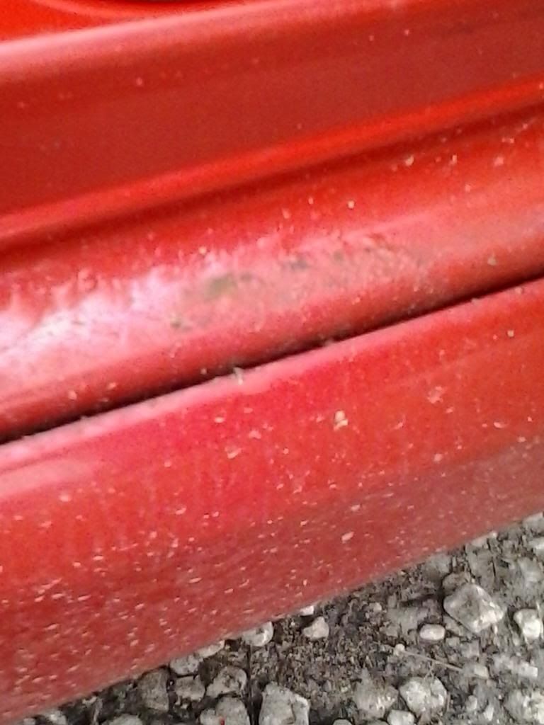

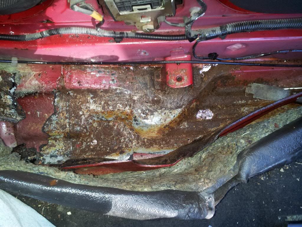

This is a spot I forgot to do last year: (tailgate)

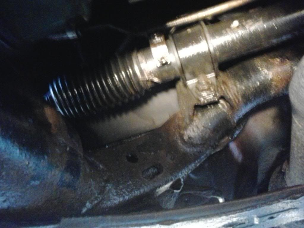

Well,... I took some pictures of my underside and it still looks pretty wet with oil.
I may be putting off my undercoating for a few months to let it dry up a bit.

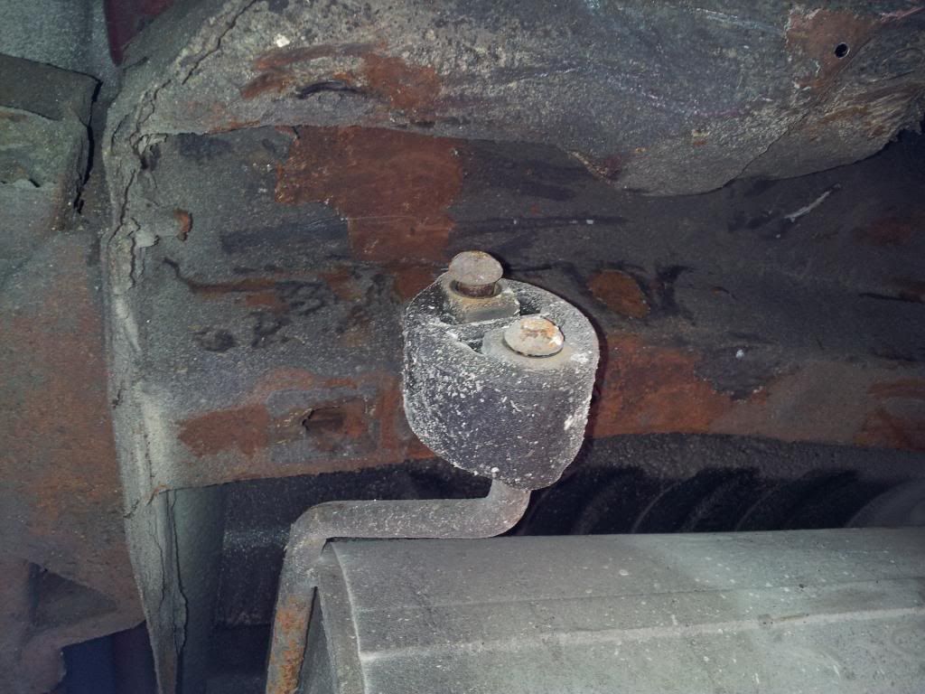

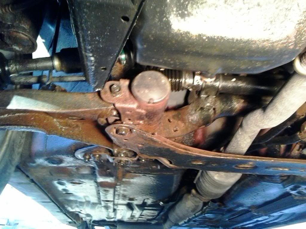

My most recent oil undercoating was Krown (the stuff in the pictures,.. two days after spraying). Last fall, I used a few cans of Rust Cure, but by last month, before going to Krown, it was looking pretty dry.

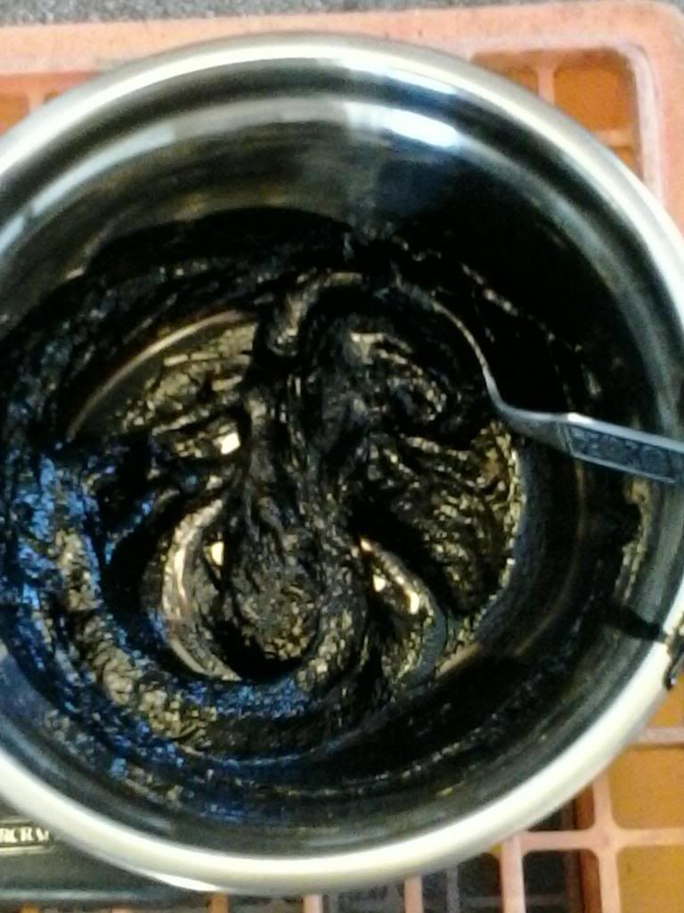

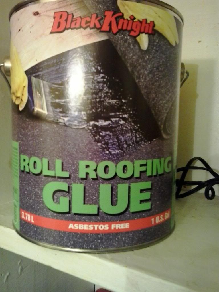

I finally got around to making a test batch of undercoating using four big tablespoons of both the high pressure grease and roofing tar (roll roofing glue actually which I only bought because it was the cheapest,... I think it's a bit thinner than regular tar) then I put it in a steel bowl and cooked it on the stove till it blended nicely.

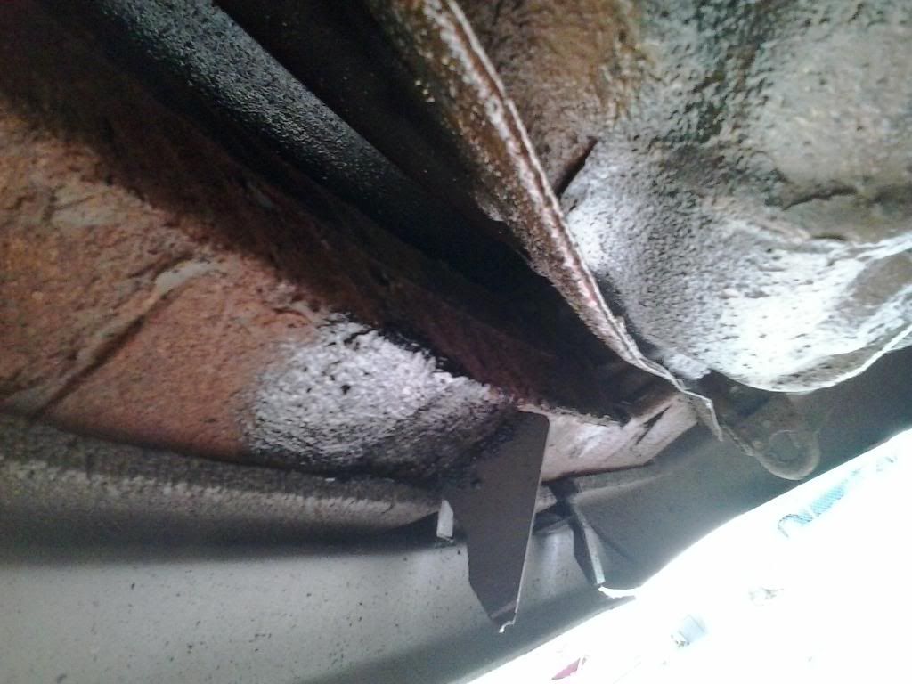

Then I went out to look for a spot on the car to try it,... I found the backside of the rear bumper was really nasty with big flat chunks of metal flaking off so I spread some around there. The Krown spray had soaked in pretty good because it was so porous. It went on great and because it was still almost hot , it was quite thin and spreadable. It was kinda like a gel.
Then just for the heck of it I tried some on the spare tire molding under the car that is in pretty good shape and still dripping with Krown spray and I was quite happy to find that it all blended together awesome. No oil and water kinda thing,... I guess oil, grease and tar blend easily. The mixture thinned out a bit more because of all the Krown spray, but overall I'm really excited about how it's working.
Starting with a surface that is soaked with oil is fine and that's good because you can spray it down with probably anything like Krown, Rust Cure or Fluid Film,.. let it soak into the cracks and crevices for a couple of days then put on this top coat without worrying about dry spots or sealing in moisture. It's super cheap too,.. the roofing glue was $12 for a gallon and the tube of grease (which I have cut down to about half size so I can scoop it out) was less than $3. So I don't mind whipping up piles of this stuff and caking my car with it.
I do have to save some tar for my actual roof which is in the process of being replaced (I'm doing it myself cause I'm a cheap ass,.. $750 instead of the $2,800 quote I was given.)
I just went out to check the condition of the remaining mixture in the bowl in the garage and it has stiffened up quite a bit and isn't as sticky,... I'm thinking that is good too because it won't be as messy if I rub up against it and won't rub off as easily.
I supposed the only real test is time itself. I wonder what this coating will be like in a few years,... I really don't think it's gonna dry up, crack and let in moisture like the factory undercoating did.
I'm thinking my spray at Krown next year might soak in to the mixture and soften it up if it's hardening ??

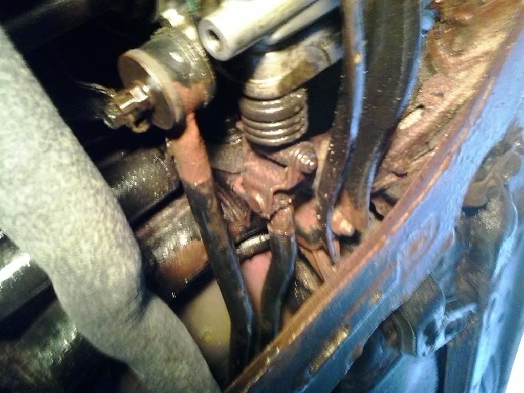

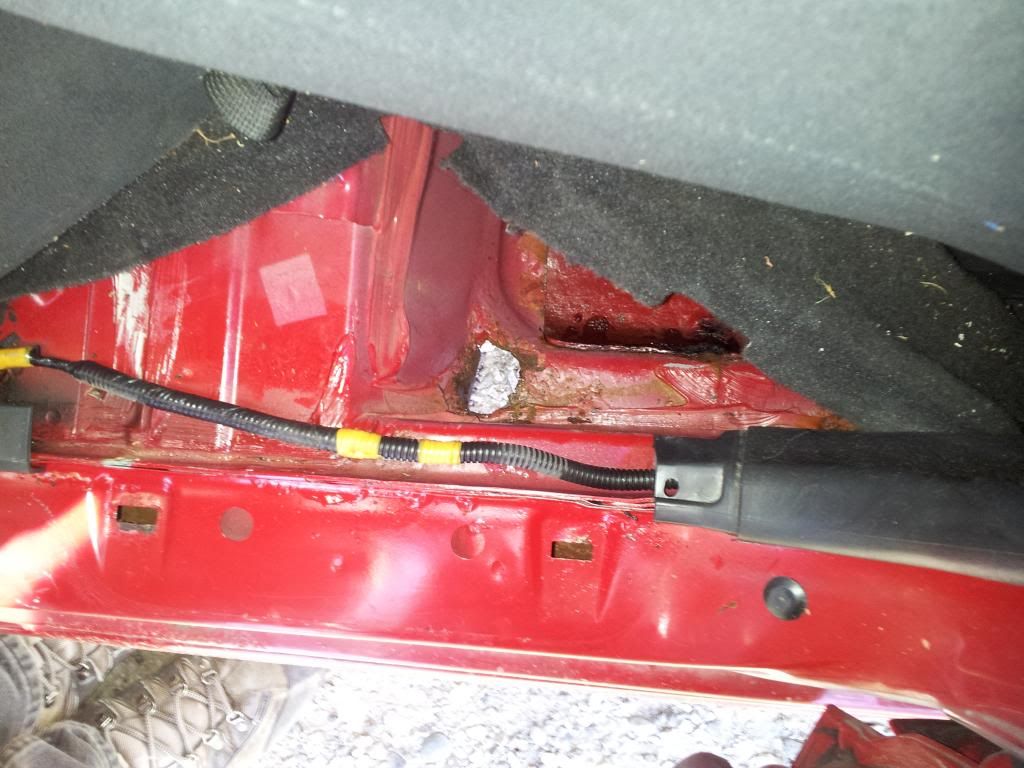

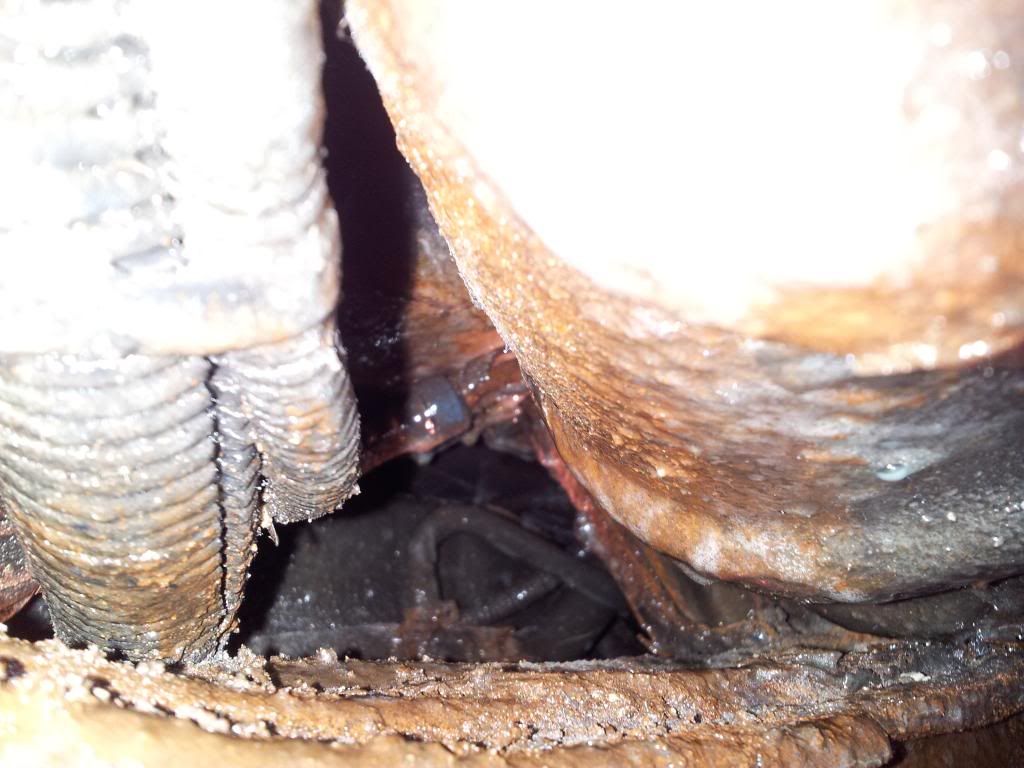

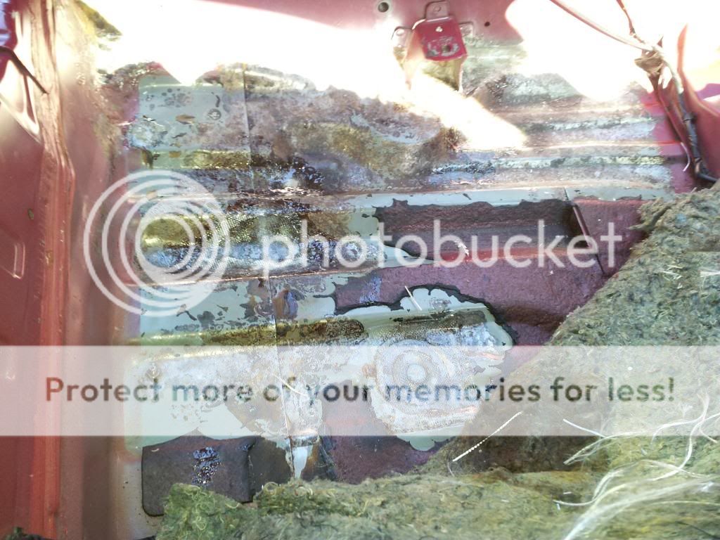

So I finally crawled under my car to attack the rust before winter kicks in.
What a fricken mess...

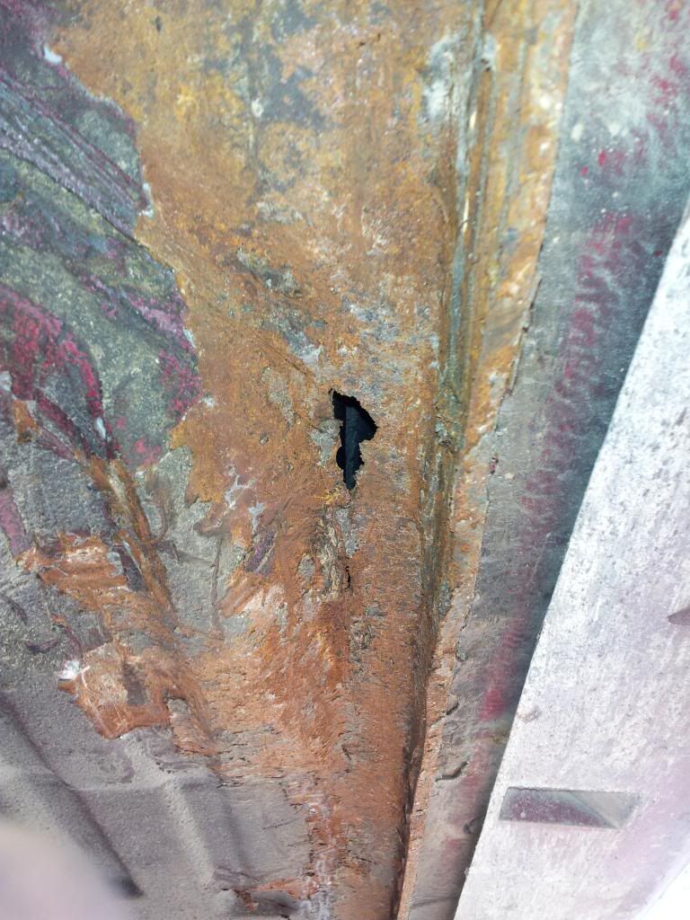

That's a hole through the frame rail.

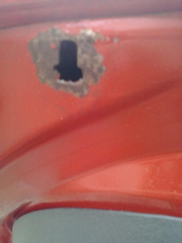

That's a hole right through to the carpet in the rear right passenger footwell.
These are some gas vent lines rusting all to hell. They're hidden up under the gas tank.
This is after I hosed them down with undercoating spray.

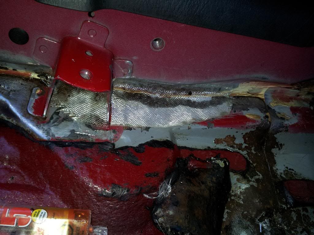

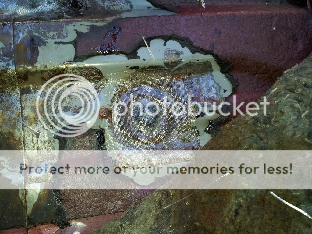

That's the hole through the floorboard. (the gravel driveway is showing through the hole).

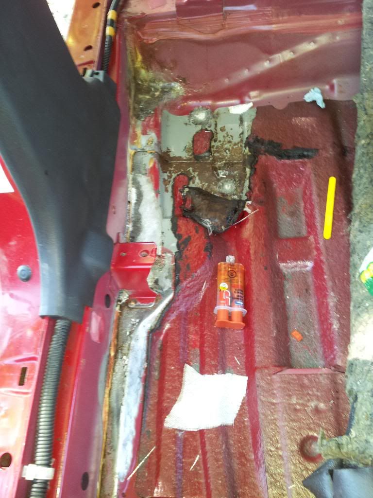

This is after I patched the hole with some 5 minute epoxy and some pieces of fiberglass weave,... took 20 minutes,... real easy.
