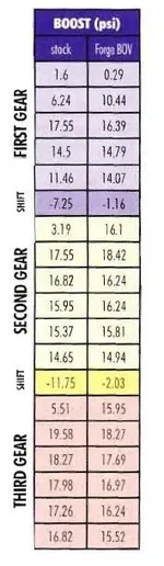

I will say that I agree that when properly adjusted the Forge will be more "lively" in that it recovers faster under light load or low rpm conditions, but it is also less smooth in its release and recovery and can be very difficult to adjust and readjust when ambient conditions change.
I prefer the smoothness of the stock part as a daily driver, and have no problem with the responsiveness on the dragstrip or in other competition situations because I flat shift then and recovery is essentially instantaneous when you stay in the throttle, allowing you to stay on boost.
But if you like the more "lively" response of the Forge, there may be a slight price to pay for it in absolutel performance -- in testing it actually did not hold boost quite as well in the power band in upper gears as the stock unit.
Attached is the chart from the Grassroots Motor Sports Magazine article where the two were tested side-by-side on their MS3.
Notice how the Forge recovers quicker in the low rpm part of the upshift than the stock BPV, but also notice that once you get in third gear the stock bpv holds boost at least a full psi higher, sometimes as much as 1.5 psi higher. I'll flatshift and take the higher boost.
Each has benefits and each has its disadvantages.
Do you have the link to the article? I'd love to know what spring they used and what other mods were done. If the spring is too weak the pressure against the piston can force it back, causing the leak. The type two is oriented 90 degrees, so this cannot happen. The air would have to blow by the seals.
The article has to be purchased. It's a subscription service. I did post the chart, which is all I felt comfortable doing without getting into trouble with them for copyright violation, etc.
