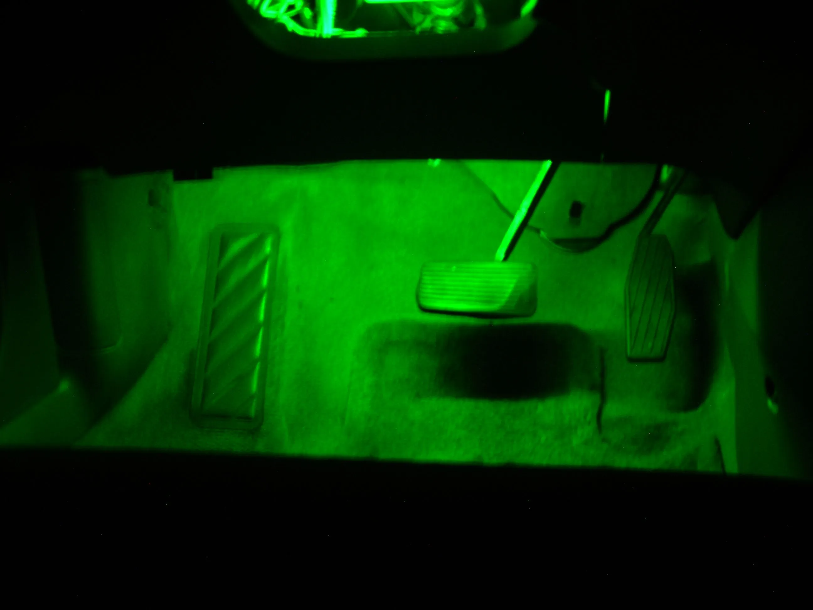

finally got pics.
finally got the pics of the lights on. looks awesome. thanks for everyone who helped me out.

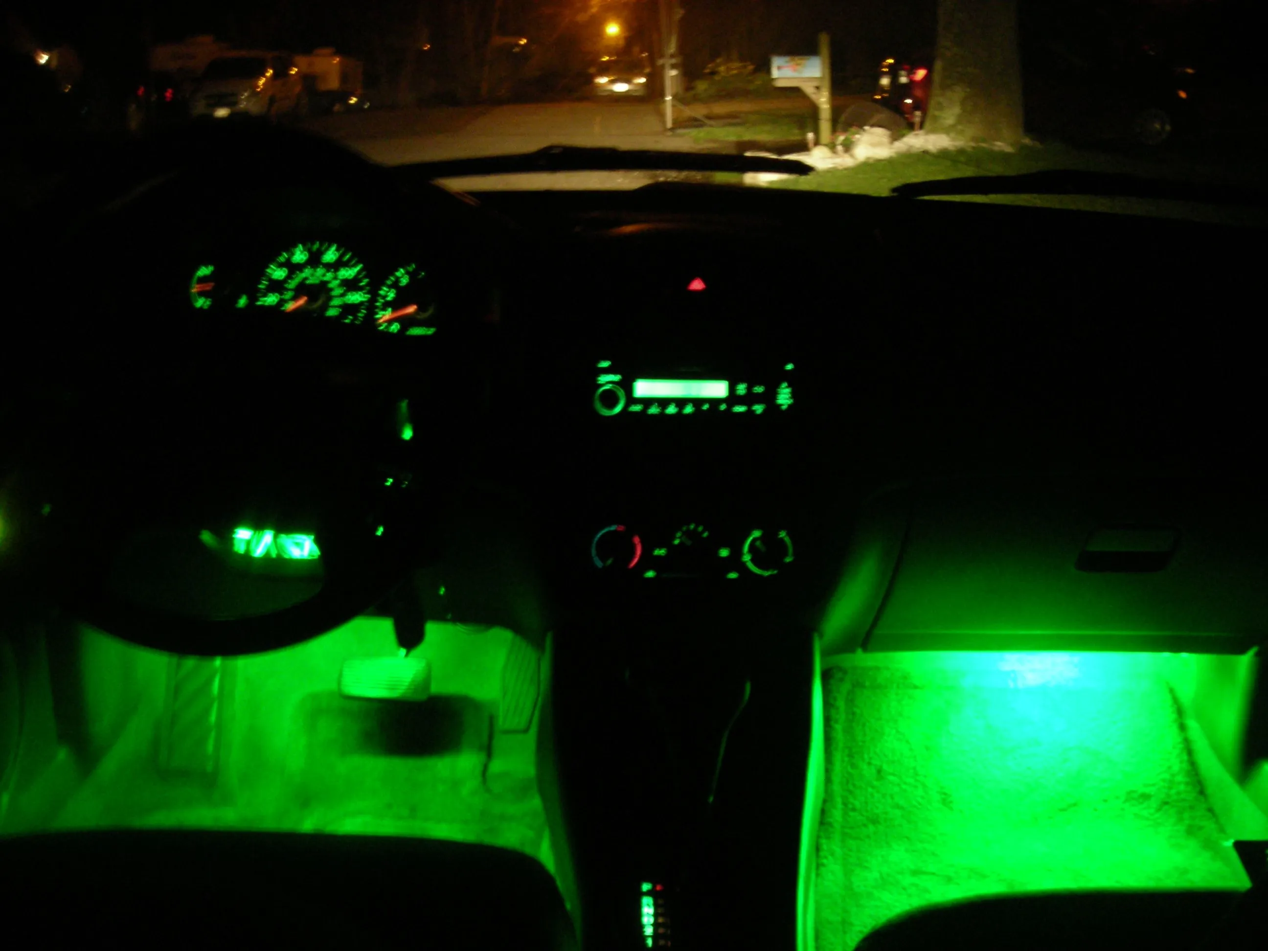

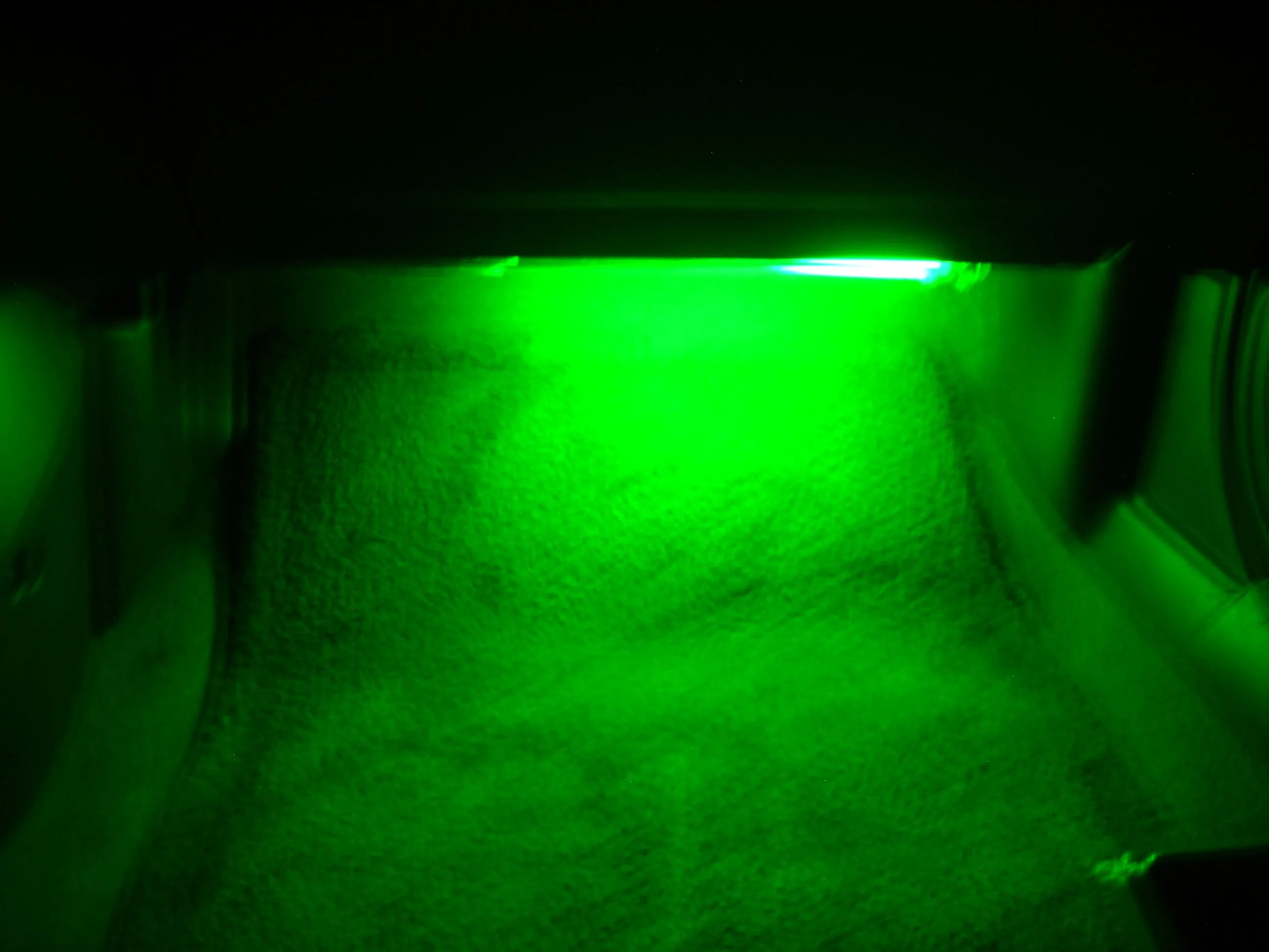

how did u do that, cause thats a good idea. obviously its not the same thing for my car, but similar.
its an 86 mitsubishi mighty max. you use the ground wire, just make sure its a big enough guage for how many neons you use. when the door opens, the ground is connected, completing the circuit. i dont know of the newer cars, ive got a msp but havent looked if its the same.
