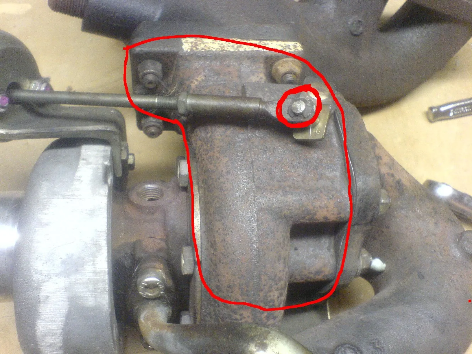

okay so my clip was rusted to oblivion and shattered when taking it off....is there a replacement clip? THe clip that holds the end of the actuator on to the lever, its circled in red on the pic...

taking off the clip is like a 2 minute job...now..puting a new one in..that's the problem
i just used some twisted wire to hold the wga actuator arm to the wastegate....that has seemed to be the trick and its been good for the past year, i even used the same piece of wire for two weastegate replacements on my car
does anyone know where i can get a new clip i tried auto parts and autozone but they have no clips that are 5/16"
bump... is it bad to drive without the clip? i havent been able to find the 5/16" one
I used a hairpin style clip for mine and it worked perfectly (discount auto parts) and I used a pair of long needle nose pliers. and you should be good to go from there buddy.
Did it today with a friend, this was a huge pain in the ass, but it got done. don't kid yourself and think its a half hour job. Its not. If you have all the perfect tools it will take a while and be patient to get it done. Don't lose the C clip, be carefull with that little one.

Don't even worry about loosing that stupid clip go buy a pack from autozone for a few bucks and if you dont loose it return it. If you do no big deal just open the pack and save yoruself the headache!!!
I got my the clip off and the front nut but the rear nut isn't moving. i tried a ratchet with the knuckle attachment and a box wrench. neither give me clearance to rotate the nut. I am about to bust out my dremel tool and just grind it off... any suggestions on tool or angle to approach this 2nd rear nut? I walked away from it for today. I will try again tomarrow morning.... i hope i can remove it because putting the new one on seems like it would be a lot easier.
I got that nut off goign from under the car with a long extention and a good old fashion knuckle buster swivel socket.
did you have anything removed from under the car? The only thing i removed was the Hot pipe off the turbo, I never messed with removing the J pipe or anthing like that. I will try again with the long extention. I only had the 3" extention hooked up.
