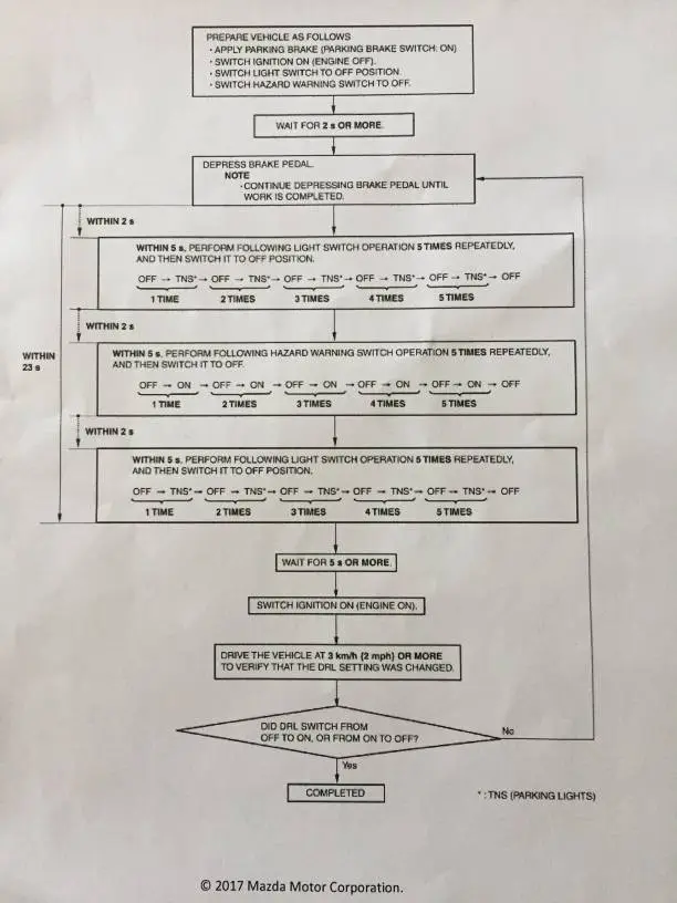

if you disable the so called drl function (there is a funky game-like play with some buttons sequence to disable it) then when the switch is set to off its all lights off. (thats for US). Otherwise even when switch is set to off the drls turn on when the car is moving.

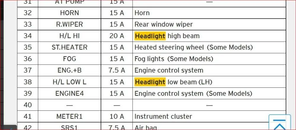

Have you tried FUSES?
Try removing low and high beam both, underhood fuse box.

You’re right (though I did find a jpeg of how, in theory, it can be done (much like how the Hokey Pokey is done. Someone’s Mazda tech couldn’t get it to work… but the service Mgr could. No thanks, Mazda)
I have a 2021. The DRLs/headlights turn on as soon as the car is moving faster than 1-2 mph. If I stop and turn the headlight stock to auto/on, then back to off they will turn off. But as soon as you start moving they turn on again. I'd love to have a way to turn them off completely.
I've done the disable dance. It works, but under pressure it took me a few tries to get it right, pulled aside in the big parking lot line to "Zoo Lights" where the zoo is lit up with Christmas lights (not my idea to attend).

I re-enabled a day or two later.
