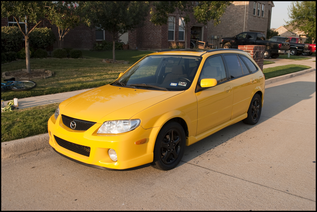

A picture of finished car...
and yes believe it or not, I wasted tons of money on the wingswest bumper to get rid of the ugly orange sidemarker on it (that and to have bigger foglights than my friend's subaru! :D )

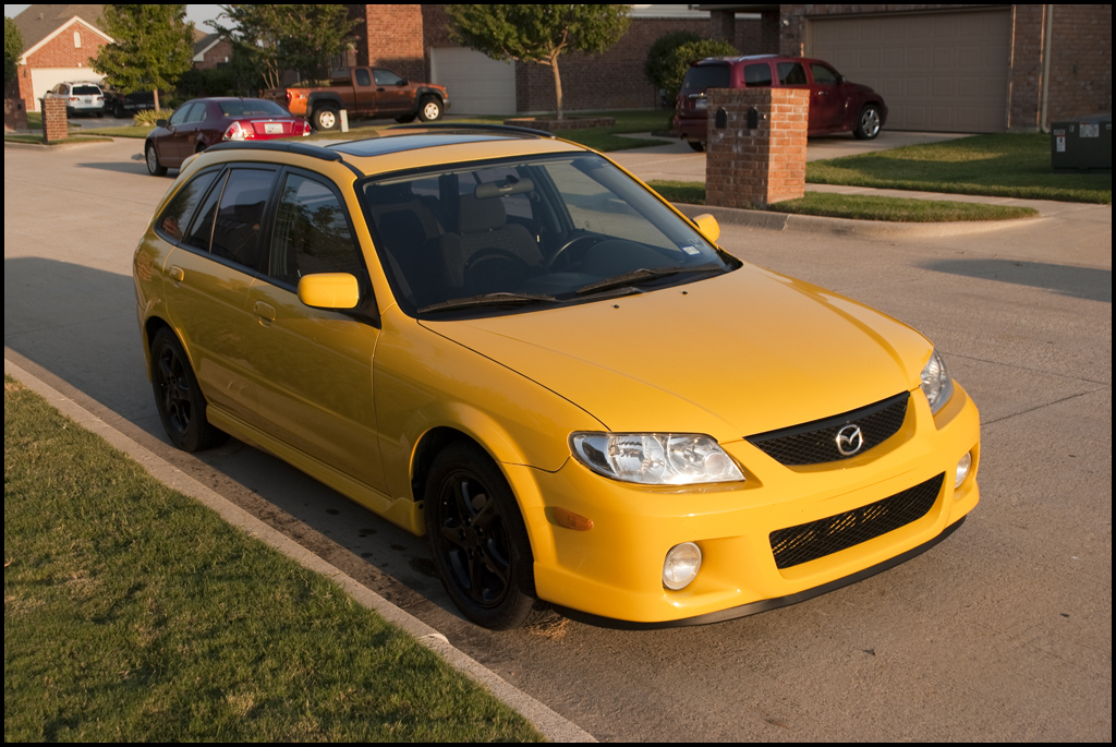

so i just finished one side:
(yeah... i got a boo-boo there, the tape's there so it won't rust, and so far it's working...i have some touch-up paint i'm getting here so that'll be fixed soon!)
