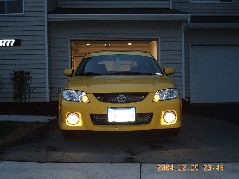

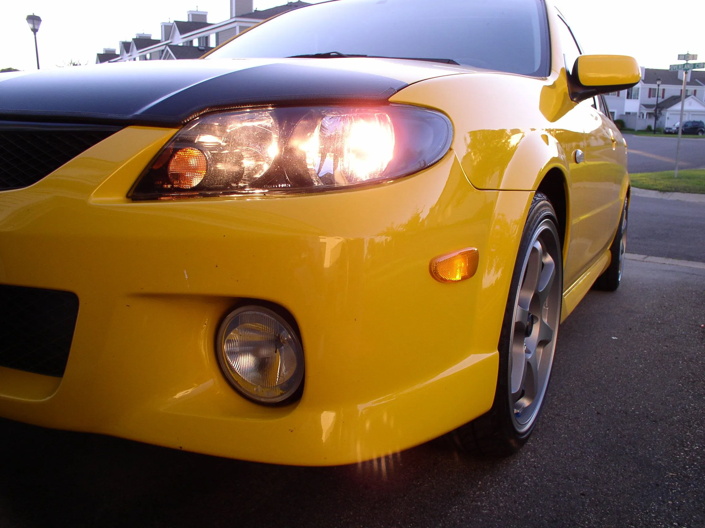

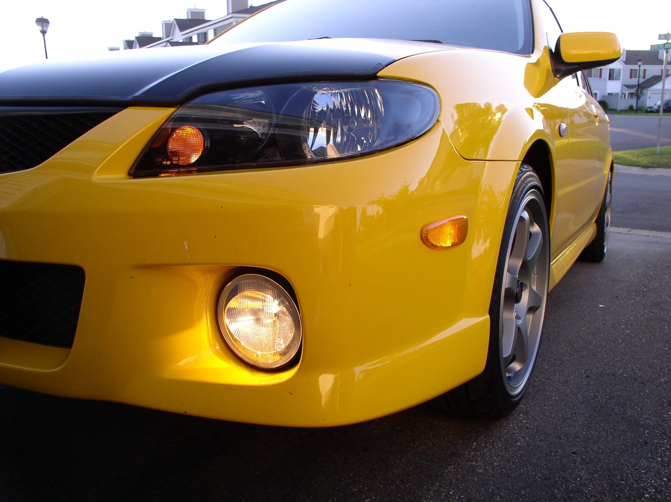

ok here are the pics of my fog light rewire for "On with Parking lights"!!!

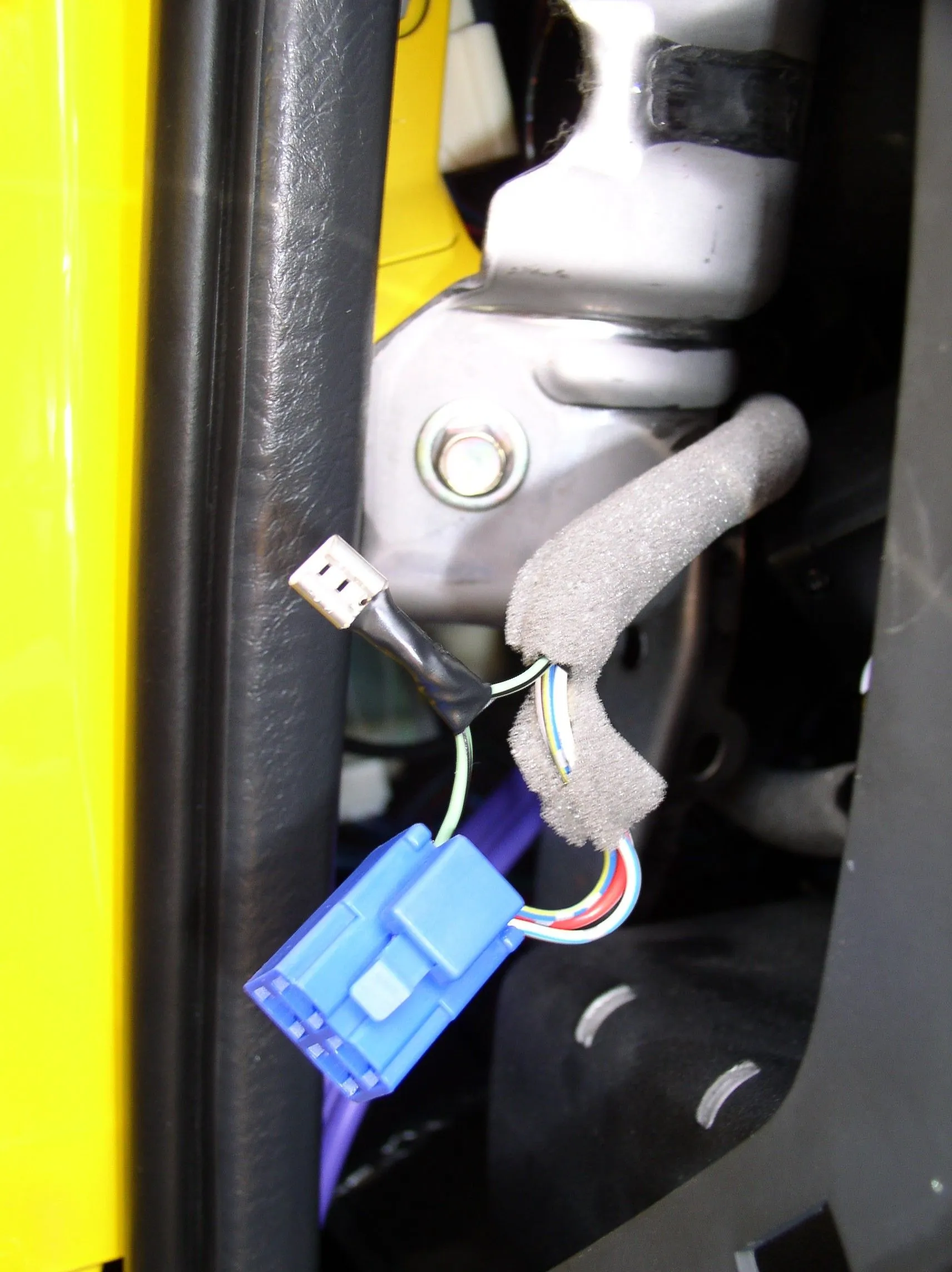

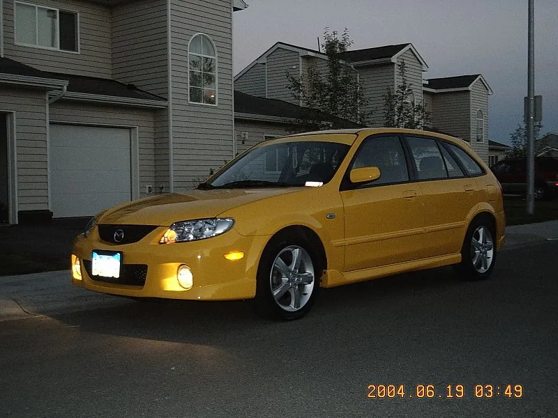

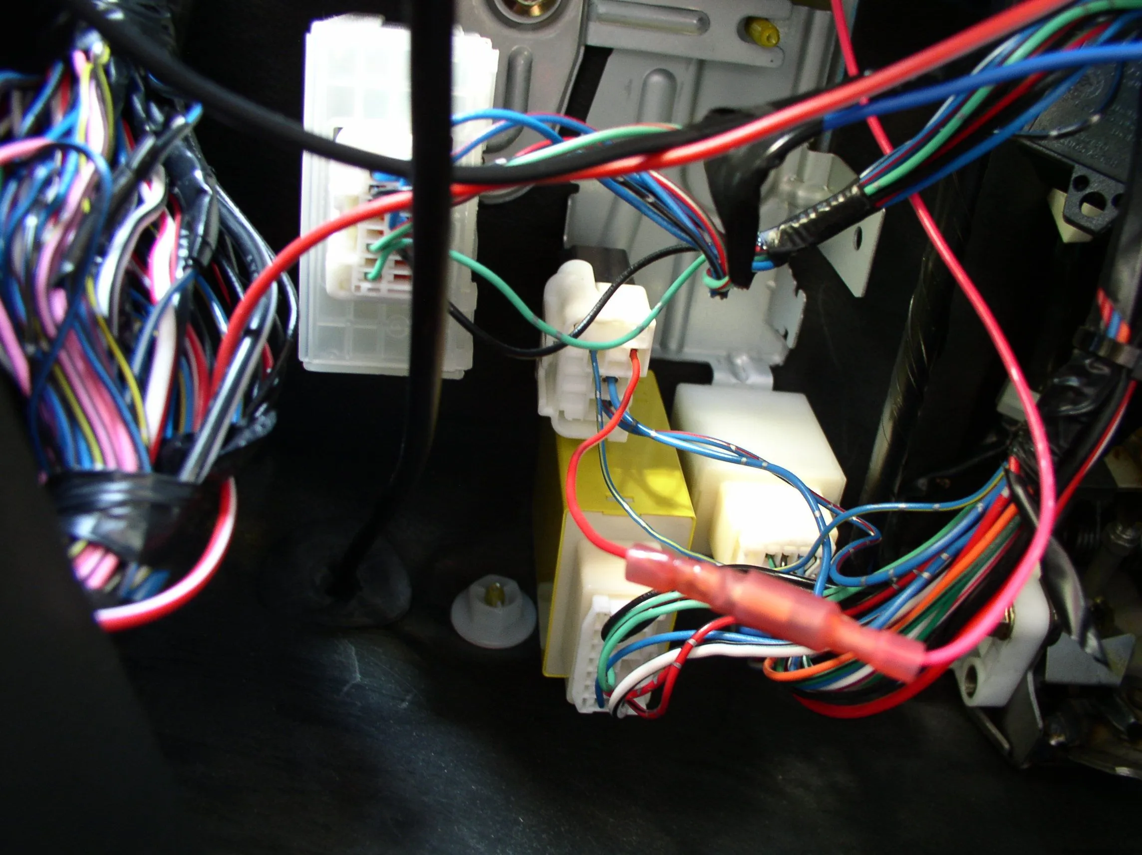

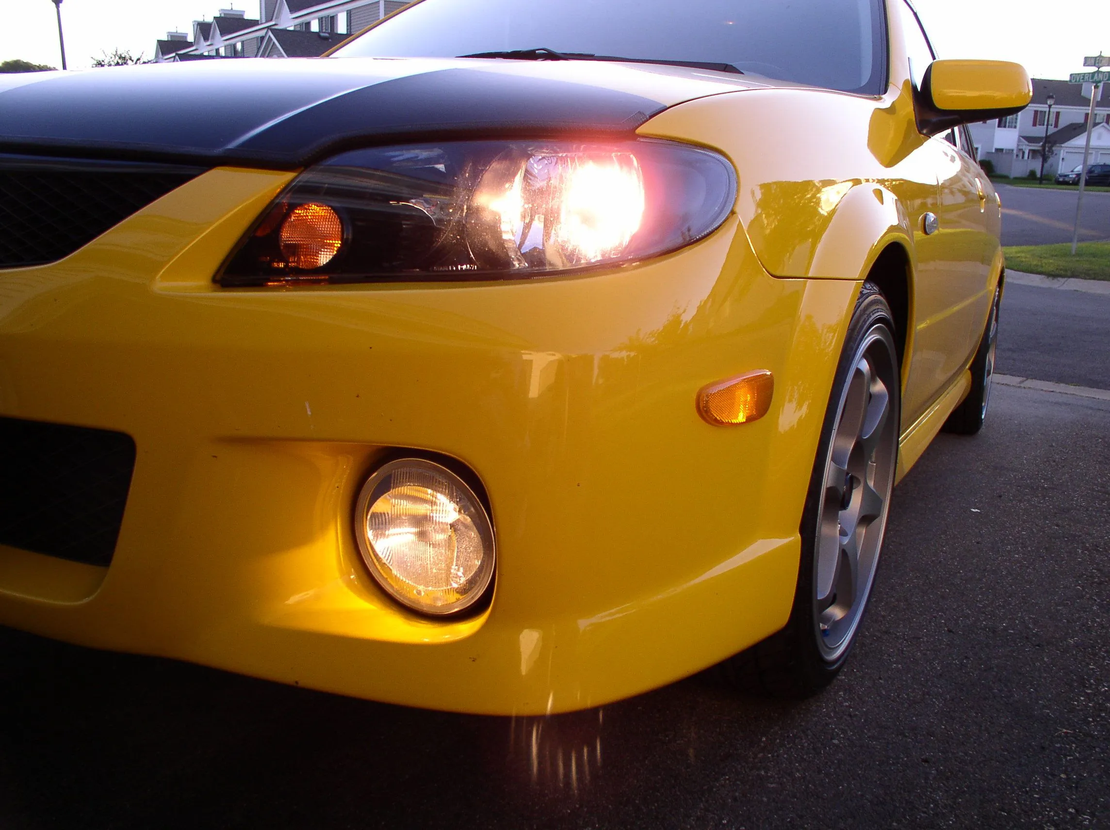

Did this mod today and it is simple and the results are kick ass. I followed the directions on the first page and the results with pics are listed below:
Pic 1: I cut the green/black wire, wound the wires together, and put a female connector on it, soldered it and taped it. I also cut the red wire at the fog relay, taped up the unused loose end, and put a female connector on it.
Pic 2: I took a 10" 18 ga red wire and put male connectors on both ends. Then pluged one end into black/green female connector at the fog switch and then ran it over and plugged the other end into a female connector that I put on the red wire comming off the fog relay. It's that easy :)
Pic 3: Parking lights turned on with the fogs.
Pic 4: Headlights turned on with the fogs.
Pic 5: High beams on without the fogs.
