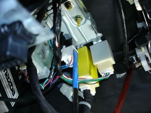

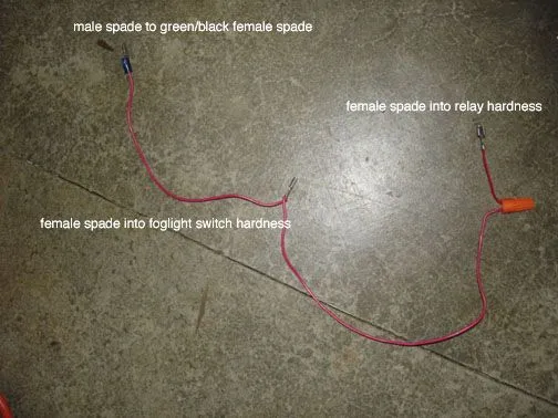

Took some photos that should help those who hasn't done it.
The only thing I did differently was simply cutting the red wire, and use a twist on connector to connect another wire to it, because I didn't have a female spade that is the same size as the factory one. If you wanted to go back you can simply reconnect the red wires.
The first photo shows the relay hardness, with the blue mask taped screwdriver pointing to it. If you put your finger on it and turn the foglight switch on and off you can feel the hardness vibrate a bit.

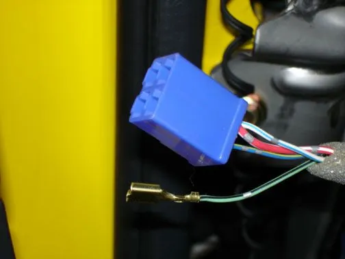

2nd photo shows the switch hardness with the green/black spade popped out from the hardness.
3rd photo shows the wiring.

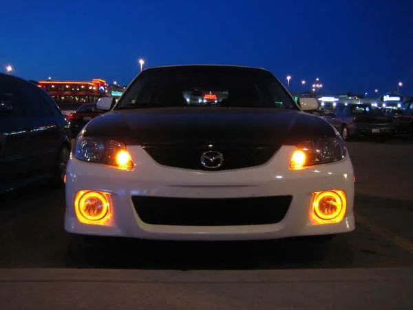

Is it illegal to drive with just the fog lights on at night? Would a cop have reason to pull you over? I have seen many people just use their fogs at night and I was just wondering if it's asking for trouble.
Yeah, it's illegal in Oregon, and I would think for most other places as well. It was just for the photo. :D
