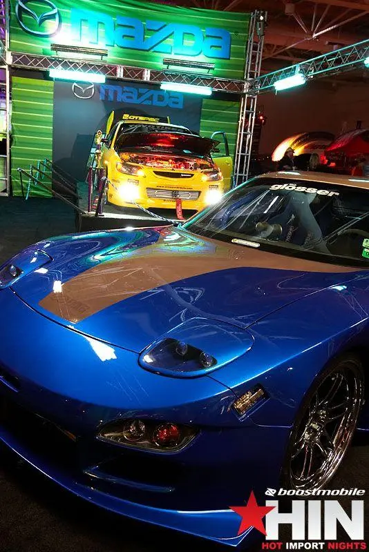

yeah, im going to try it this weekend, I have wanted to do it ever since I saw Pirahna's yellow MSP wired that way..that is the legendary MSP right there. I still look at the article "no respect" on his car in one of the 2007 Modified Mags I got. Also, I just noticed the side markers are on too, is that wired the same way you would do the fogs for "always on".
attachment.php
Side markers works like before. Maybe he modified them to always on beacause he didn't have the bumper markers anymore. Or pic was taken with car on hazards lights.
MSP doesn't come with markers on the bumper like the p5 does. That picture is a static display with parking lights/fogs on..no hazards. that's what made me ask about the side markers being wired "always on" with the parking lights.
