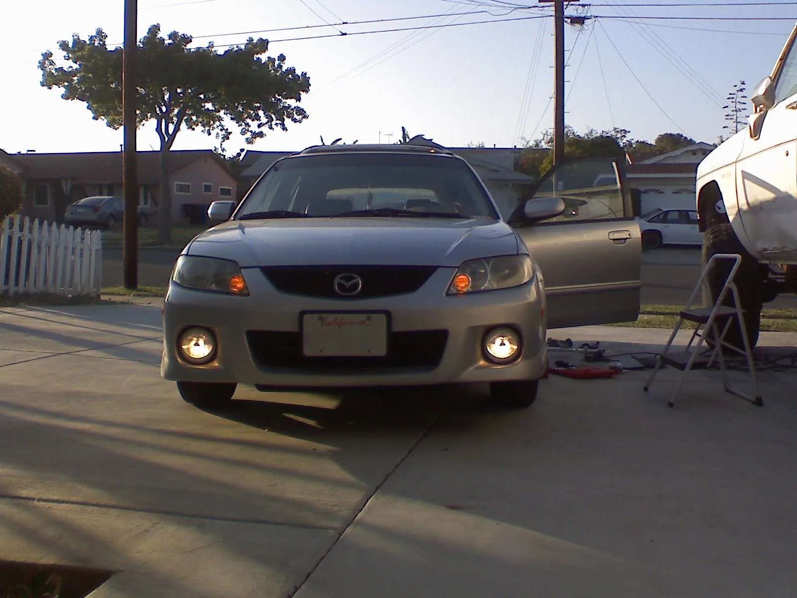

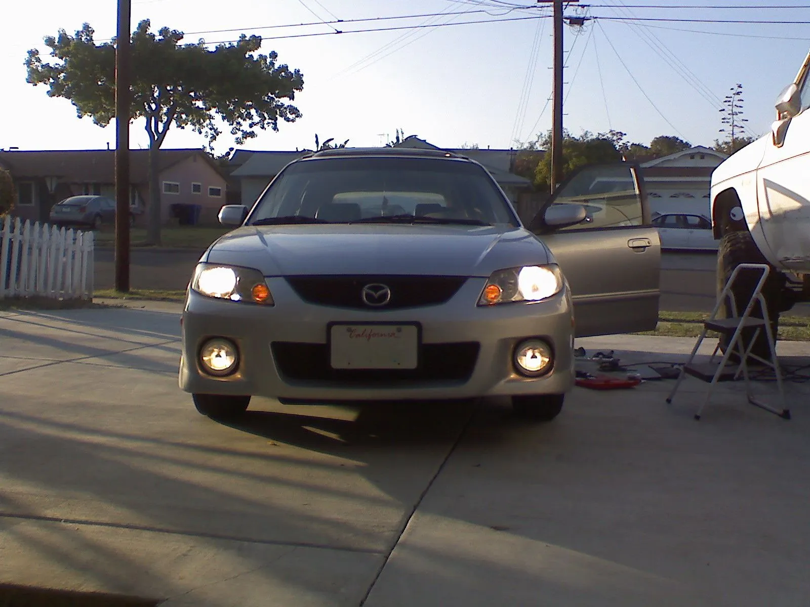

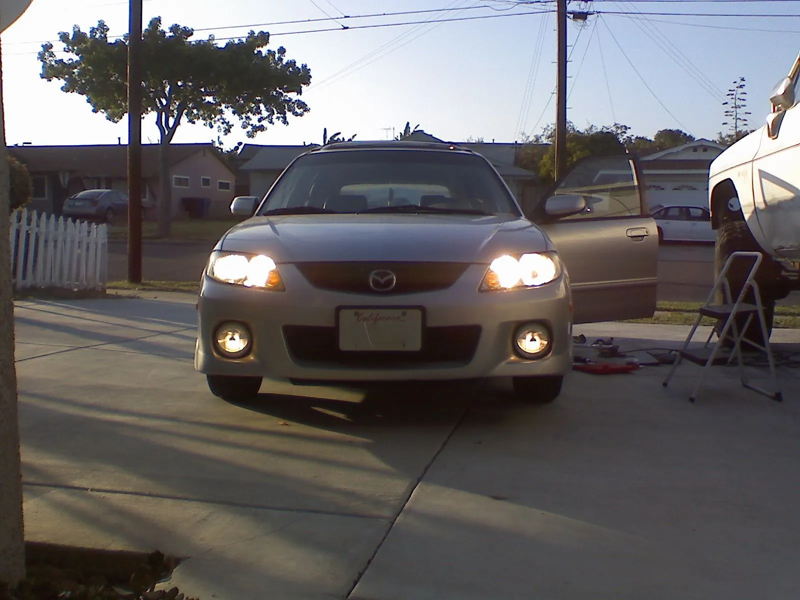

It took me about a half hour to do while trying to keep an eye on my "helper":) 0702091914.webp

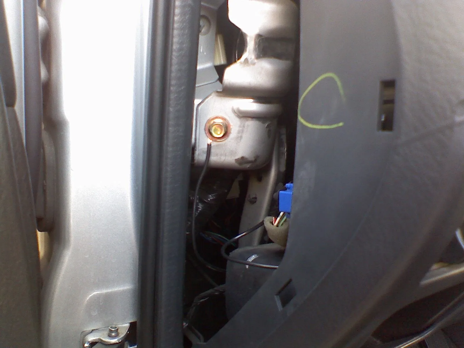

Here is a pic of my ground to allow the fogs with high beam.
And here are the payoff shots.
She needs a bath but still looks good to me. I also did the window power always on mod and it was by far the easiest thing I have ever done.
One thing I forgot, if you do not cut the red wire on the relay to do the splice the parking lights will feedback through that wire and the headlights will come on in the parking light position. I found this out when I tested and I just did the splice without cutting the red relay wire.
