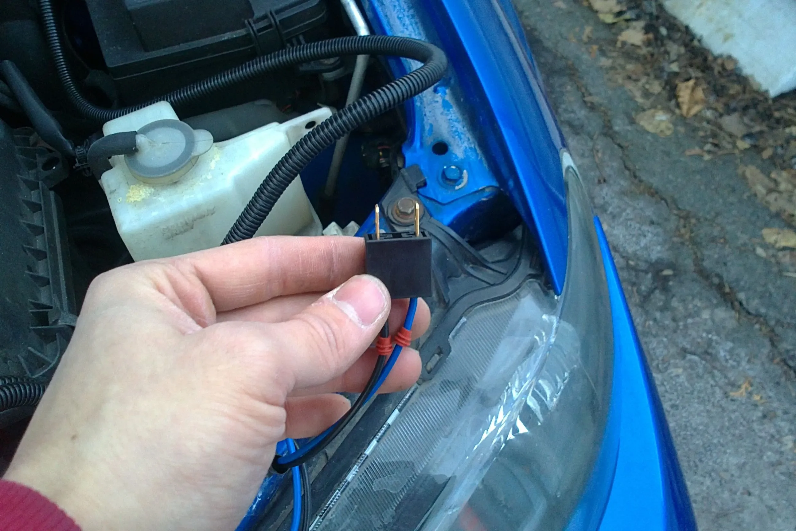

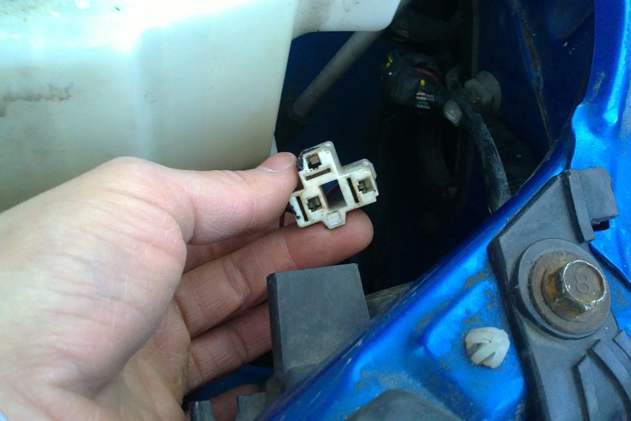

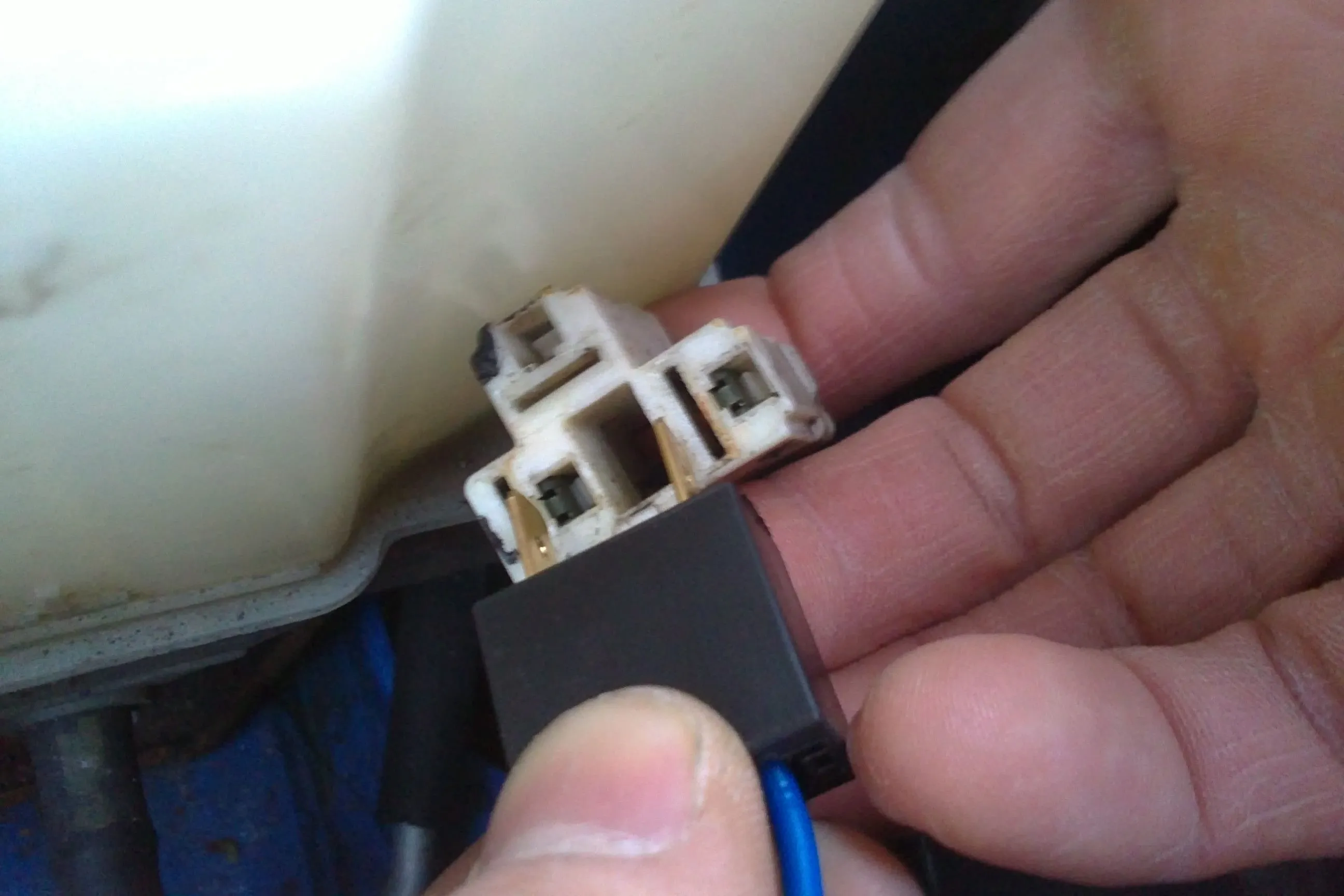

Hey guys I have a little question concerning the wiring in my Protege5.
I have one wire on the relay that I don't know where to plug it.
I read that I have to plug in the old light output wire put it doesn't fit.
Thanks
hmm....which harness did you buy? I'm guessing you either ordered the wrong connector harness or they shipped you the wrong one
They have all the different connectors available. Worst case, you have to make little jumpers using spade connectors to plug into your stock wiring. Best case, you verify which harness you bought and see if TRS shipped the right one
