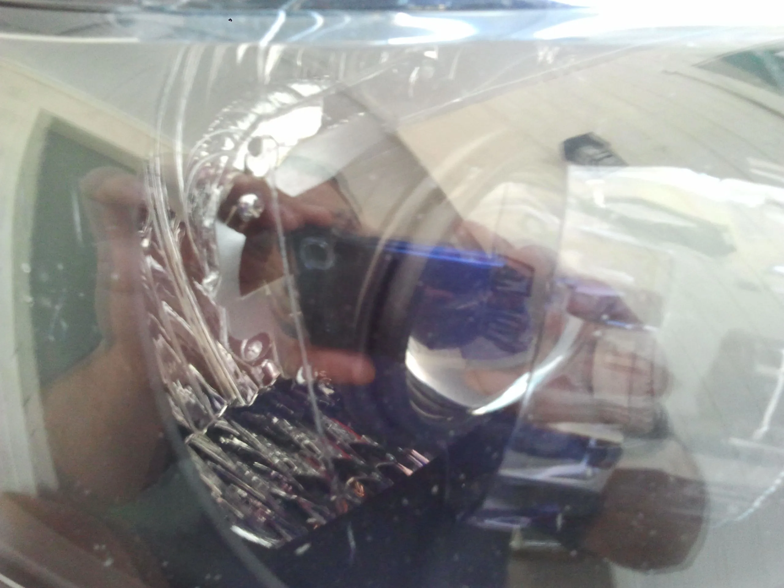

I currently have the Mini Graphite shrouds with my projectors. Don't have a camera with me right now but do have one on my droid phone. If it's okay with you, send me a text message on my cell phone and will send you back a pic of my HL.
EDIT...took pics with my phone...will post pics shortly.

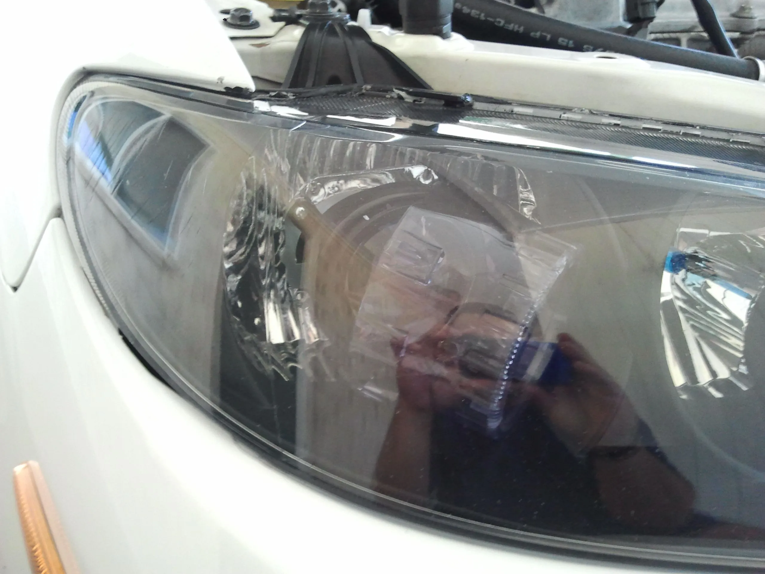

The rings are installed correctly, but are not really needed for those shrouds. Four small screws would hold the shrouds on.
I always use a two part epoxy to hold the shrouds to the rings and the rings to the projectors(on the shrouds that the rings can be used on). I've tried JB weld but my customers that have trucks and go off roading have had the jbweld crack and the shroud fall off.
The epoxy that I now use i've never had a melting issue or a shroud fall off.
You will need to open the headlights and remount or possibly replace the shrouds.

The pics don't do justice...but the shrouds seem okay since it just happened last night. So as you mentioned, I don't need the centric rings for the shroud that I currently have as it bolts on directly with the supplied screws. Will be removing the HL lens and fix the shrouds and after that make sure they are properly aligned since the first time I installed it the beams where off.
Thanks for the clarification with the rings and shrouds.

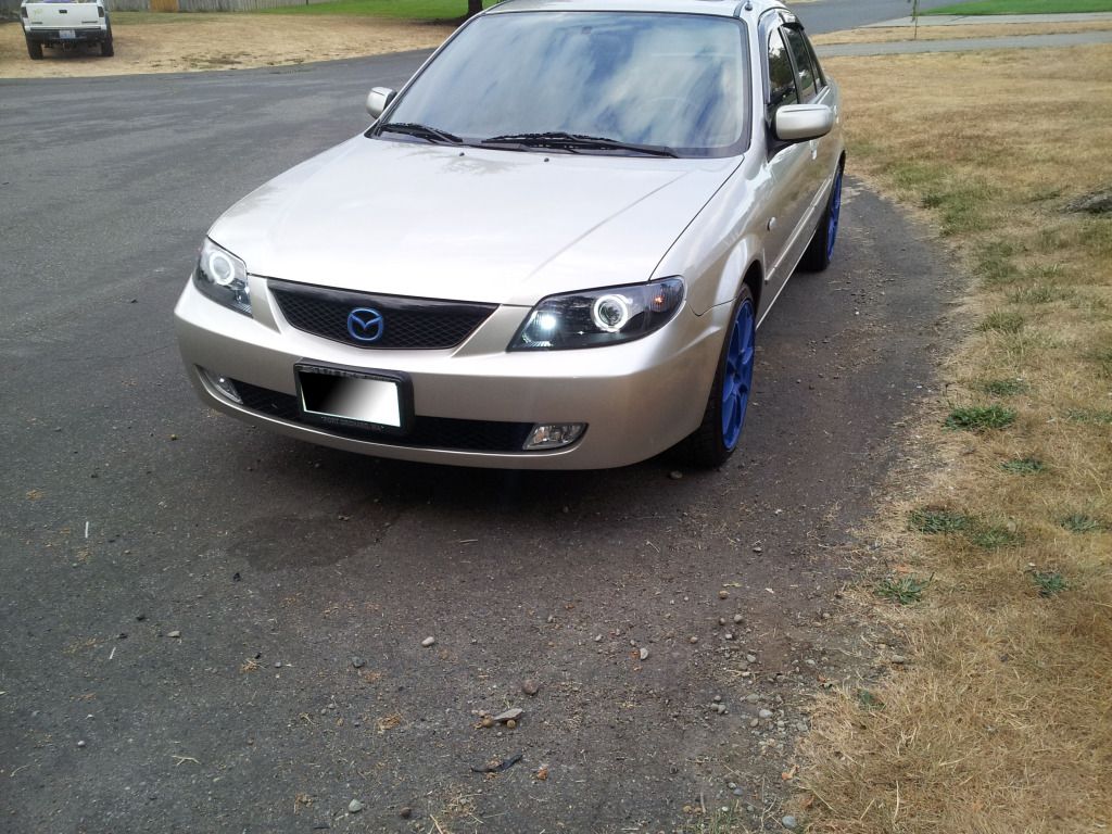

I'm thinking about doing this to my 2001 Protege lx I think it looks nice but I think I want the HALO'S too does anyone have a picture with the HALO'S I am trying to talk my wife into letting me do this to her car! She likes the look just not the price!lol
Here is a set a build for guy on another forum
