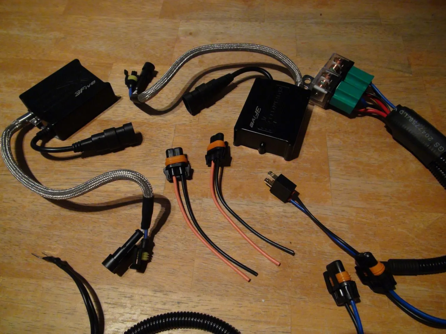

Ok so I started wiring my projectors, relay, ballasts and bulbs.
And I would need some help to know how to wire this!
It's a bit more complicated then I expected.. So if someone could just tell me how to wire this.
So first of all, the orange and black wire is not wire to anything, where and how I wire this?
Second, where and how do I wire the projector?
and third, where do I wire the rest?

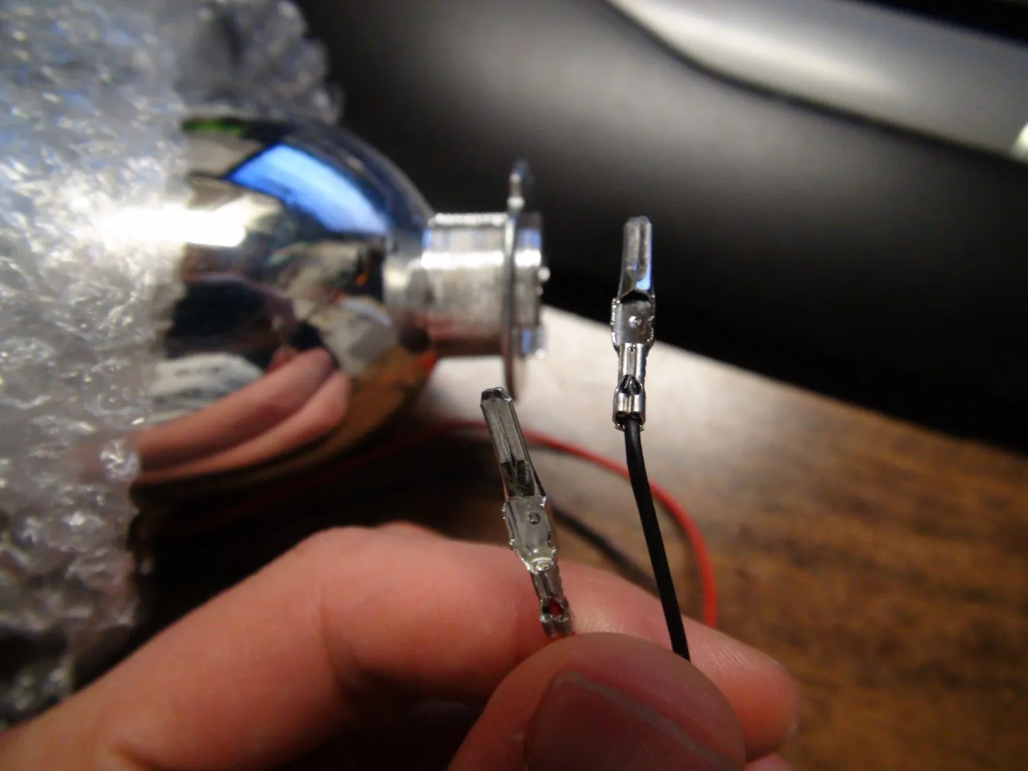

Trikevion- I to ordered a set of the morimoto mini projectors and I'm not to sure what the little red and black wires that run off the projector hook up to. Everything else seems pretty straight forward though. There is an installation manual on the retrofitsources website if you need a little help.

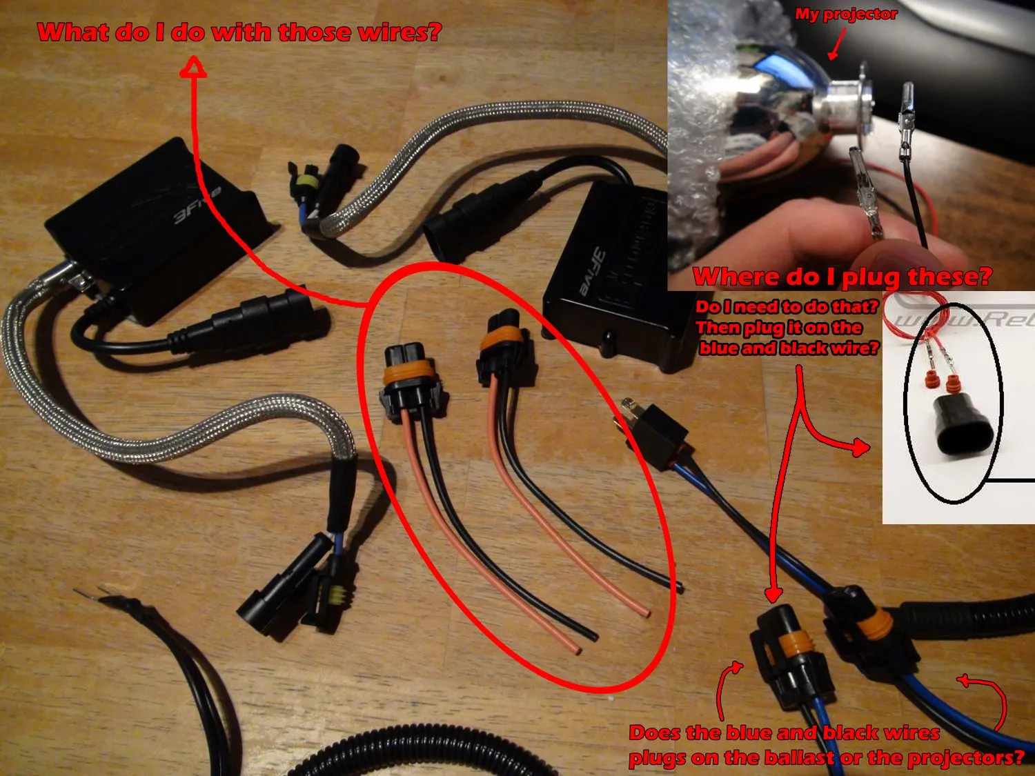

Yeah I checked out the site out and I overused the internet to find some info but now i'm kinda stuck..
Here I'll put a little picture to illustrate my problem.
My biggest question is: What do I do with the orange wire? I think I must plug them on the ballast, but what do I do with the other end...? It's wired to nothing loll

The wires coming off of the projectors are for the High beam flap, you wire them to your high beam plug. Thats what the orange and black pig tails are for, so you can make it plug and play. Cut off the factory high beam plug and wire in the orange and black harness in its place. Then put the pins into the empty connectors provided and plug those into the connectors you just wired to your high beam circuit.
Everything else is pretty self explanitory

but why should I cut the original high beam wire in my car? Why not just plug my projector in there without cutting anything?
You dont have to cut it, it will just be cleaner that way,
for now, I just have the pins from the projector pluged into the OEM high beam plug, and then work just fine, but it looks a bit ghetto

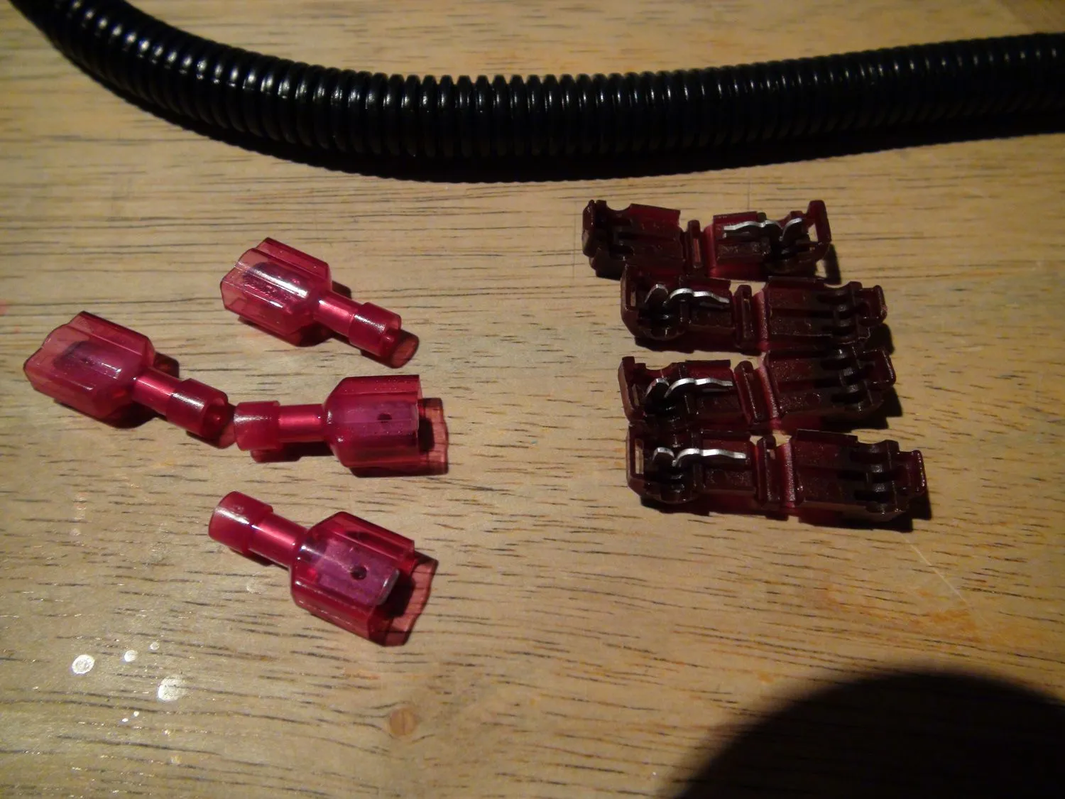

Well then you would use the taps included and just tap into the wires instead of replacing the connectors. But in all honesty, you wont need your factory high beams,

So blue and black goes in ballast and projector goes in high beam and I guess that's everything right? For the bulb and the battery wires its pretty logical.
yup, i think you got it now
and something you could also do just to clean it up, get the female connectors for the high beam plug off Ebay ( i did for mine) so the high beam wires coming from the projector still looks OEM plugged in
