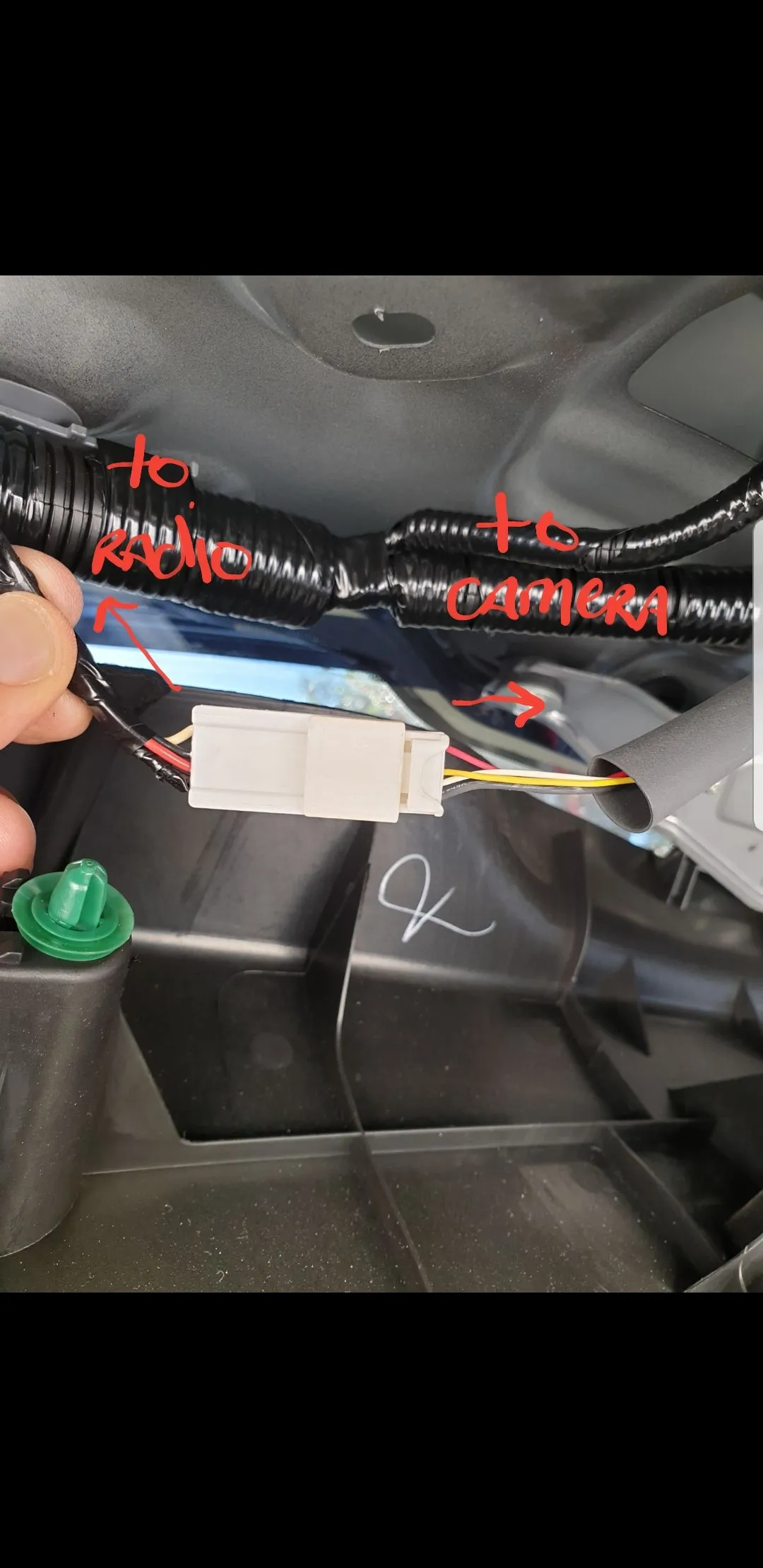

Hello, sorry to hijack your thread but I'm hoping someone can help me. My question is basically the same you posed, I have a 2013 JDM Mazda CX 5 and I installed a Pioneer head unit. The problem I'm having is figuring out the harness for the backup camera (K015-67-RC0A).
Based on the connector that is attached to the actual camera, it has 4 wires coming out, red-black-white-yellow. Does anyone know if these colors are as straight forward as they suggest, red +, black -, yellow & white for video signal? I just need to confirm which wires are which so I know which goes to power and which I need to put an RCA end on.
Thanks for any help in advance!
Hey guys, does anyone have any knowledge of this?
I've posted a pic of the wiring/connector for reference.

I don't know about Pioneer unit, but Kenwood has a 12V source for backup camera and the factory camera is a 6V camera(!). I'm using a 12V to 6V adapter. I did that connection, but it's been years since than, and I don't remember how it goes.
My car is 5 years old, and the factory camera is getting bad. Hazy., specially at night, or when is raining.
If I would do it again, I would use a better 12V camera.
I have installed one of those Chinese metal housing cameras($16), and it's been great on my wife's car.

You could use two wires from that connector, of your choosing. Just use the same colors at each side.
Hey thanks for the response, yea the Pioneer units also come with the 12V source for the back up camera. I've already got a 12v to 6v adapter on hand, I really just wanted to know if the color code coming off the actual camera is as it suggests, (red + black for power) and (yellow + white for video). I'm trying to retain the factory camera since it's still showing pretty good, hopefully someone will chime in soon, thanks again man!
