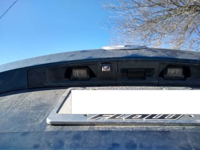

Here you go:

I looked into it further, and while they look similar, this diagram shows that the license plate lamp is one unit, and that the cover doesn't come off. The part number is GSJ1-51-26YA, and it is the same part number for the 2019 CX-9. However, for the 2018 CX-9, the part number is TK48-51-270, and the diagram shows that the lens and bulb are removable/replaceable.
Your 2019 GT Reserve should already have LED license plate bulbs, so you can use the bulbs that came in the kit as backups, or sell them off.
EDIT: If you still want to swap the bulbs, Shimian posted some info in the resource I linked about accessing the LEDs from the interior. Since the 2019 CX-5 and 2019 CX-9 license plate lamps share the same part number, you can probably swap the bulbs just like they did. Unfortunately, Shimian's info details the process for the CX-9, so I'm not sure how much of the panel removal process would apply to the CX-5. Shimian referenced (and posted) a video for a 2014 CX-5, which might be of some help.
