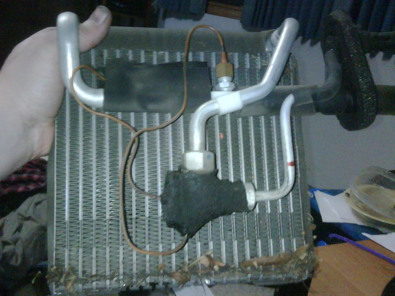

Remove the glove box, remove the 2 Bolts holding the A/C Box in place, wiggle it out. From here You will need a friend to feed the A/C line from the engine bay through the firewall... there are 2 Lines, one splits just before the firewall, the other on the A/C Core...
Once you get the lines fed through the firewall, there are 5-6 Screws to remove to seperate the "Air Box". Once seperated the A/C core comes right out!
Join the box back together, block the A/C lines off with some Duct Tape, then put the foam back on, I stuck mine with some 2-Way Tape.

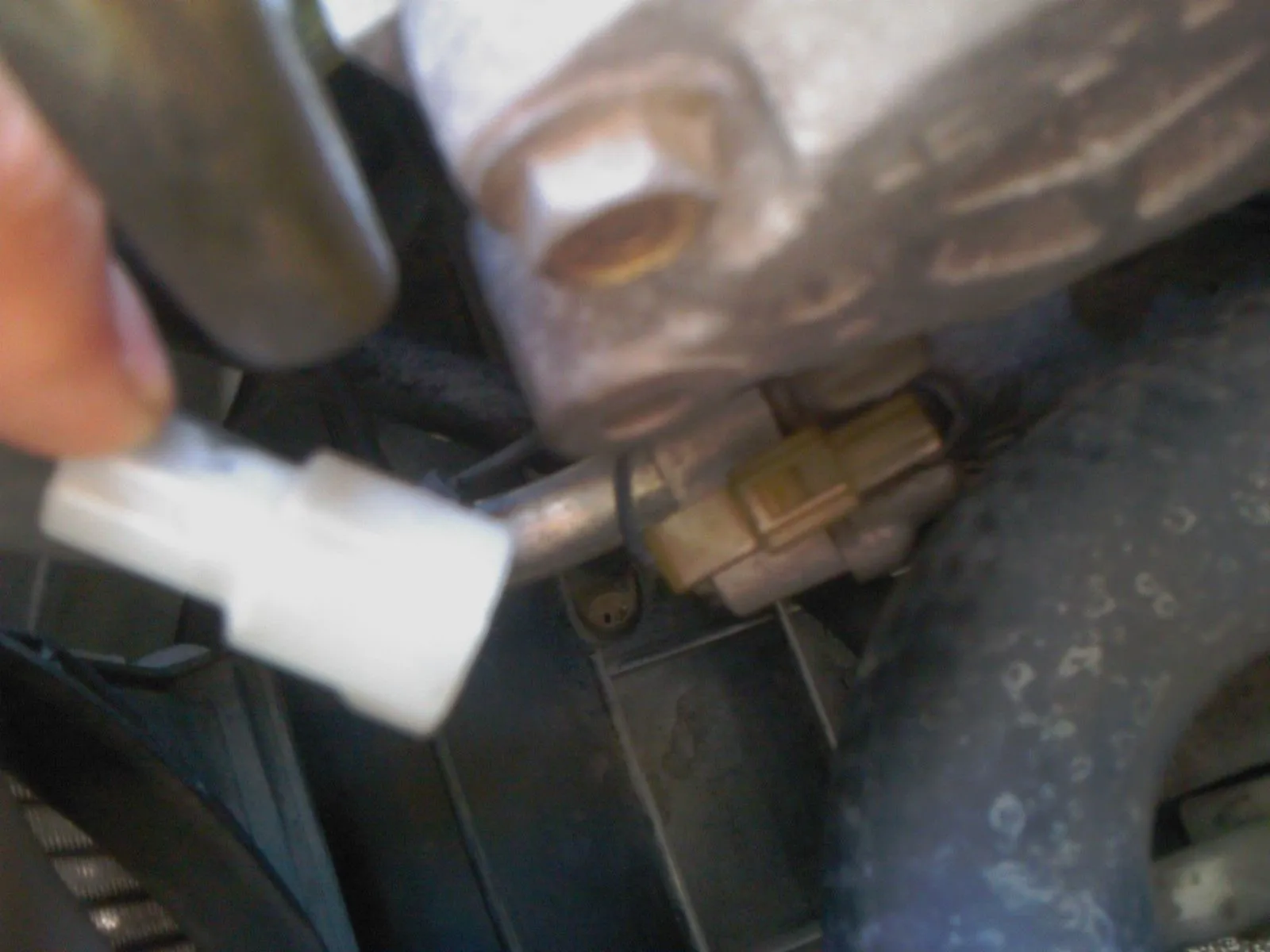

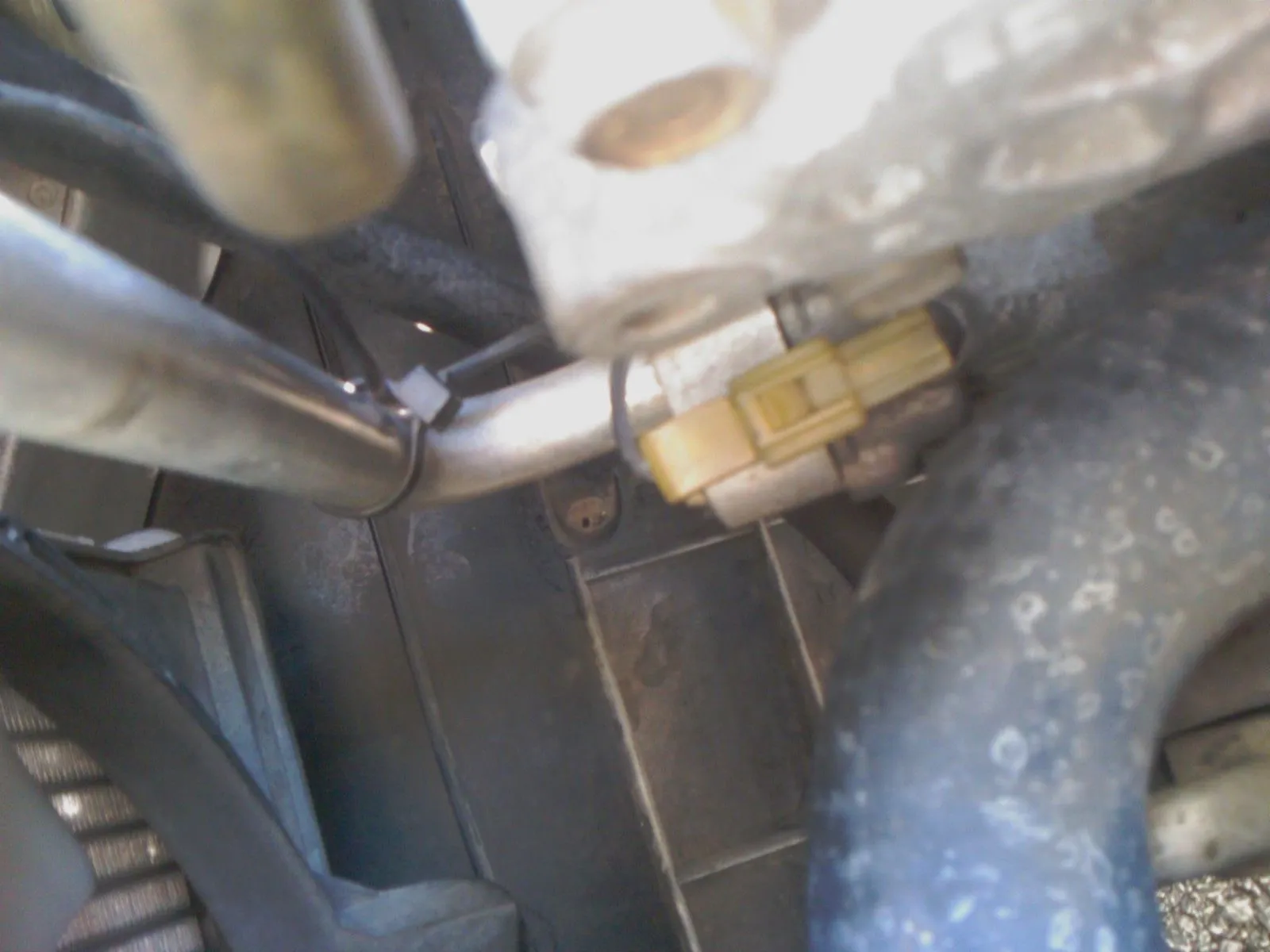

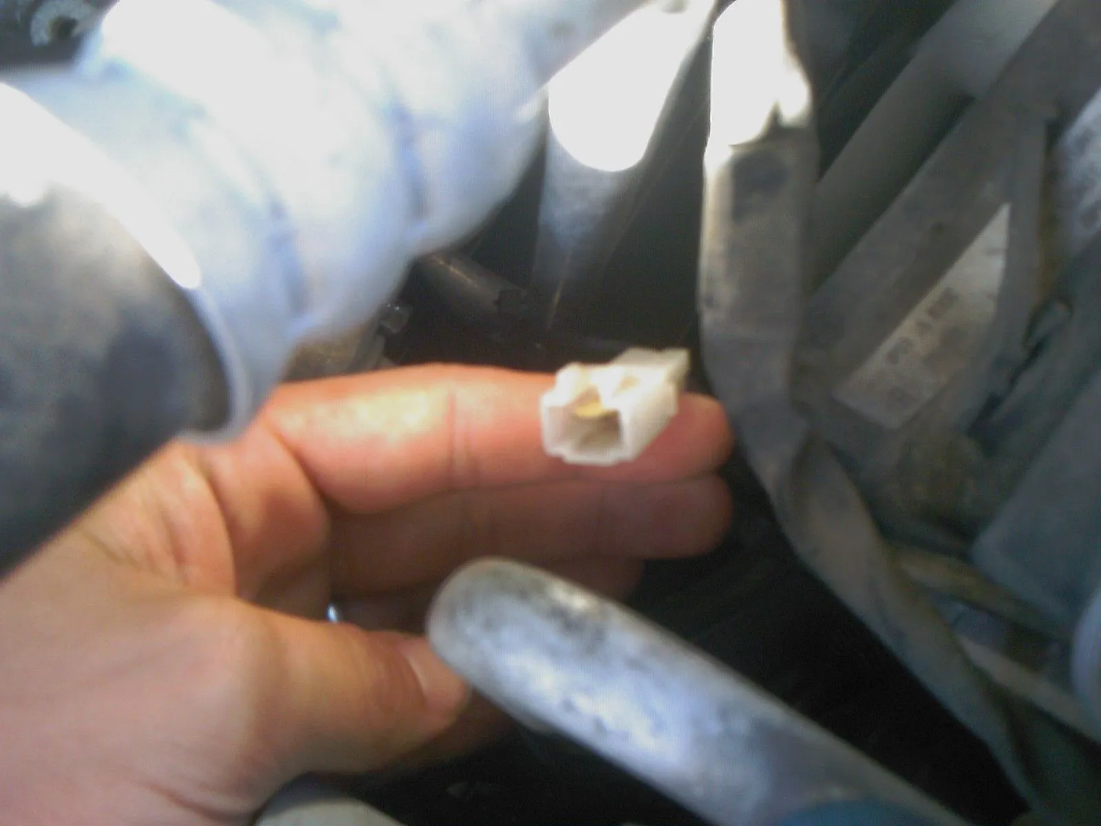

My wife's 2000 Protege had her alt belt bust and fly all over the engine bay. Well after installing both belts new, I found that her A/C did not work (or did not blow cold).
Now, I look at the A/C Compressor and notice that there is a wiring harness comeing out of the front of it with three (3) wires total. Two of the wires are connected to each other with plastic connectors, however there is a third wire that has about a foot of slack on it that is not connected to anything! (Its a male connector with a plastic sheath)
Background information: The Clutch does not engage while the A/C is on. With a tap on it with my finger while the engine is running it will make about a half of a rotation
Could this third "unexplained" plug be the power for the clutch electromagnets? If so, please somewhere tell me where it is supposed to plug into. I'm at my wits ends. I'll try to take a couple of pictures tomorrow to illustrate what I'm talking about. (This AC problem just HAS to be a simple one!)

When I disconnected mine, there was a single wire near the Coolant hose I believe?? Sound About right? The "female" end should be right around there...
sounds like the right wire to me, we are talkign about the one facing the ad right off the compressor right? If that one wire is not hooked up your AC will not blow cold air.

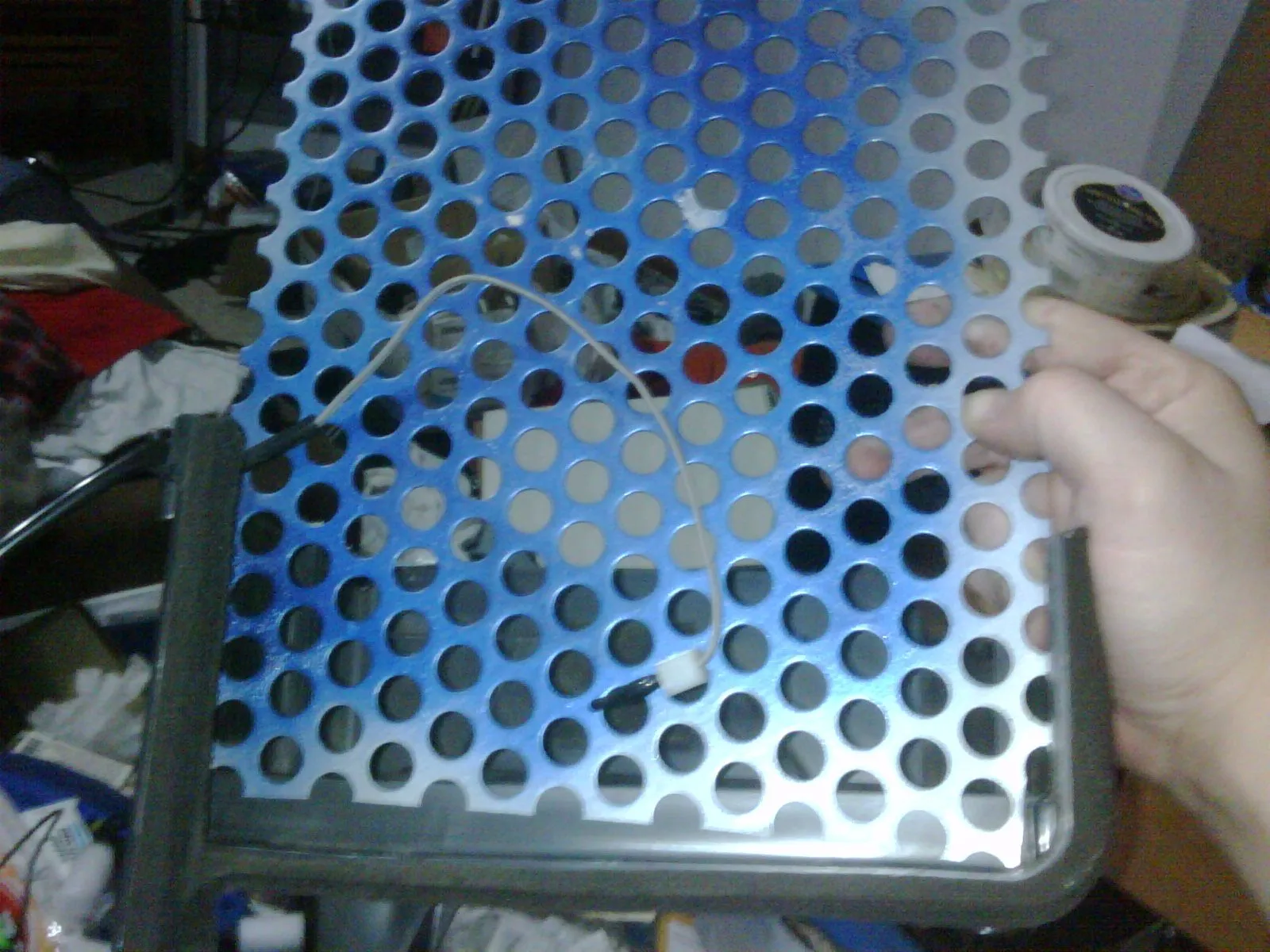

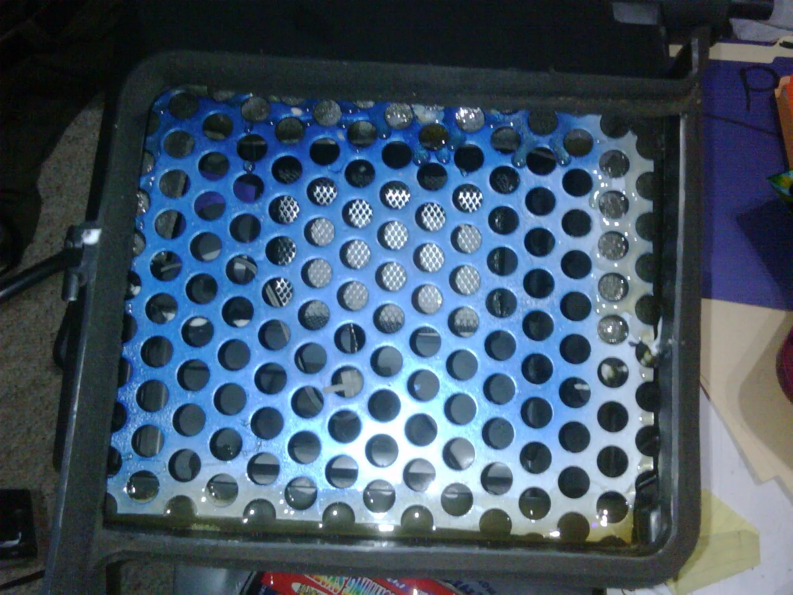

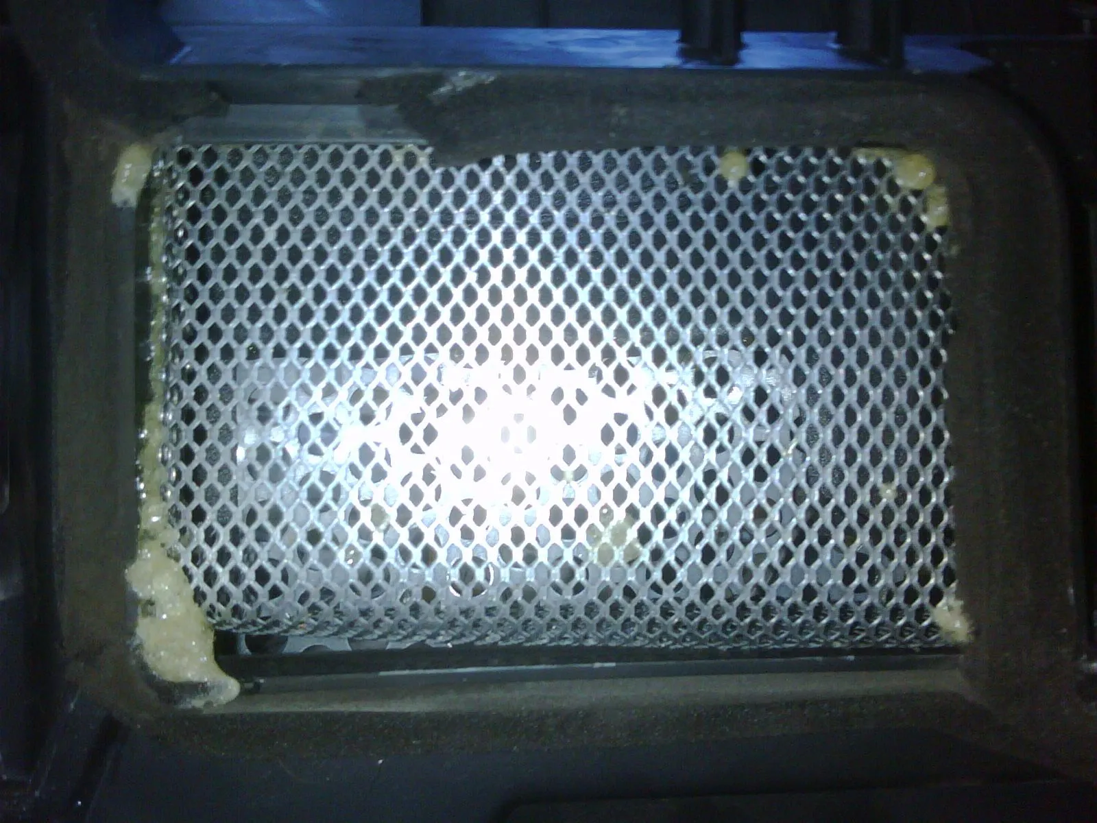

Got the Air Box out of the cab. Thanks "Tarmac Terrorist" :) for the write-up. BTW the "two bolts" are one at the top of the box and one at the bottom of the box, both mounting the box to the firewall. So i saw all the crap that got down into the air box and decided to put up some wire screen/grill that i had laying around to hopefully prevent anything entering the fan box. As for the "holes" in the firewall, I'm re-routing my 0/1ga. through the large hole and additional power wires through the other hole, a better fit. They come out where the large sensor used to be. Pulled the relay from the fuse box and re-connected all the sensors just in case. Thanks for the great write-up guys. My car should be alot happier!
