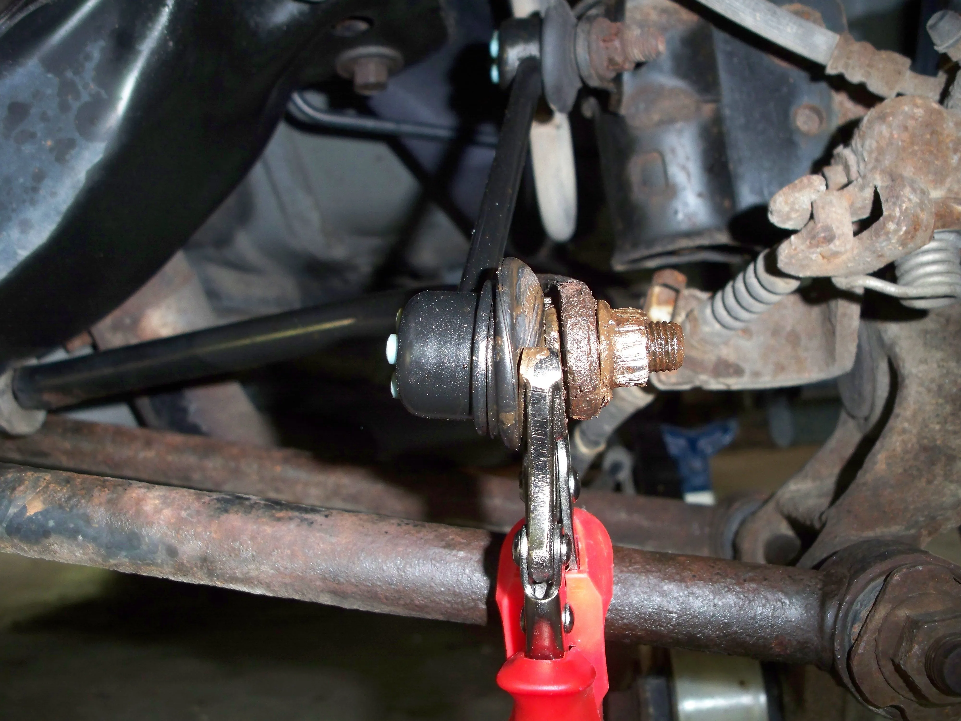

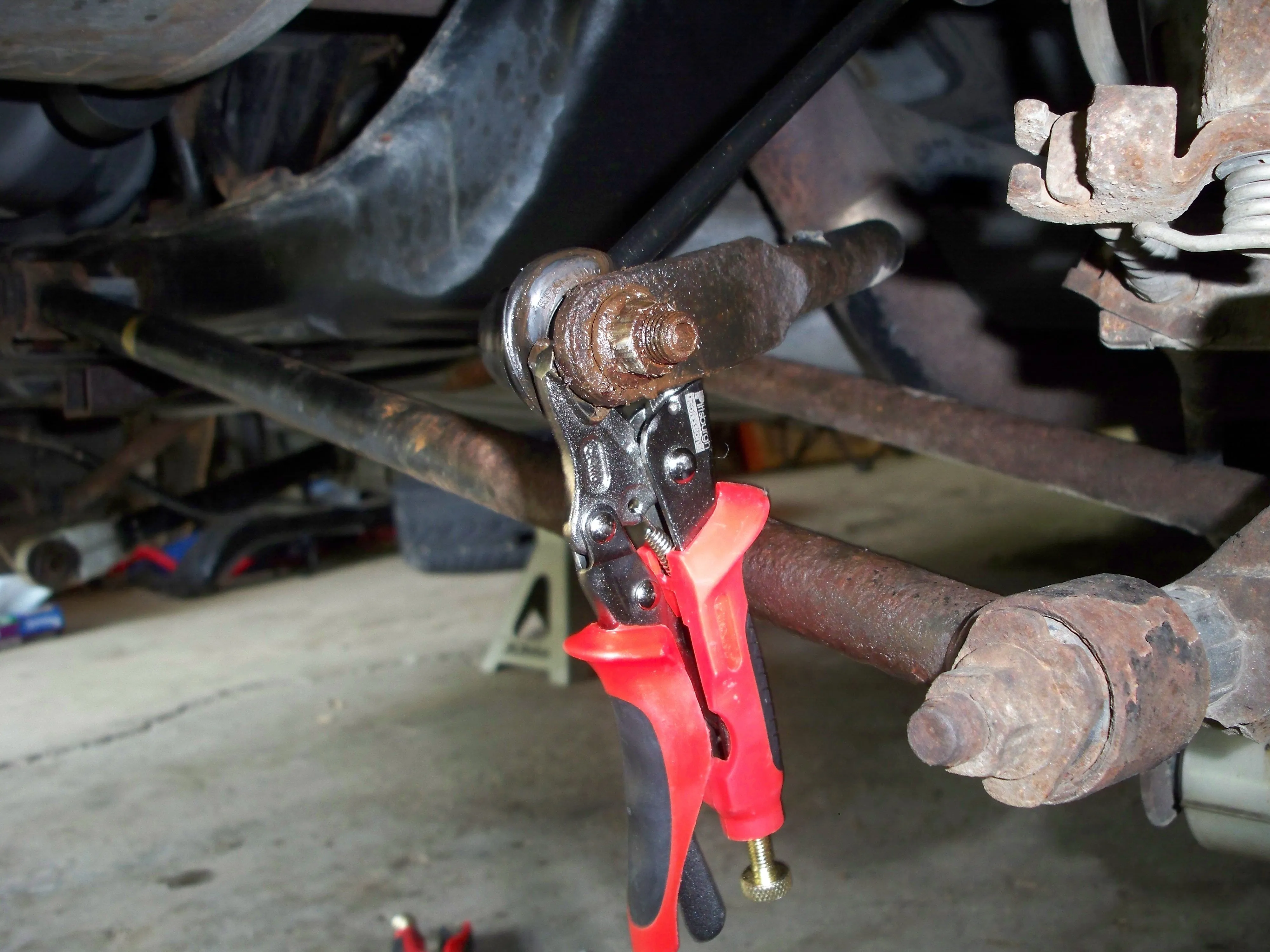

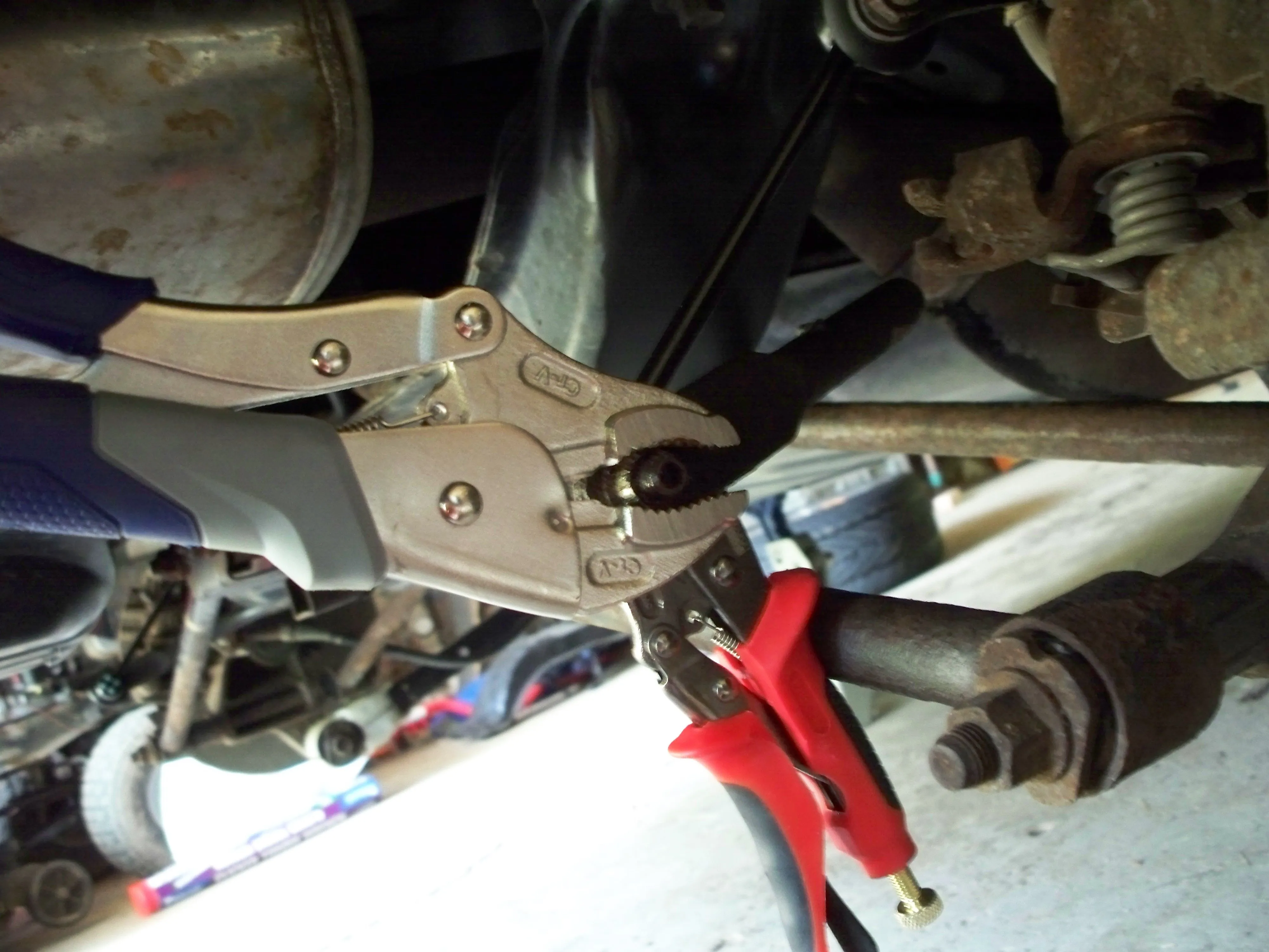

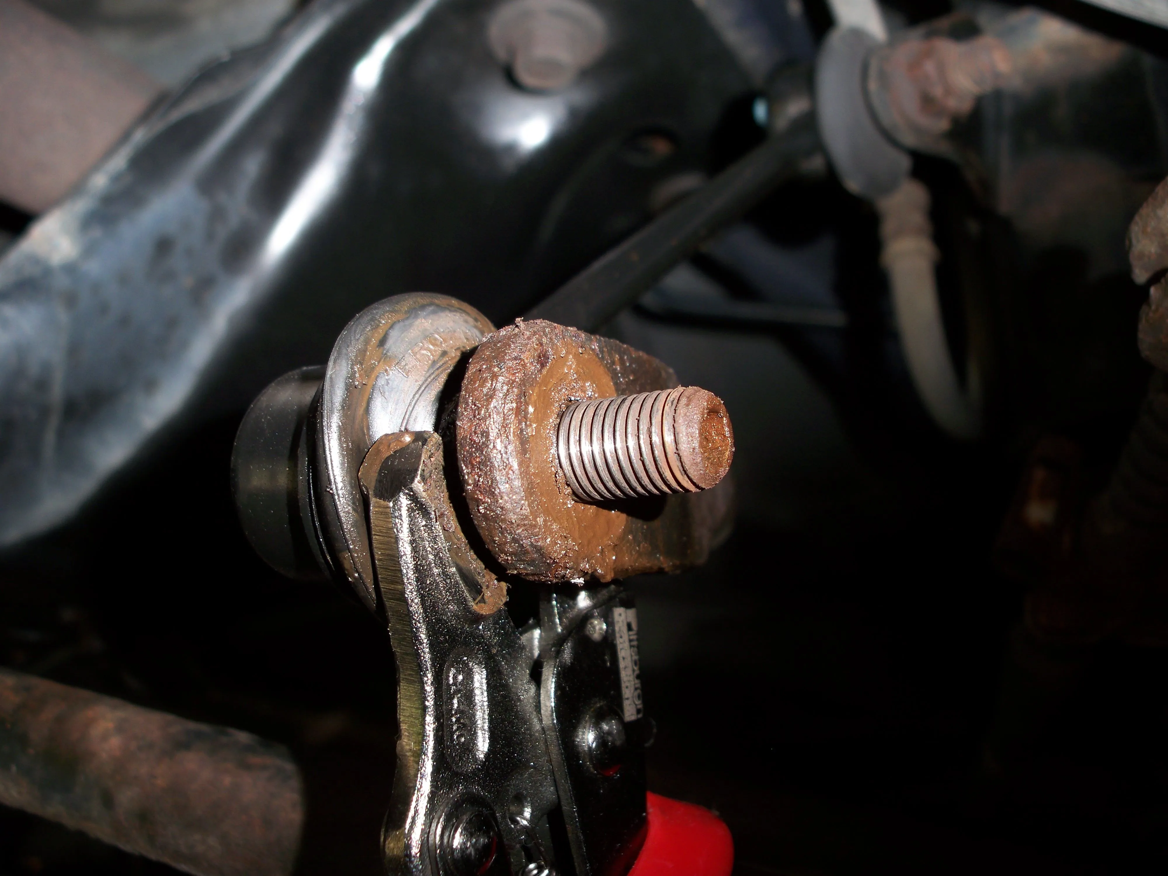

6) Of course, the damn endlinks are the hardest part of the whole process. I soaked them (as well as all bolts in the project) in PB Blaster the night before and the morning of, and still, I had trouble with the endlinks. When taking off the passenger side, I ended up stripping the nut. So I looked into alternative ways of removing the nut. In the attached pictures, pictures 1 and 2 show that a 5" pair of vise grips can just clear the rubber boot and grab the flat part of the bolt behind the sway bar. Then, a large pair of vice grips (I think mine are a 10" pair) can grab the nut and hopefully get it off. I let the 5" vise grips bottom out against the lateral link so that it couldn't turn. This method worked out well and with some patience and a bit of luck, you can get the nut off. On the passenger side, it came off with out damaging the rubber seal. On the driver's side, I wasn't so lucky- but the damage to the rubber boot was not that bad. Pic 4 shows my success.
7) Most likely, you will end up stripping the endlink nuts getting them off. You can get replacements at Lowes. The size is M10-1.25. I also bought M10 washers to put on there since the original is a flare nut.

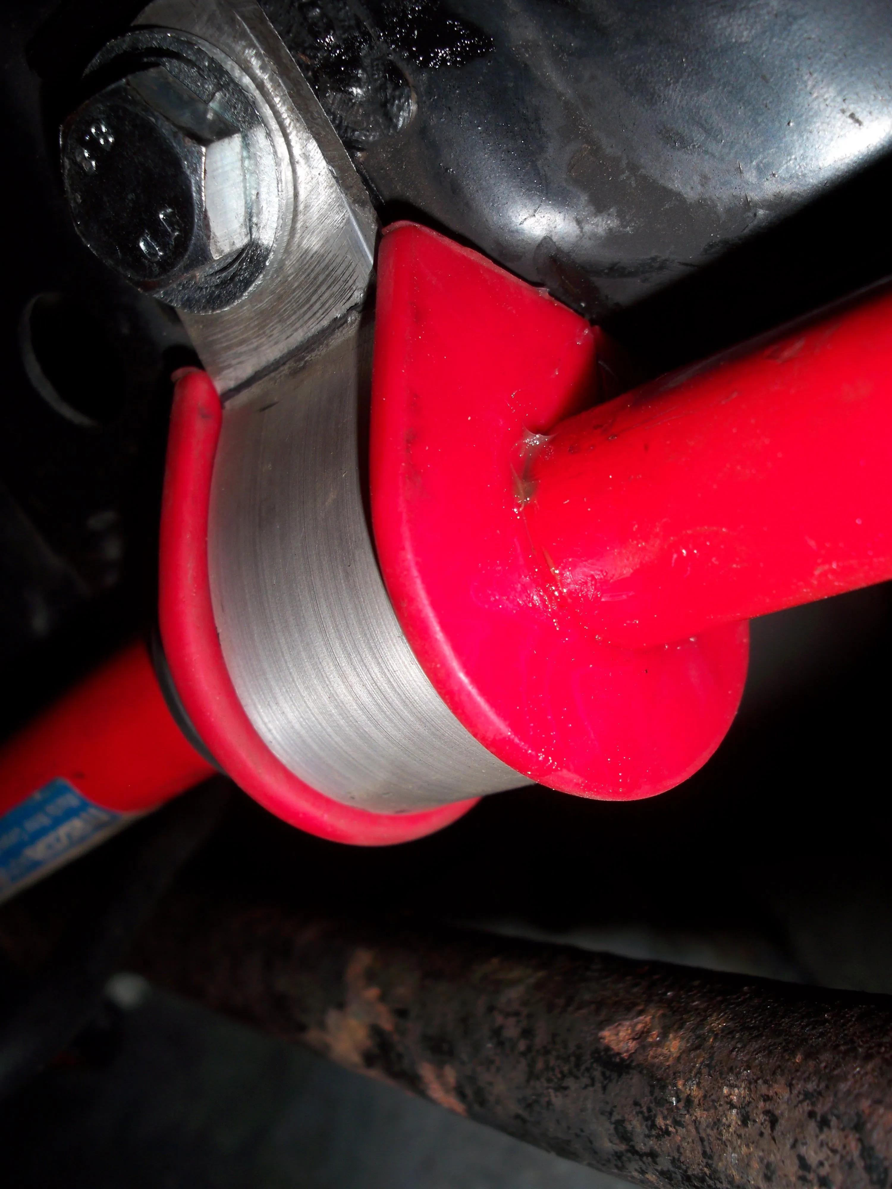

8) If you are putting on a racingbeat swaybar, then you probably were smart enough to order 20mm urethane bushings from AWR. You should note, however, that the stock P5 horseshoe brackets will NOT fit over these bushings. A good option is to get the AWR spacer blocks (at an outrageous $35 each) plus AWR horseshoe brackets (I assume they sell these). ...Or you can take the frugal route and make your own horseshoe brackets out of aluminum or steel flat stock from Lowes. I choose aluminum because it is so much easier to bend into proper shapes. I honestly don't know what size I bought, but it most likely was 1" x 1/8" x 3'. I just took one of the bushings with me and eyeballed which width would fit best. Note: If you choose this route and make your own, be sure to measure off of the MSP crossmember, not the P5 one. I made this mistake, but fortunately the 3' of stock was enough for two sets of brackets- the first which were too small, and the second which fit nicely. I didn't take pics of these, but I will take some tomorrow.

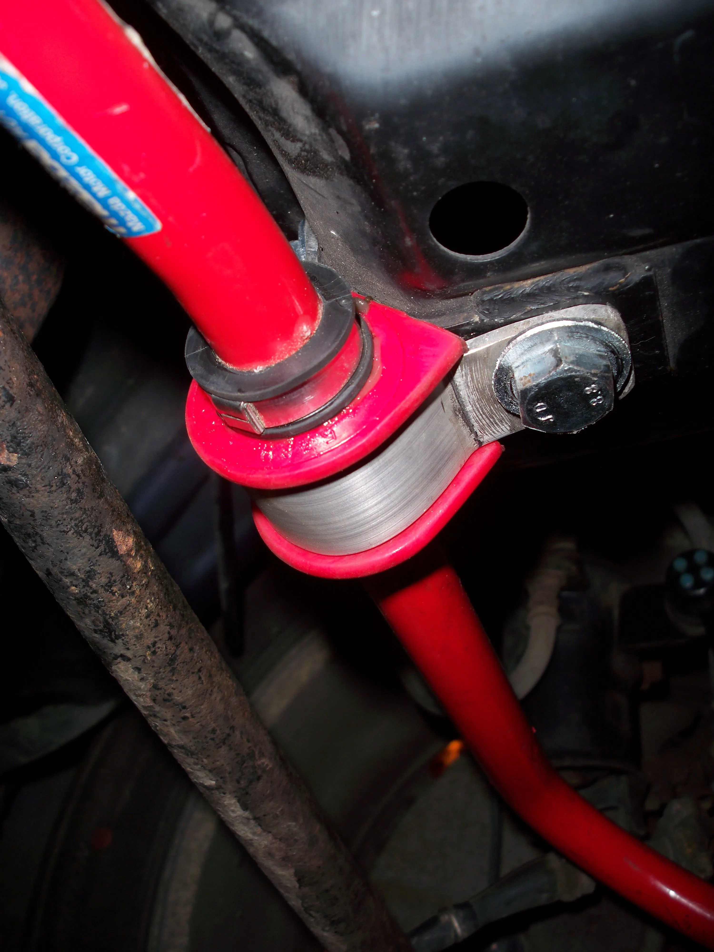

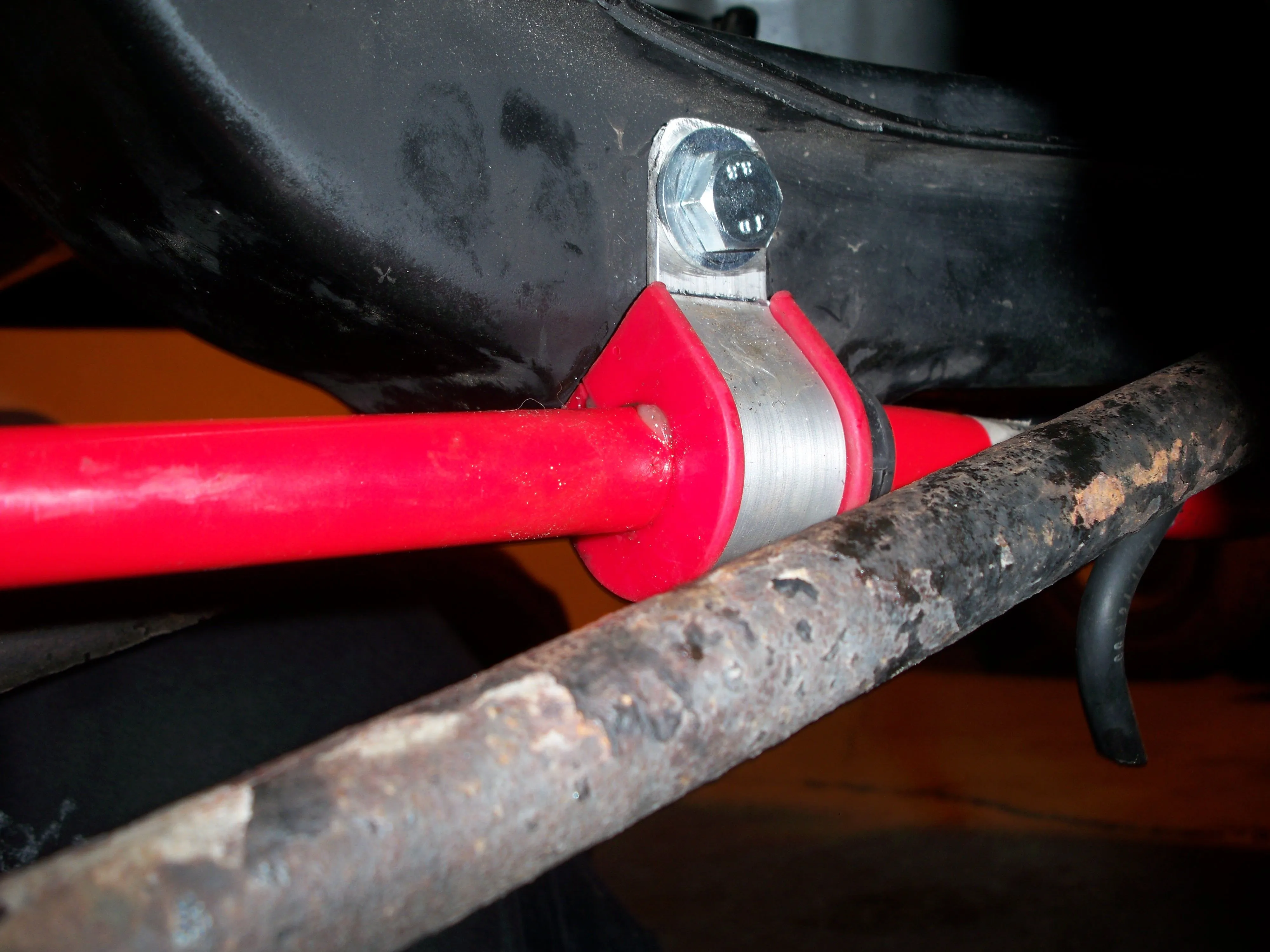

As promised, the bolt size for the sway bar brackets is M10-1.25 and I used a size of 25mm long. The stock is probably around 20mm, but I wanted to have enough room for a washer.
Attached are pics of the custom bracket- also as promised...
