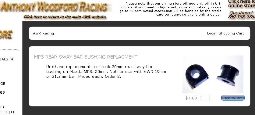

The bold sentence confirmed everything.
AWR makes a 20mm bushing now. :)
Thanks man

For future reference, AWR 20mm bushings do NOT fit the stock LX brackets.
I ended up getting MSP endlinks and boring out my stock bushings.
I just need to get some ES/P5 brackets..
