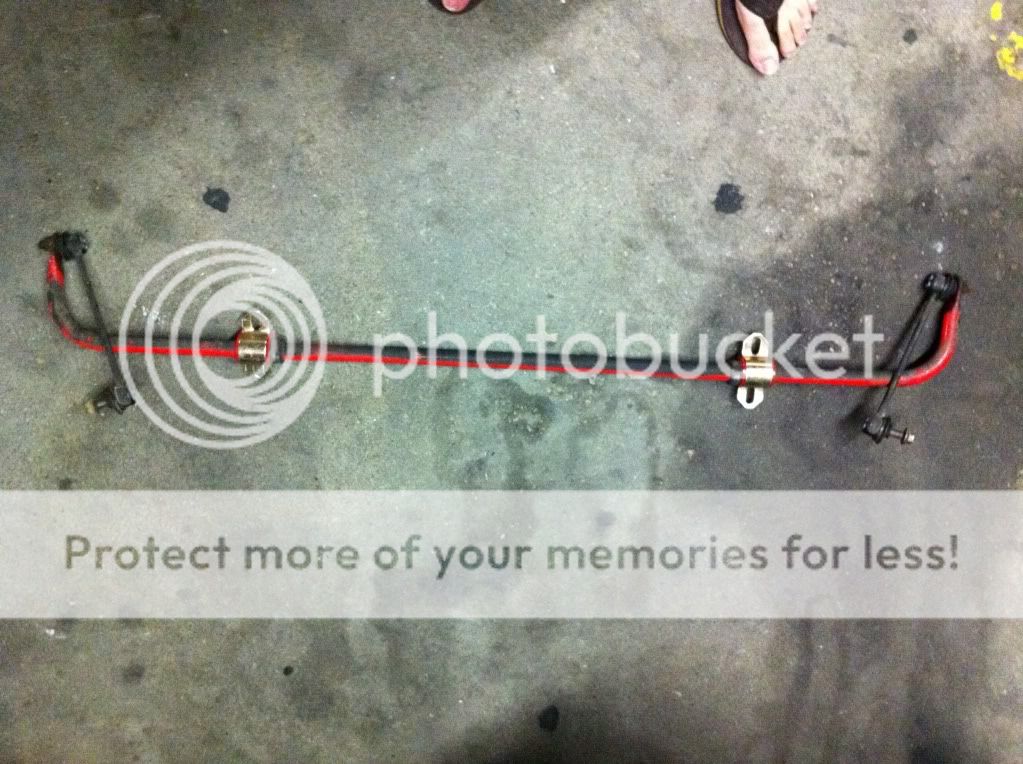

I've read this thread from beginning to end and just want to clear up some things before I attempt to do this.
I have a 2001 Protege ES
Here's what I think I need
-RB Rear sway bar
-MSP End links
-ES bushings
-ES brackets
I bought the bar and was told the endlinks were MSP links but I wanted to be sure

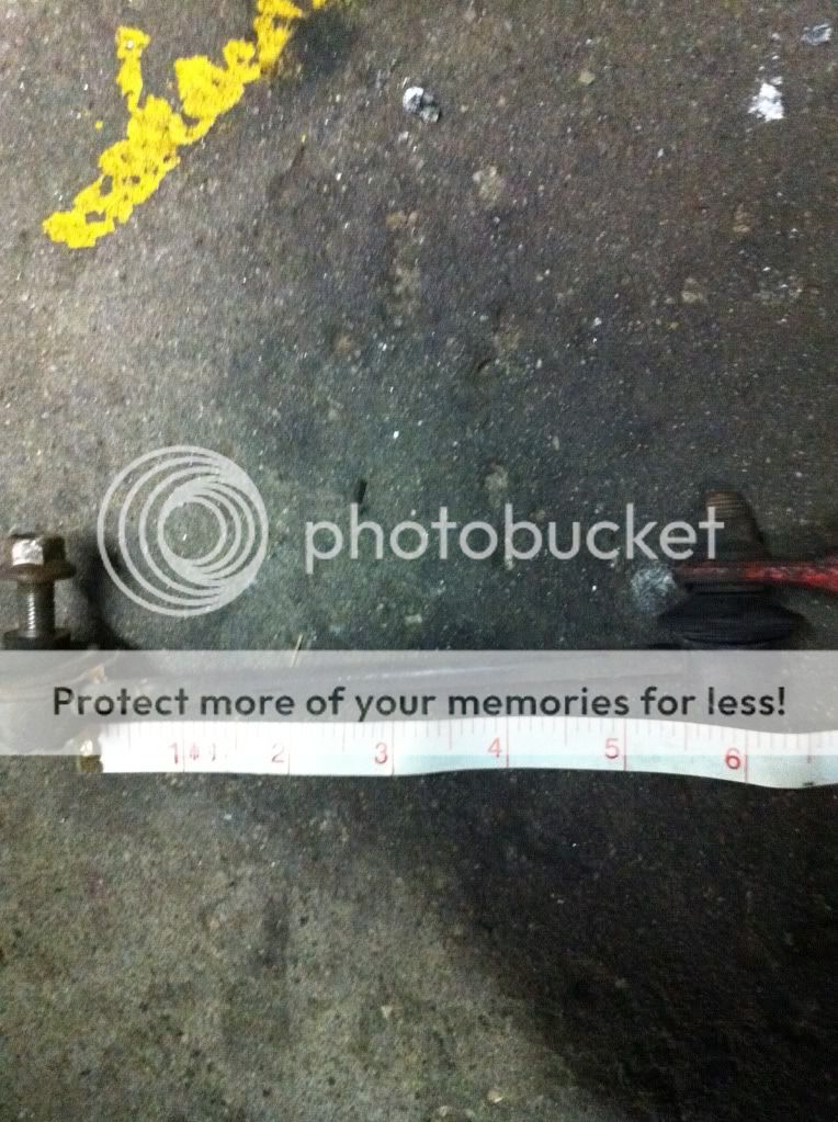

The links measure out to be 6-6.5 inches. Are these the right links?

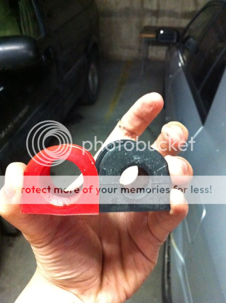

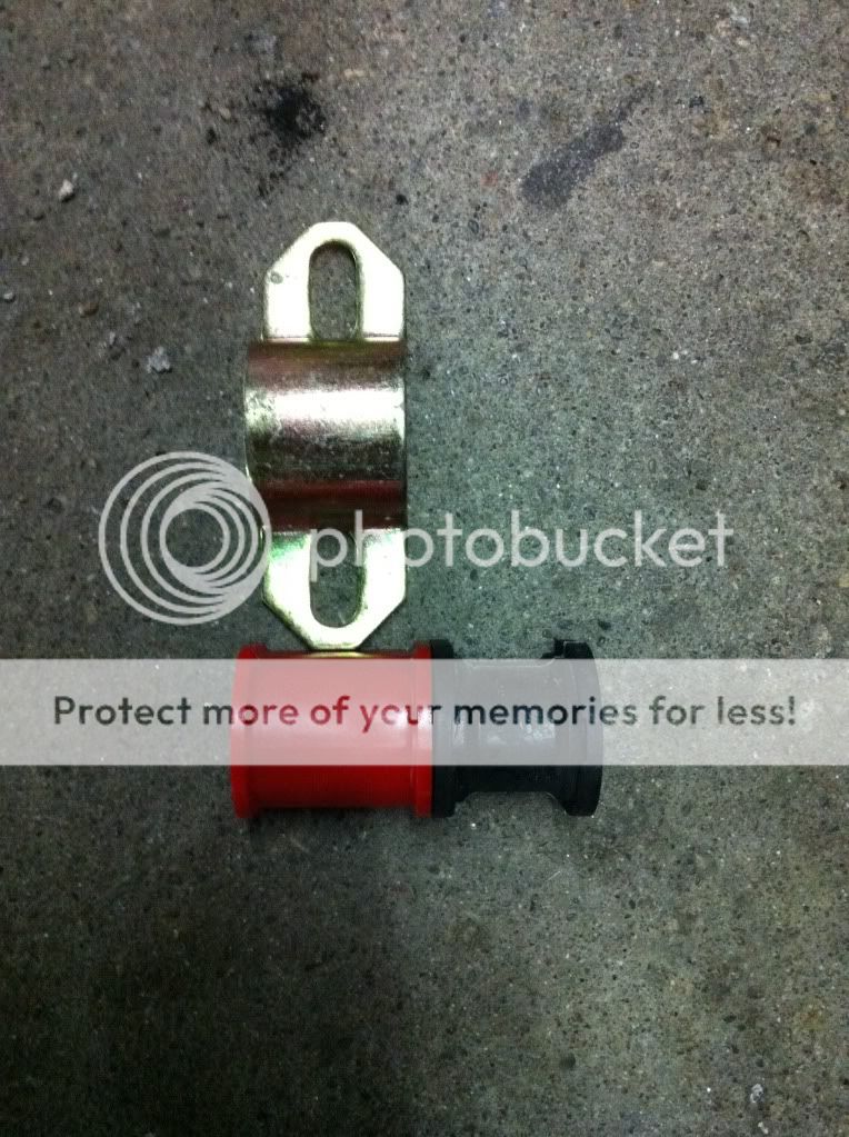

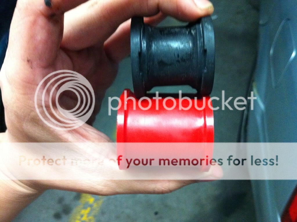

I've read using the stock ES bushings opened up with the stock ES brackets is the way to go however I have Energy poly bushings that came with the bar and are the exact same size diameter wise but are longer in width. The brackets are flat and wont bolt properly to the ES. Can I use the thinner ES brackets on these bushings or would that leave too much play for it move around? This is what I mean. Also the energy bushings do not seem snug to the point that it takes little effort to spin the bushing on the bar, should it be able to do that?

Just bend the bracket ends so it bolts down. To keep the bar from sliding back and forth, there should be two metal straps on the bar to prevent any lateral movement.
So would you all recommend the poly bushings or the ES OEM ones? How bout the length on the MSP end links?
if the endlinks are only 6.5 inches long, that seems short. with the bar bolted to the subframe, and the endlinks bolted to the strut and bar, the sway bar should be roughly parallel to the ground. if the links are too short, the bar will flip and cause all sorts of crazy sh!t.
K well that messes me up was planning to swap the bars out this weekend, anyone have MSP rear end links for sale or knows where to get them for cheap?
dealer would be the best place to go to make sure you get the right links.
contact MOSI through Toprotege, they can get you the proper length you need and are local to you.
