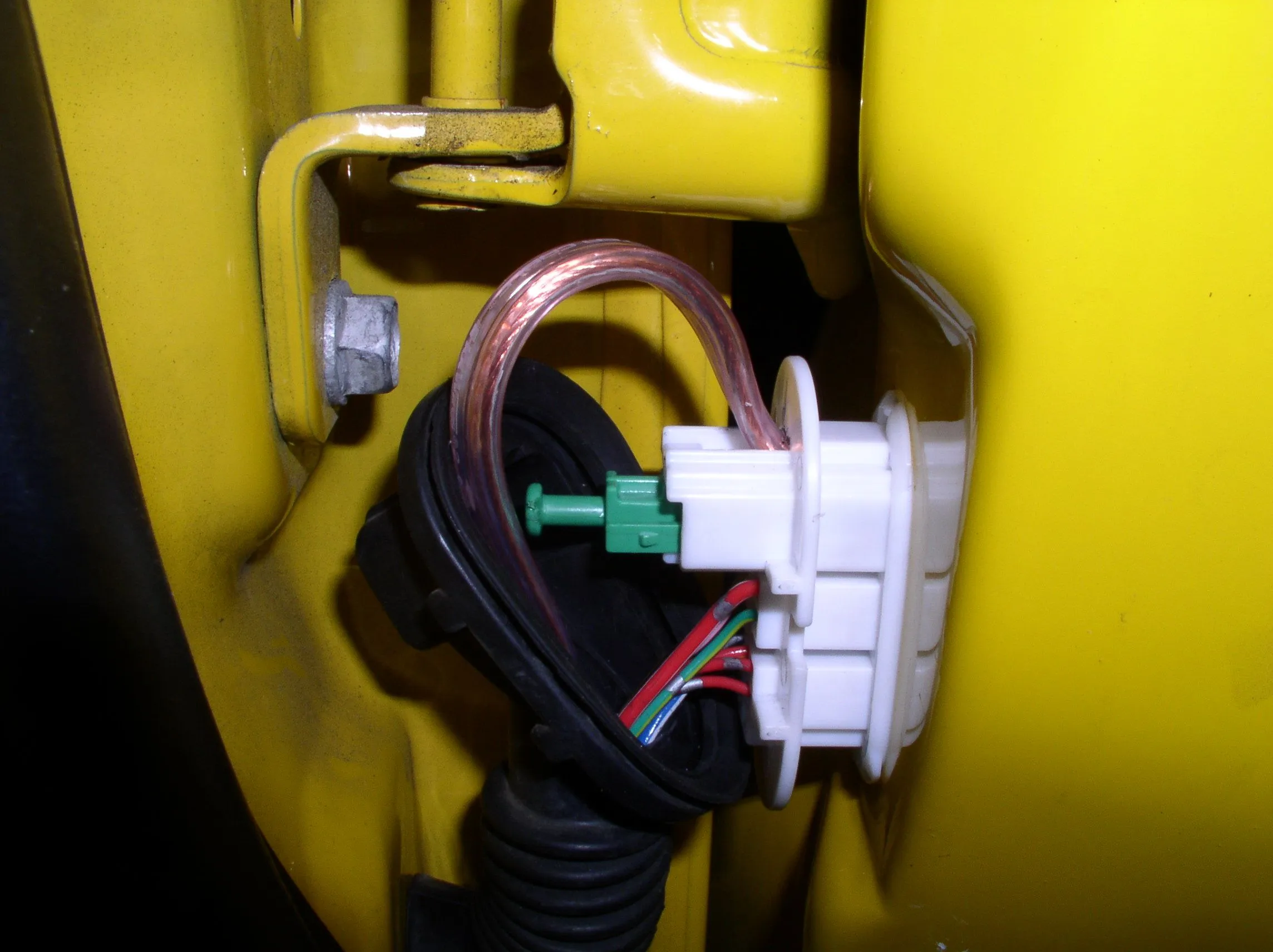

Well i just pulled 12 gauge into the rear doors and it was a snap. The pic below shows where i pulled the wire through the plug. Basically its right on top rather than through the small holes. The only problem with this way is that the rubber cover doesn't quite fit flush to the car. I haven't figured out how to remedy this yet, maybe seal it up with some silicone? I used Crankin Cable (I think that's what it's called) and it is some heavy duty s*** - makes Monster look like dental floss or something!

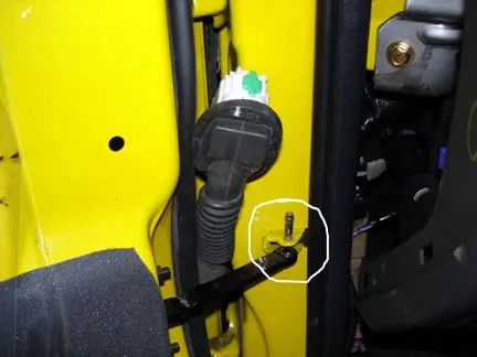

Just pulled the wires this weekend and it wasn't bad, took me about 2 hours for both doors. There were a couple more things that would help a lot if you took them off. One is the pin that holds the door-return thingy, it can simply be popped out by hammering unneath it, using moderate force. The door will open about 5-8 more degrees, which helps a lot giving the space is so tight. See attached photo.
Also, the panel to the very left of the dash can also be removed by inserting a flat screwdriver and pry it out, (shown at the right side of the photo) giving you acess inside the dash to help wiggle the wires or push the molex out.
My ONE warning about pulling the limiter-pin is that your doors will now have the possibility of coming into contact with your fender. so be VERY careful if you do choose to do this.
Good point, it was actually ok for me, the door was wide open and not touching anything...but should still be careful.
