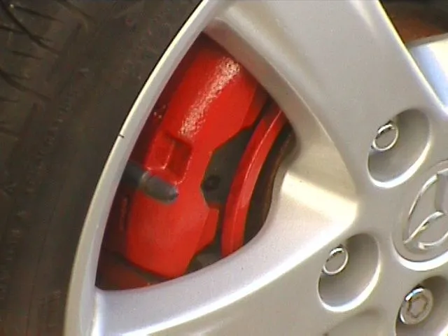

I went with the suggestions of some on here and went with red for my calipers. I purchased the kit from Meijer for $15.00 and was pleased with the turnout.
For some reason the pic in the last post showed the caliper as black. ?? Check out my web page for pics of the finished look.
pic was okay . . . good job. I like it. It definitely makes your car look nicer.

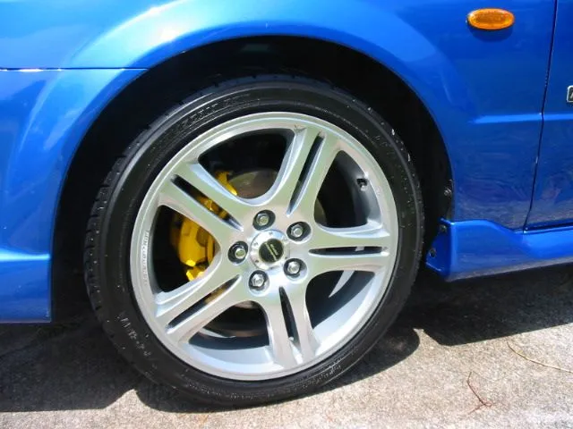

Well I went with a different color than most people here. I thought about doing red but way too many people are doing red so I went with yellow. I think it looks great on my mp3. Check it out
No doubt, MP3Architect. The yellow looks hot with the blue body color. Nice choice!
nice choice i would have chose the same if i had the laser blue colr, NICE!
