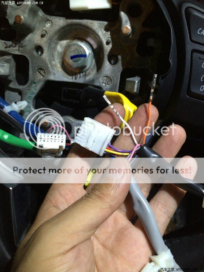

I could have completed 95% of this retrofit, but could not understand the last step which required wiring to +/- switch. Anyone could chime in and help which wire and where to do so? thanks advance

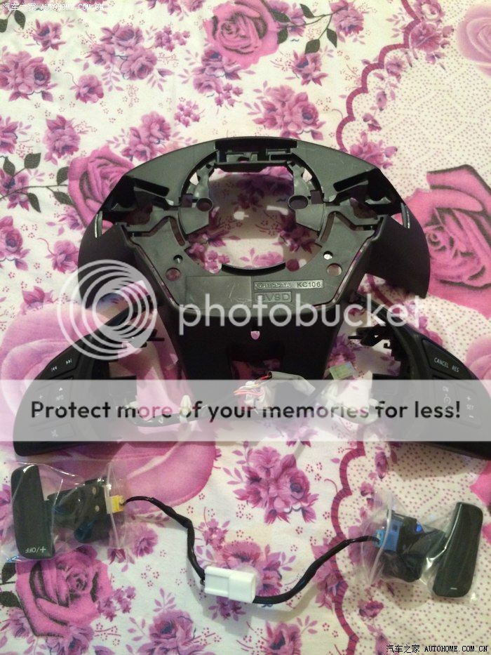

OEM MAZDA PADDLE-SHIFT KIT
You would need to purchase this oem kit from your local dealership, or from taobao.com (as what i did)

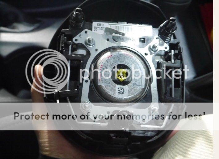

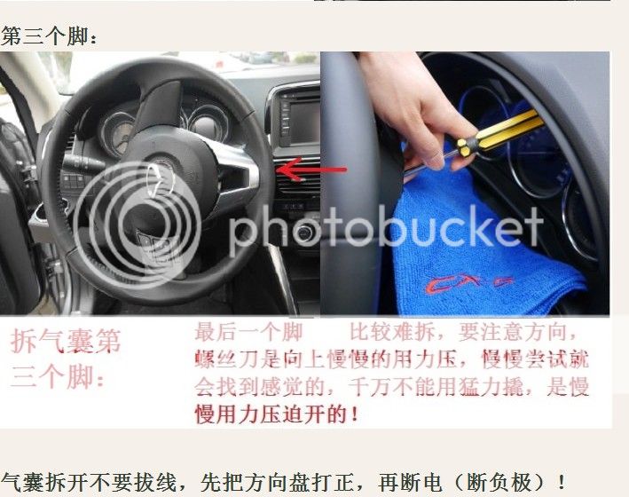

Locate 3 screws behind the wheel. This pic below will demonstrate

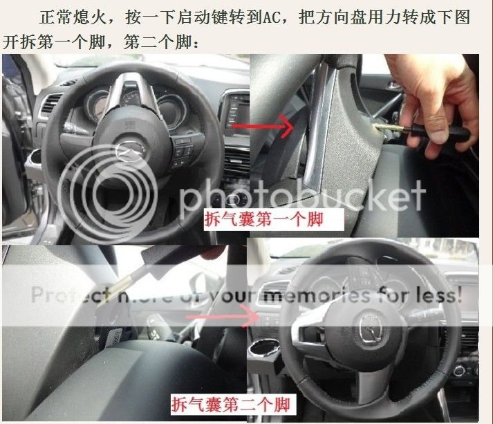

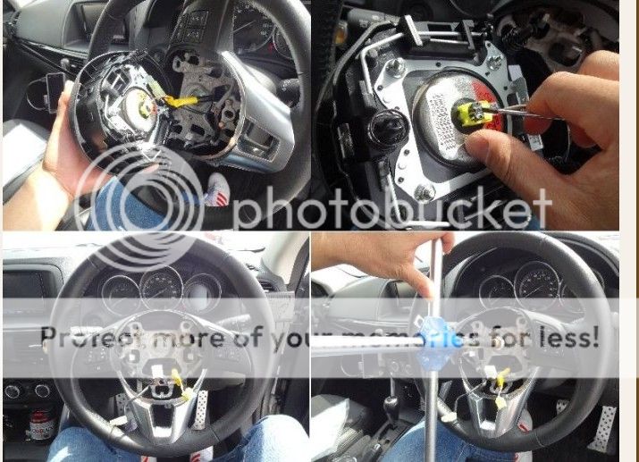

Turn-on engine and steer the wheel to these positions, this well help to remove the

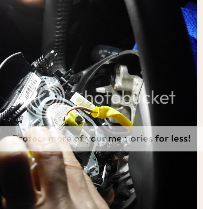

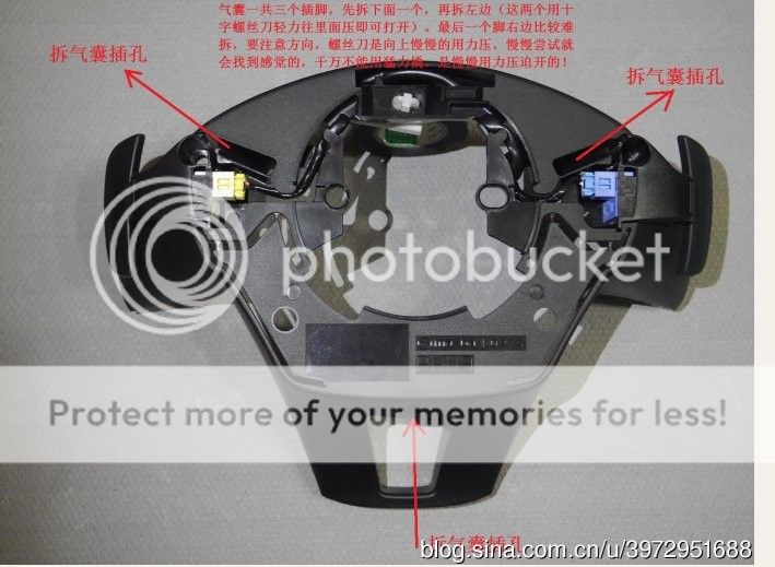

There are "springs" behind the airbag, we need to "unlock" the clip in-order-to remove airbag from the wheel, for details check-out pic below
DO NOT UNPLUG THE AIR-BAG FOR NOW

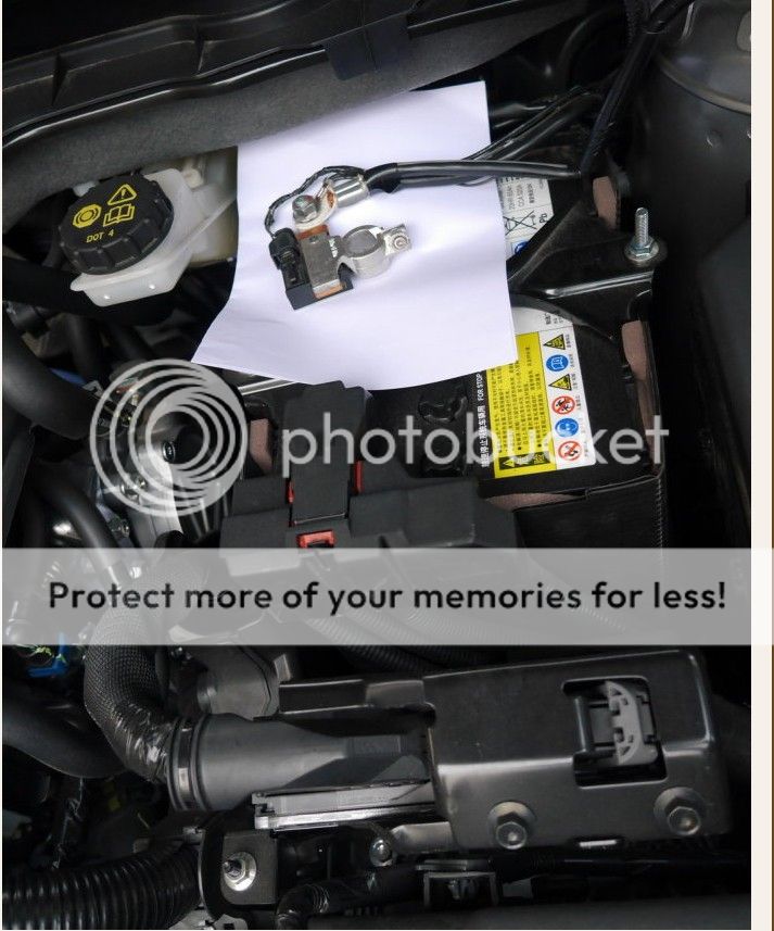

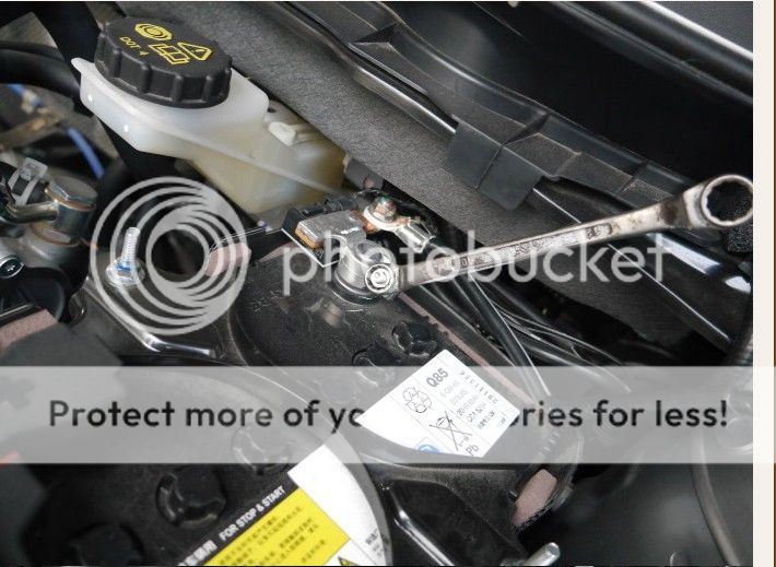

TAKE-OFF BATTERY
This is a very important step, we need to unplug the battery

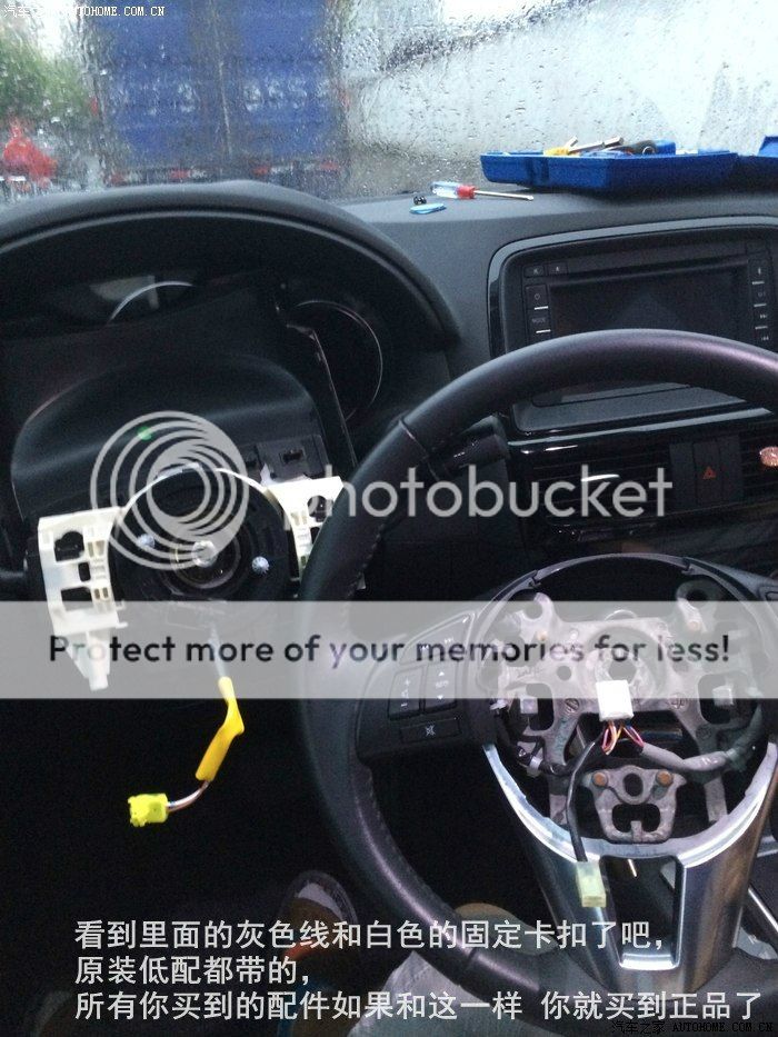

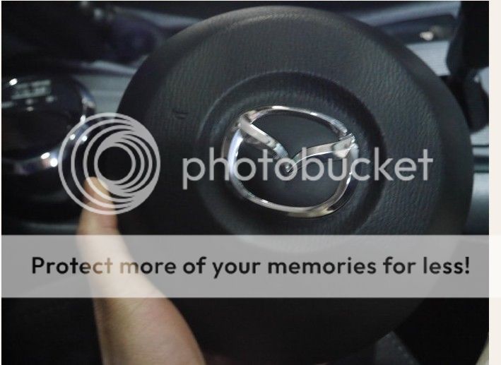

AIR-BAG REMOVAL
Stock part are ready to install paddleshift kit
Secure the air-bag in safe place and be gentle while handling it

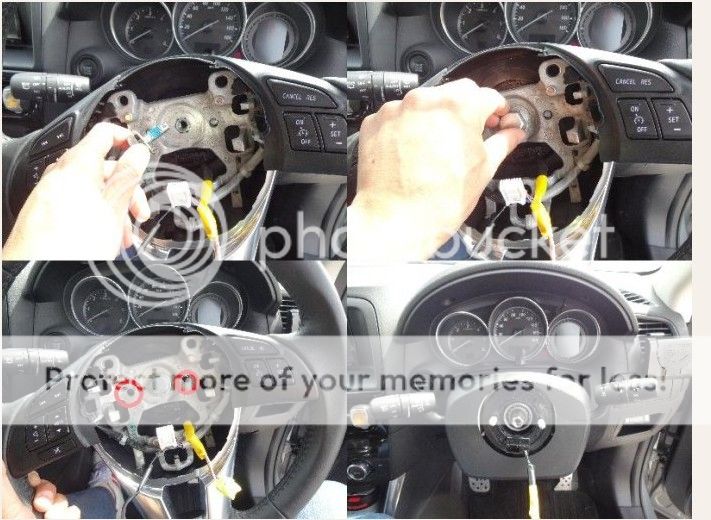

PADDLE SHIFT INSTALLATION
This is the paddle shift kit, comes with screws and wiring

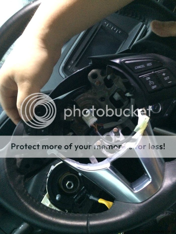

Step 5:
PADDLE SHIFT WIRING
5.1

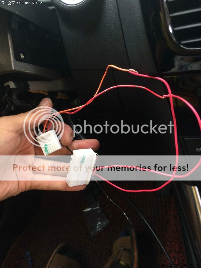

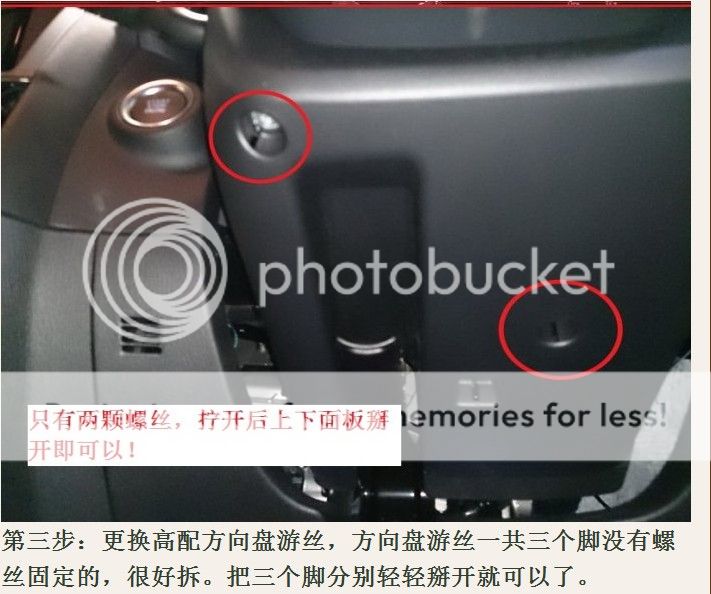

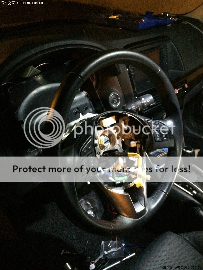

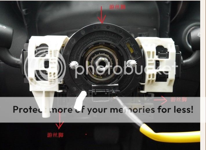

5.2 Take-off the steering column cover. This is required to access the wiring behind it

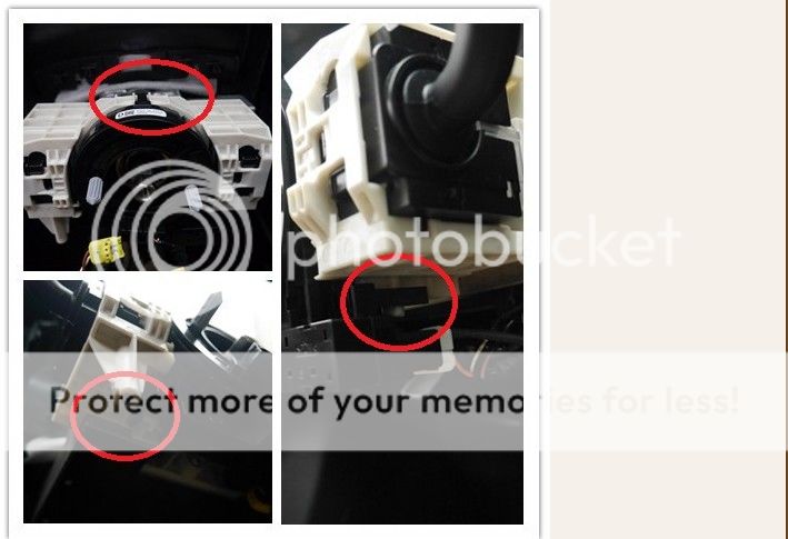

This shows the location of 2 plugs (left & right)

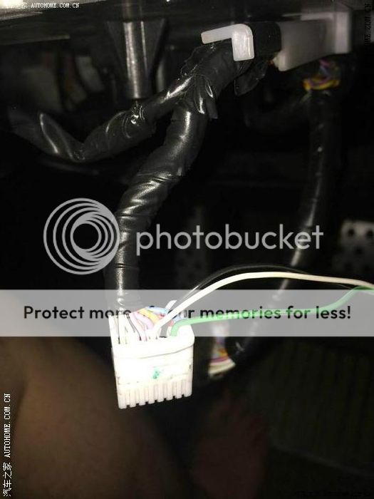

Closer-look

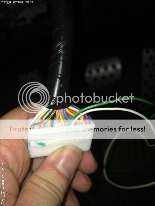

Wiring Diagram (this is the part i dont-know-how)
Plug "A"
Plug "B"
Wire
