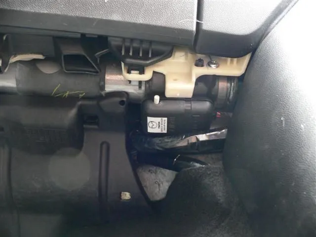

I did this install today. Many thanks to Edwin (TheMan) for the write-up. Very detailed and accurate. The only deviation I made from the write-up is the placement of the sensor. I stuck it to the bottom of the dash support bar with 3M heavy duty emblem double-stick. This placement allows adjustment of the sensitivity and visibility to the LED (with a mirror) without removing the passenger kick panel. I adjusted so a good thump with my fist on the windshield sets it off, but a lighter tap does not. This thing is really sensitive if you turn it all the way up. My garage radio (not even very loud) sets it off with the car in the driveway.
