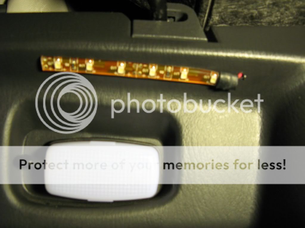

The VLED light strips do have wires attached, the ones in the picture.
I wish I had the technical experience to make the install cleaner and install a fuse but it'll do for now.

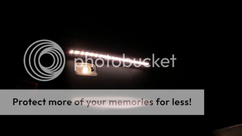

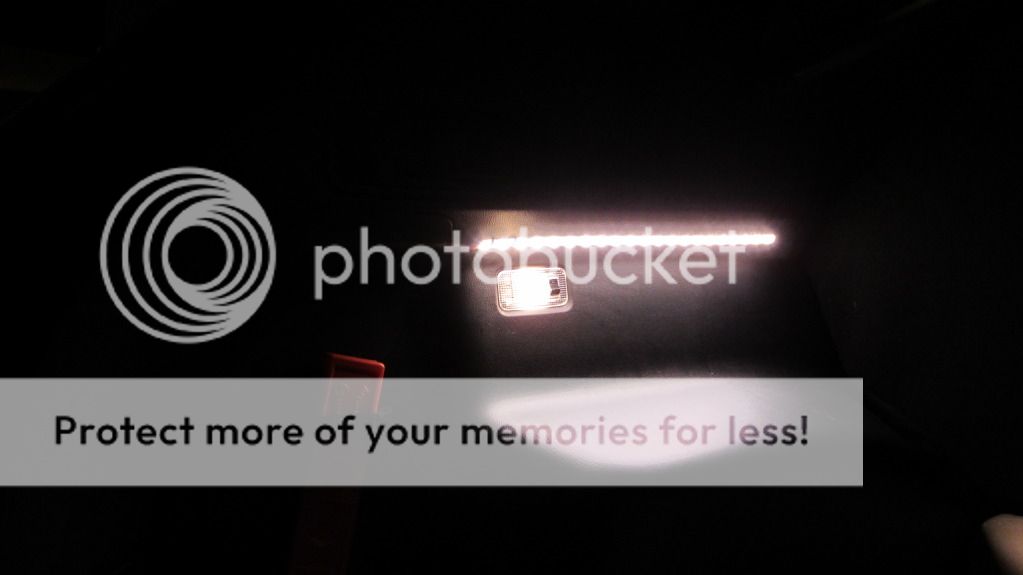

Finally got some time over the weekend to do this project. The lights make a ton of difference. I'm super happy with the result.
Final product. Taken with my cell phone with no other sources of light.
This is the best my phone could muster with the the standard cargo light. (hand)

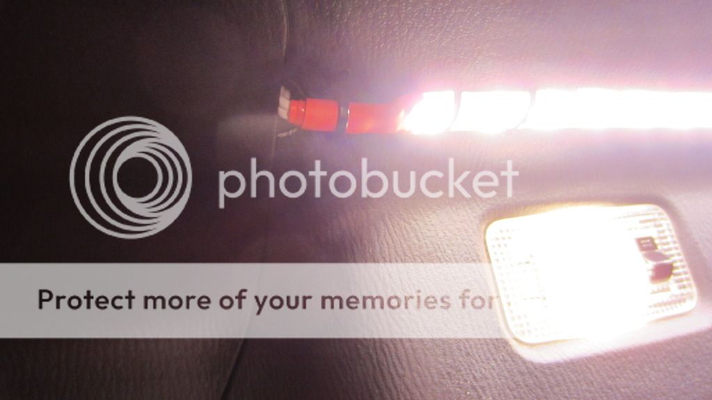

I did a similar thing today, but I have only done one side. It is wired into the existing boot light electrics (Trunk light for Americans ;) )
I only had some red heat shrink available, but I may change this :) The strip is adhesive but I have added a couple of cable ties to make sure it does not come loose. You would barely notice these, they are tiny.
This was fairly easy to do and I have fitted proper plugs and sockets internally to the wiring so removal will take seconds if required. I will perform the same mod to the other side when I get time because it makes a massive difference.
Note:- This is a waterproof strip of 12v 5050 warm white LEDS as sold by the metre on auction sites, cut to length. It gives out a lot more light than the pictures show but it was dark so the camera compensated! - I will take another piccy in the daylight with the power to the LED's off.
