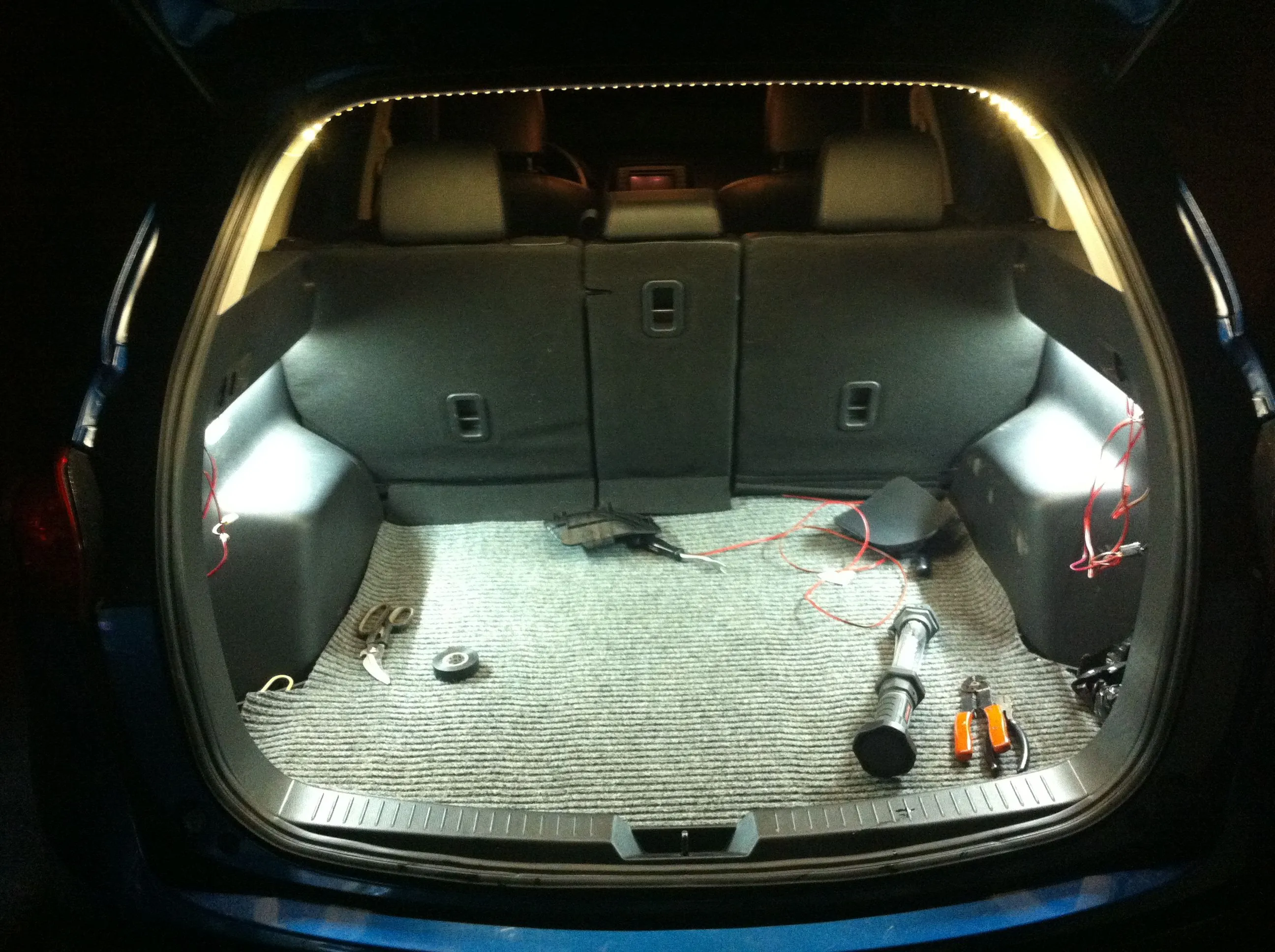

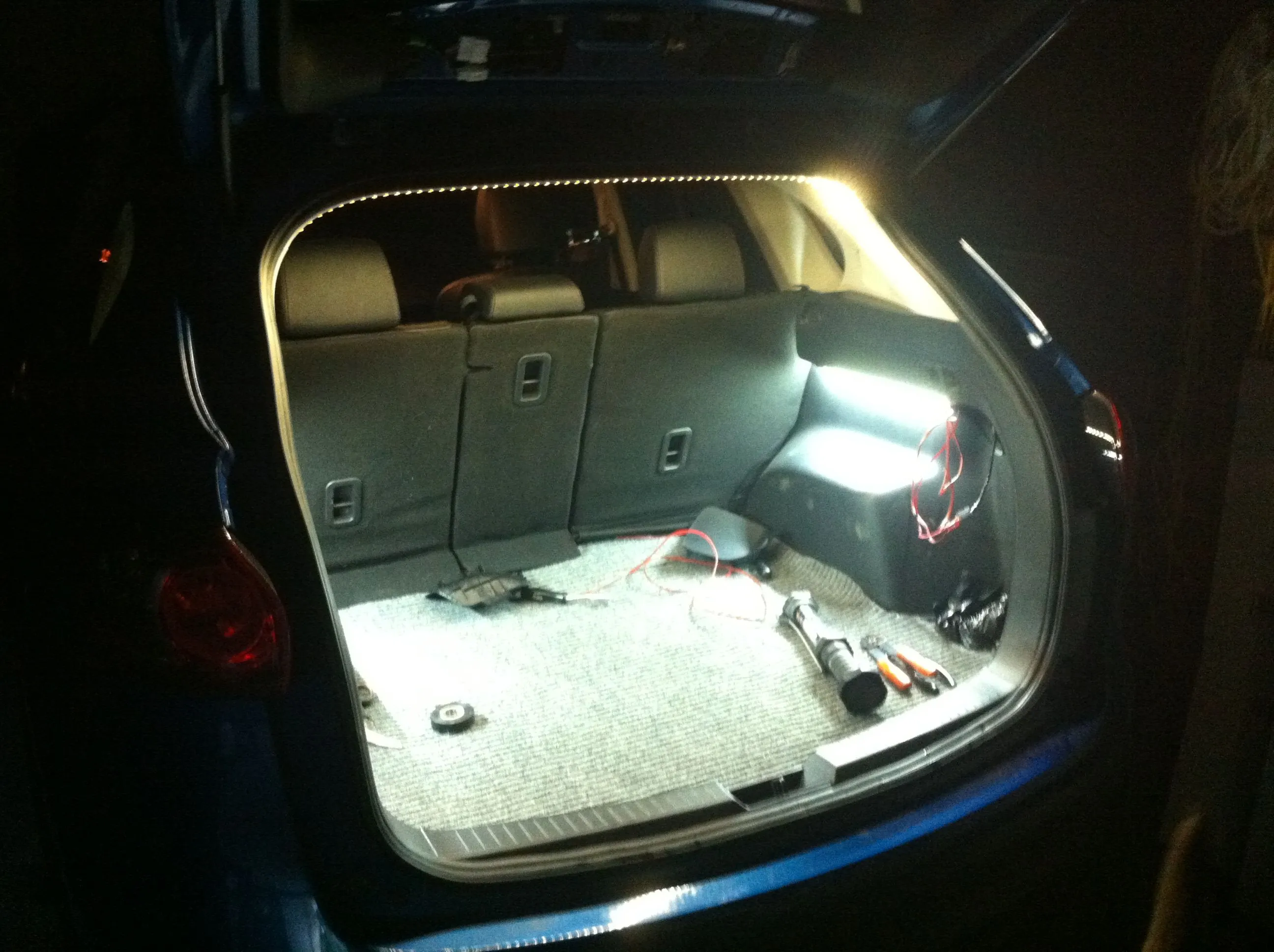

Hi again, So heres how it played out :
After squibscake suggestion about the ciggy power, got me thinking. After some research, decided to go with LED strips and a mercury tilt switch (couldnt find other tilt switch), added a fuse, for safety.
So, 1 39 inch LED strip for the roof, and 2 -19 inches LED strip on each side underneath the wheel well. No wires showing, they all go inside the acces panels.

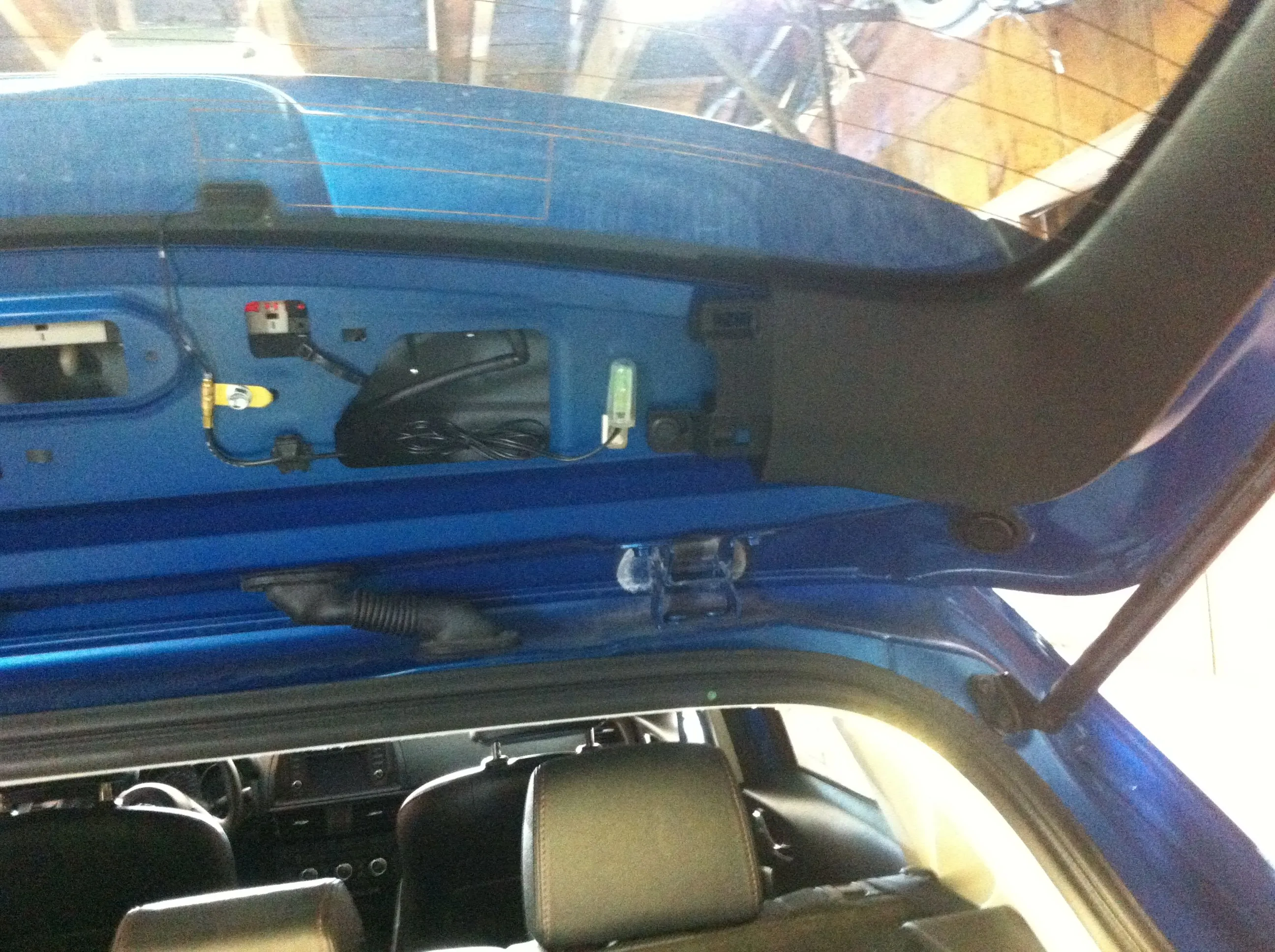

The Tilt switch is located in the liftgate on the right side, under the panel. The wire goes thru the rubber conduit with the windshield washer.
So aside from having to remove the liftgate panel, top part and right side (easy if you take your time), and pull on the roof and side material, nothing had to be remove.
Basically took one afternoon, working cautiously. Turned out even better than I expected. For under $100, Ill finally see something back there result of my old age .
Will make another mod.. add a rocker switch just in case I want to leave tbe liftgate open for a long period.

Here are some pics, if I can figure out how....
Thanks to all who helped on this, been on this for almost a year
Had to move the tilt switch on the right side because on top was too level and flashed when breaking.

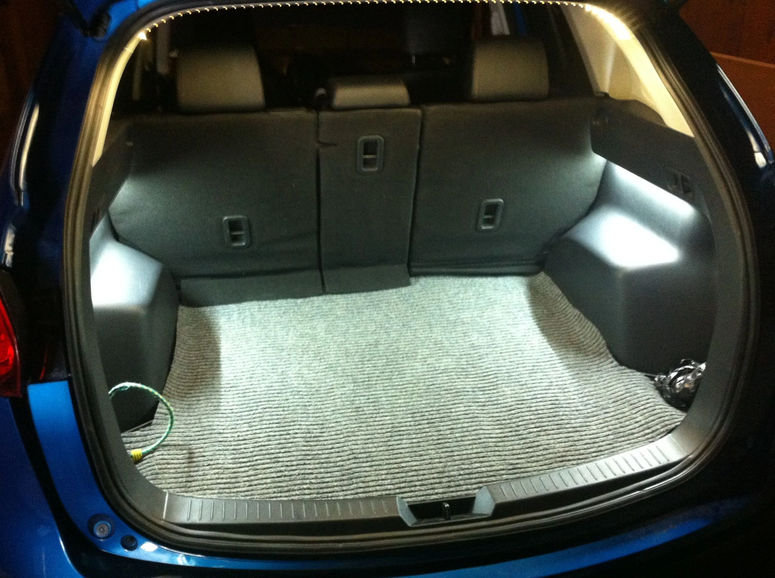

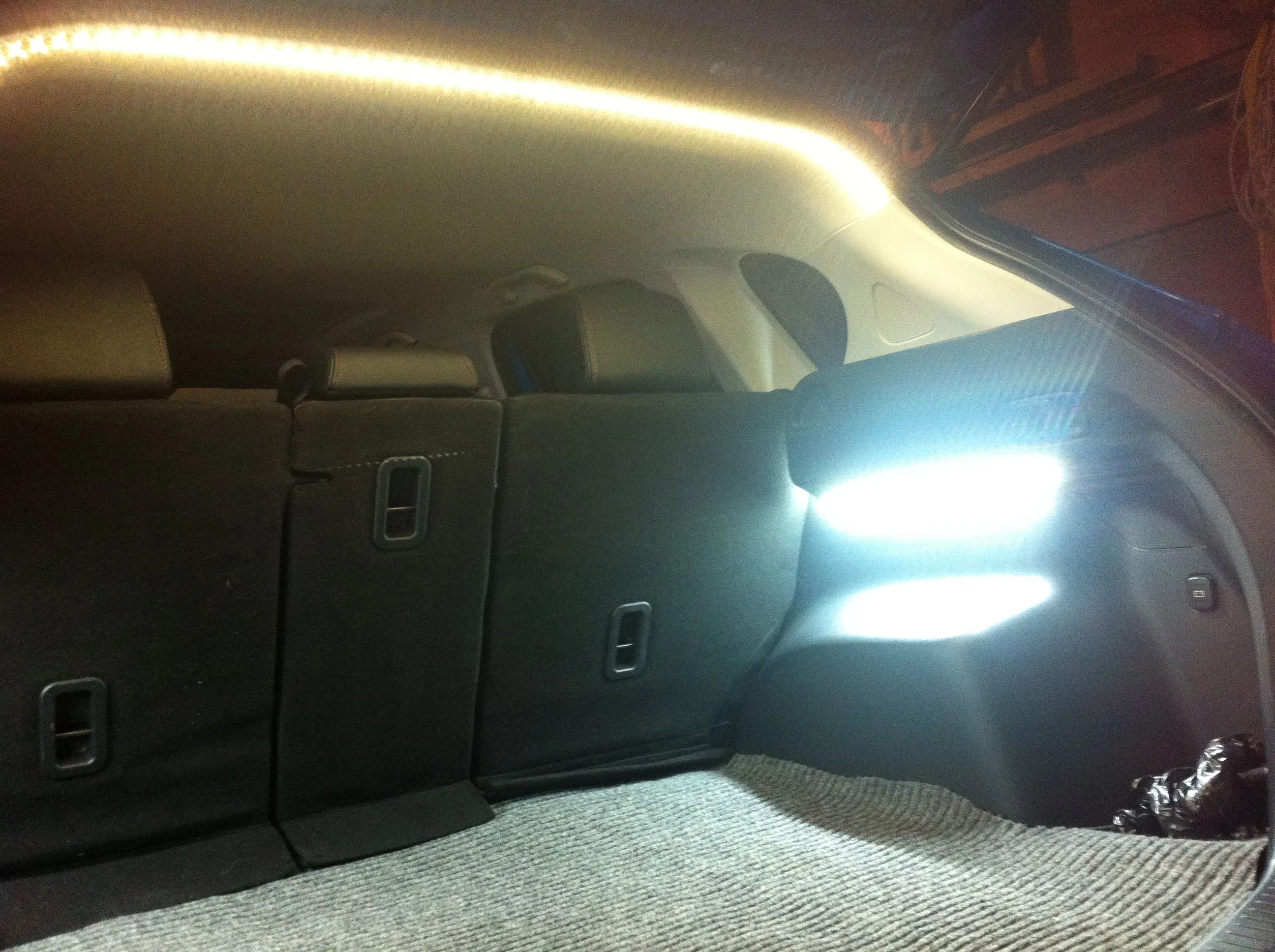

Last post about this I swear! I just can't stop marveling at how incredible this mod is, here's the final result in pitch black.
Nice job! Can you take some pictures with the light off so I can see how your setup looks?? Hard to see with the lights on.
The set-up is pretty simple, I mounted the tilt switch in the same location as CX-5FREESTYLE. There's a rat-nest of wires behind the outlet panel. I didn't bother trying to clean it, since everything is working fine I didn't want to jinx it by messing with it some more. Cable-management isn't my strong suit, my PC builds can prove that.
I did notice that two ends of two light strips were coming off, I used rubbing alcohol on the panels beforehand, but I fixed it by using https://www.amazon.com (commissions earned). It's very thin so the whole strip still lies flush with the body trim.
