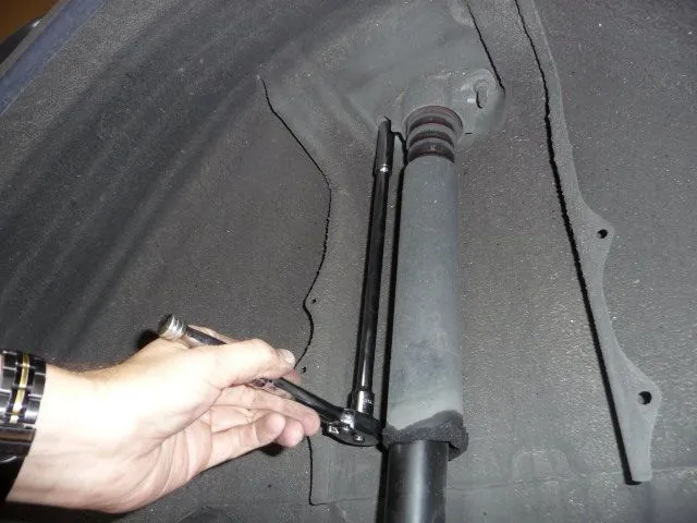

STEP 2 - (Remove Upper Shock Mounts)
  1. Using a 12mm socket and extension, remove the two upper shock mount nuts.
See STEP 2 picture.

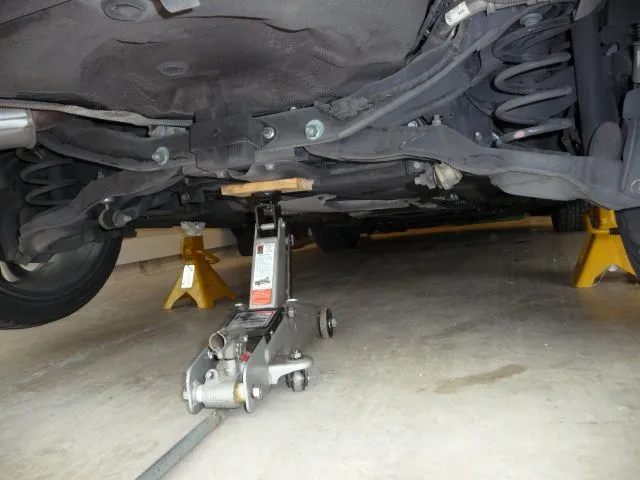

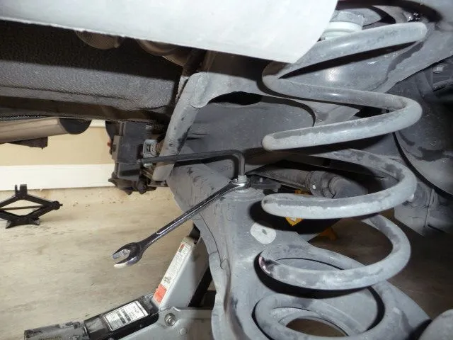

STEP 3 (Disconnect Rear Sway Bar)
  1. Break the top endlink nuts loose using a 13mm socket wrench.
  2. Using a 13mm box end wrench and 5mm allen wrench (to keep bolt from turning), remove both top nuts.
  3. Swing the sway bar down away from the control arms.
See STEP 3 picture.

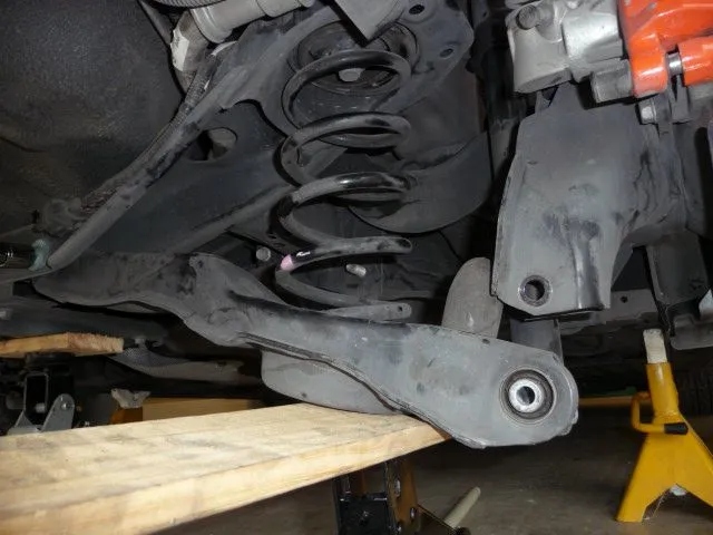

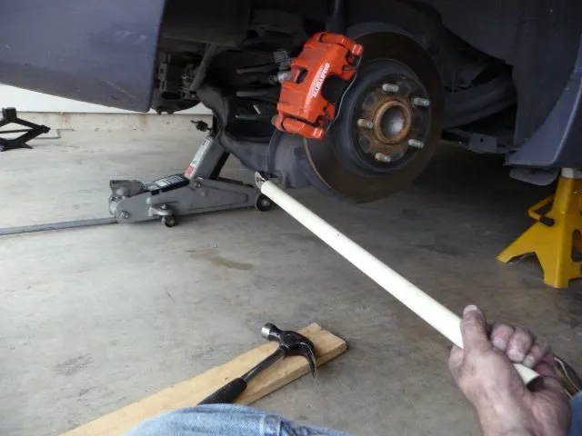

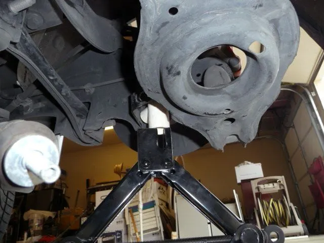

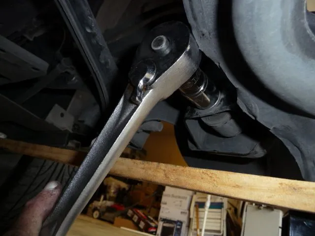

STEP 4 (Remove Springs)
  1. Break the control arm outer bolt loose using a 17MM socket and a cheater bar. This baby's on tight!
  2. Place the tire jack under the control arm to prevent the spring from flying out when the bolt is removed.
  3. Remove the bolt (lots of threads - will take a while).
  4. Lower the jack a little bit - the control arm will probably stick in the mount, so use a hammer to loosen it so it'll drop. Just keep hammering it while you lower the jack.
  5. Once the spring is no longer under compression, remove the jack and push the control arm all the way down.
  6. Remove the spring.
  7. Remove the upper spring seat rubber from the old spring and put it on the new spring.
  8. Repeat for other side.
See STEP 4a through STEP 4d pictures.

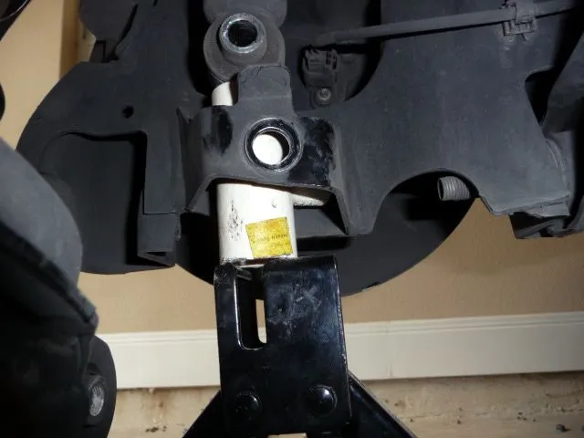

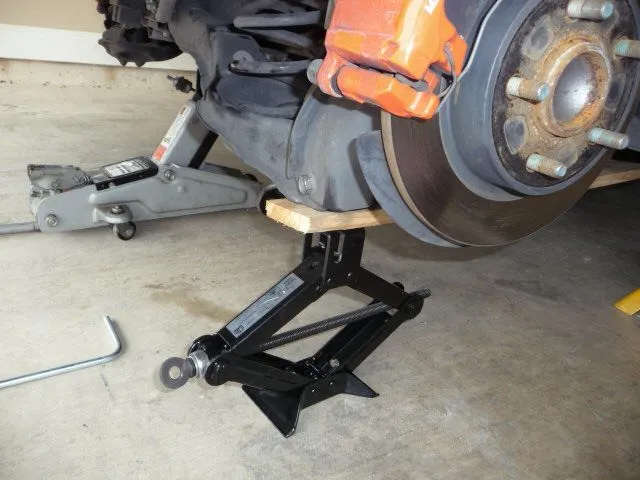

STEP 5 (Remove Shocks)
  1. Break the lower shock mounting bolt loose using a 17MM socket and a cheater bar. This one's a little harder to get leverage on, so prepare to do a little cussing. And you thought the control arm bolt was on tight...
  2. Once the bolt is sufficiently loose, at a minimum I would recommend sticking the jack under the shock to keep it from extending through the mounting hole once the bolt is removed. I didn't do this, and was having a lot of trouble getting the shock out, so let me tell you a little trick I used to make it easier....
  3. Stick a piece of PVC pipe about 3" long in between the jack and the bottom of the shock. You could also use a block of wood or any other material that is about 3" long and small enough to fit through the mounting plate.
  4. Remove the bolt completely and jack that puppy up until the bottom of the shock clears the mounting bracket (you young guys without back trouble can probably just stick the jack under the shock and leave it at that, but it was not easy for me to get that shock out without a little help).
  5. Either lift the shock by hand or knock it off the support, sliding it towards the front of the vehicle. Let it extend and remove it.
  6. Repeat for the other side.
See STEP 5a thru STEP 5c pictures.

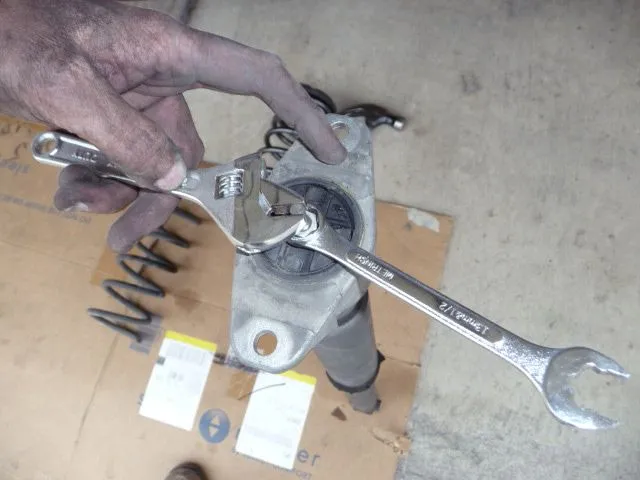

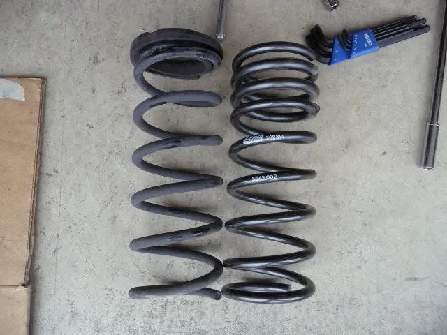

STEP 6 (Remove Upper shock mount and adjust new shocks)

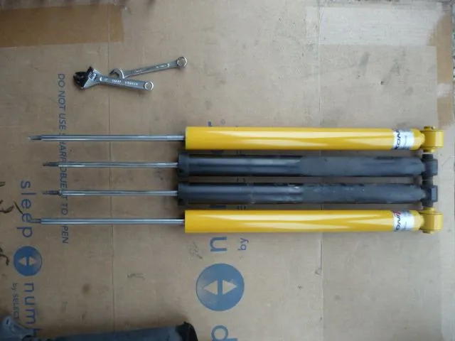

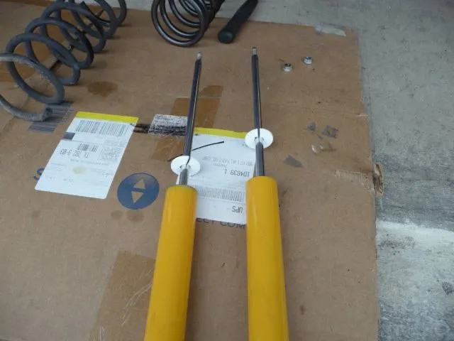

  1. Using a crescent wrench or locking pliers to keep the shock shaft from turning, use a 13mm box-end wrench to remove the upper shock mounting bolt. Unless you have a dial-type torque wrench, you might want to remember how hard it was to get off, so you can retorque appropriately when you do the new one (obviously, a socket type torque wrench is of no help with this particular nut).
  2. See STEP 6a picture for a comparison of the OEM shocks and the Konis.
  3. It's time to adjust the Konis. Your initial setting is most easily done off the vehicle. It's easiest if you have a vise, but you can also do what I did. Use a crescent wrench (or locking pliers) on the shaft end. Place the wrench on the ground (with the wrench attached to the shaft) and step on it to keep it from turning. Compress the shock all the way, then rotate until you feel the shock go down a little further (maybe 1/8 inch). This means the adjustment mechanism is engaged. Now while holding the shock fully compressed, rotate the shock fully clockwise (CLOCKWISE=FIRMER, COUNTER-CLOCKWISE=SOFTER). You will feel a little click when you get near the adjustment limit, then soon after you will encounter resistance. Do NOT try to force it more. The shock does not click at intervals - it only has a little click at each end of travel. Now release the shock without turning it just to see if it rebounds very slowly (if you did it right, it should).
  4. Recompress the shock (you should still be able to engage the mechanism if you didn't twist the shock) and rotate the shock clockwise until you reach your desired setting. The total adjustment range is about 2.5 turns, so I set mine to a little over one turn from fully stiff.
  5. Release the shock to disengage the mechanism.
  6. Repeat for the other shock. The shock do NOT behave identically, so once you have a rebound rate that you like for the first shock, adjust the other to MATCH it. Compress both shocks and let them fully extend simultaneously, and keep adjusting one or the other until they both extend at the same rate.
  7. Once they are adjusted, slide the white ring over the shaft and put the top mount back on. Using the Koni-supplied nuts ], tighten the first nut to 37 ft-lb (or good 'n tight if you don't have the dial0type torque wrench), then add the jam nut and tighten it as well.
See STEP 6a thru STEP 6c pictures.
