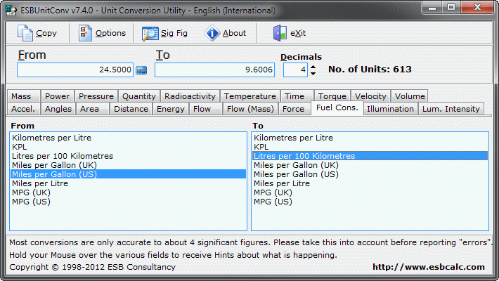

You will then adjust the Max Boost Pressure (kPa) to the max you want the boost to be at (in killopascals NOT psi) when your boost knob is turned all the way up. If you don't have a PSI to kPa conversion utility handy, go ahead and download this fee utility from ESB. It is the best!:
http://www.esbconsult.com/esbcalc/esbunitconv.html
Just use the Pressure tab to convert from PSI to Killopascals.

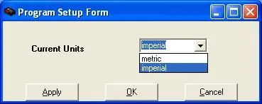

The Haltech now has imperial units for those of you wanting to display boost pressure in PSI, and Temperature in Farenhieht. Go to the setup menu, and then choose Program Setup. Choose either imperial, or metric:
