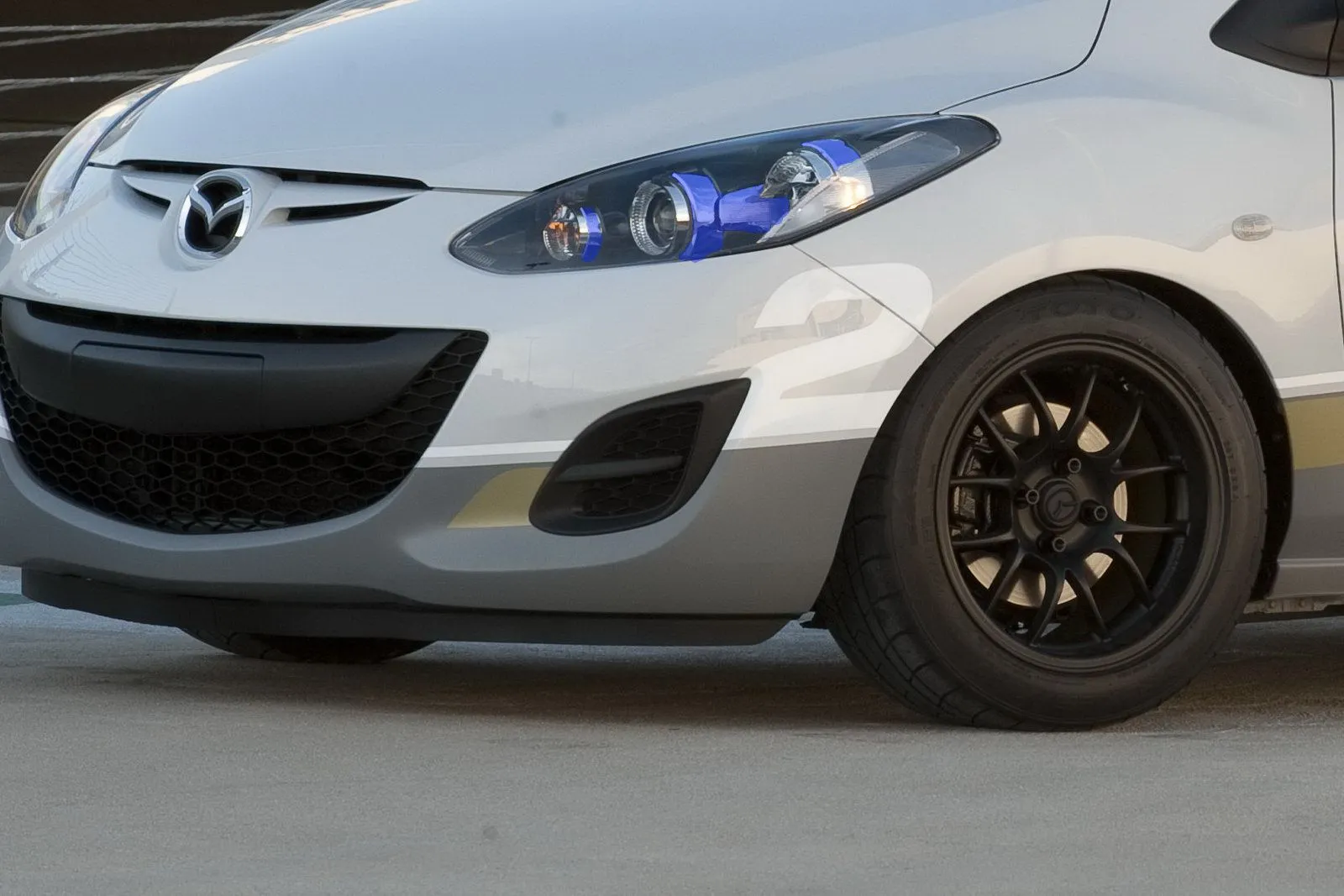

So, I kinda suck with photoshopping (gimp, in this case), but here is a quick and dirty of what I'm thinking of doing with these headlights:
attachment.php
I'm still very much undecided on what I'm doing, but I will be of course avoiding the reflectors, but painting the shrouds either a metallic blue, or smoked out. I plan to vary it somehow based on the sections of the shrouds. Let me know what you guys think.
Oh, and I am also planning on a triple LED halo setup. I'll be rocking the bug eyes hardcore.

You should really look at swapping out those projectors for some xenon ones, maybe even some bixenon ones. Once you get the lights apart and see what projector is in there, you can get an idea of what would fit and what might work. It would be well worth the work over the halogen projectors.
