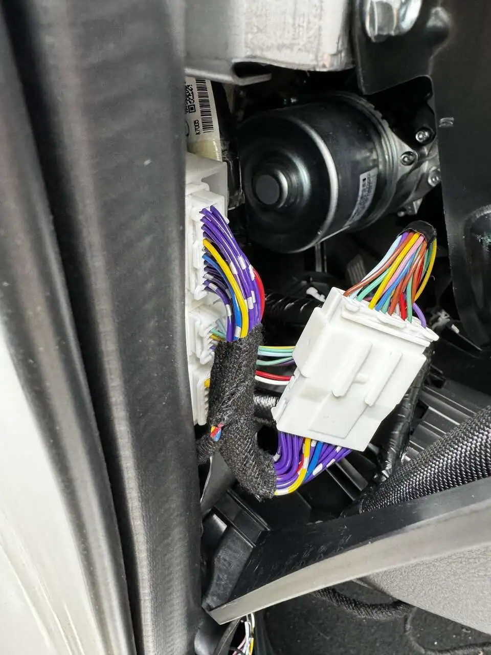

  5. In the US version, the wiring harness is actually on the driver side about the fuse box and behind the trunk release button area. You’ll need to partially disassemble the lower dash. This requires removal or two screws and a few trim pieces.
  6. You’ll likely get an error during your initial on sequence. Turn the vehicle off. With you in the driver’s seat, close the door, turn the vehicle on, button your seat belt. Disengage the parking brake. This should resolve any errors you may have. - this is rather alarming at first but it works.

IMG_4486.jpegBehind Driver Side Dash Connection

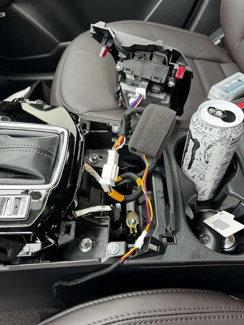

IMG_4488.jpegCenter Console Connection

View attachment 325551Behind Driver Side Dash Connection
View attachment 325552Center Console Connection
