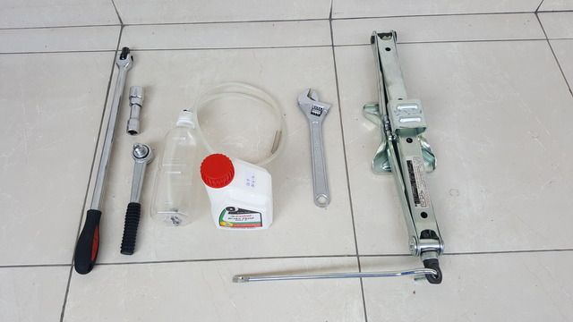

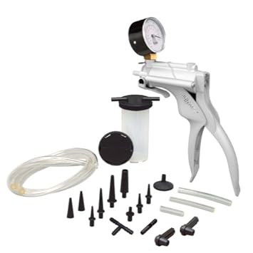

Tools & Equipment that i have used to perform this job are Standard Jack & ( Jack stand i did not have these laying around ) But if you do have it please use it for safety, Breaker bar with 21mm socket , 10mm ratchet spanner (I did not bring my spanner this time so i replaced it with 3/4 ratchet with 10mm socket & Adjustable spanner), Suction tool / equivalent , fluid catcher bottle and old clean rag.

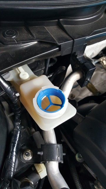

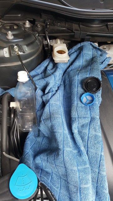

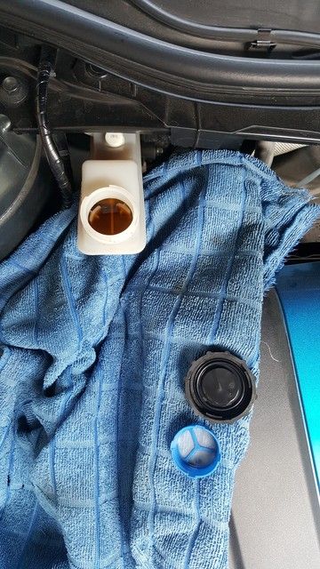

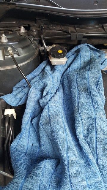

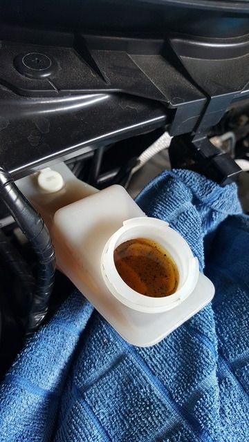

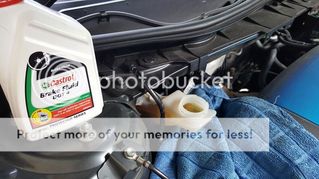

Prior doing the job , please make sure the vehicle is Cooled down , Put the car in P mode with hand brake down , Open the vehicle bonnet , Place the rag below the Brake fluid reservoir, Locate and open brake fluid reservoir cap and using suction tool / equivalent to extract some old brake fluid out from the reservoir and placed it in the brake fluid catcher bottle like shown below. Remember to fill the brake fluid back in the reservoir with fresh brake fluid till at the full mark .

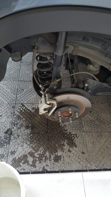

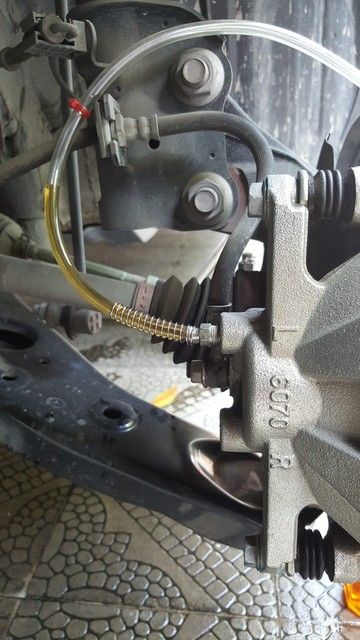

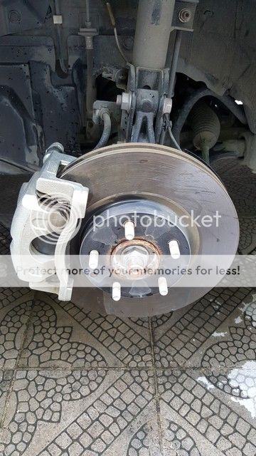

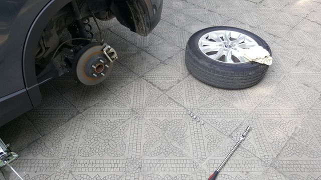

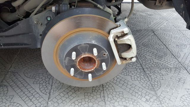

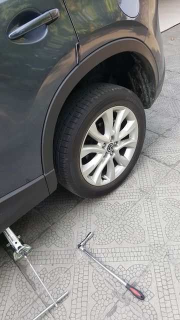

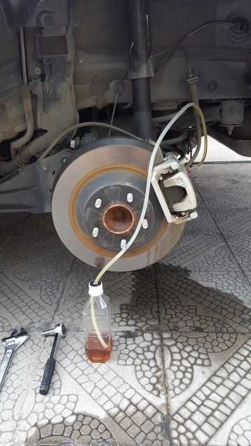

Step 1 : Start from Passenger side rear . Remove wheel. Using the breaker bar with 21mm socket, Jack up the vehicle , Put jack stand. While at it i decide to give a clean scrub on the calipers.

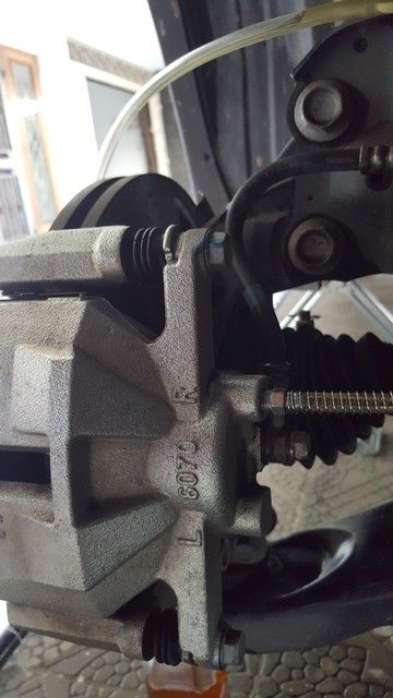

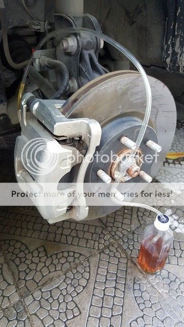

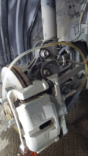

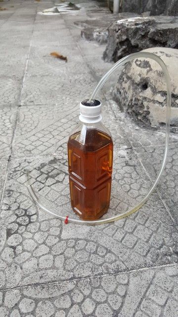

Step 2 : Using 10mm spanner to crack loose the nipple of the brake caliper, attach the fluid catcher bottle tool to the nipple , in the car push the brake pedal 5 times or more . Refill up the brake fluid in the bottle reservoir. Repeat this step until you can see Clean brake fluid from the fluid catcher tubing and make sure there are no more air bubbles before tightening back the nipple. Re install the Passenger side rear wheel assembly.

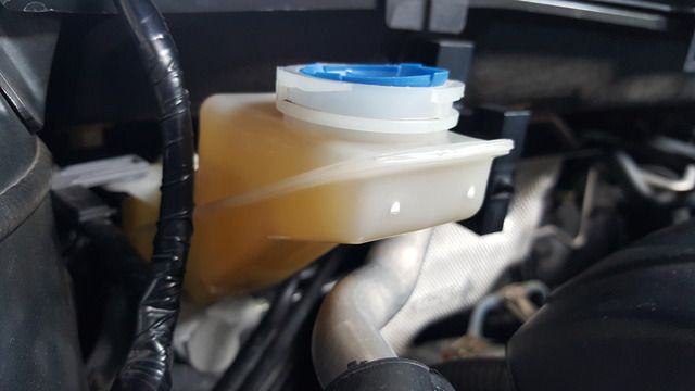

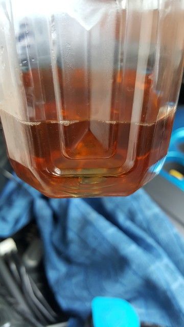

Check the brake fluid reservoir & refill . Mine was like this . See the particle and dirt that needed to be flushed out .

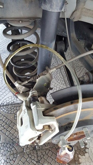

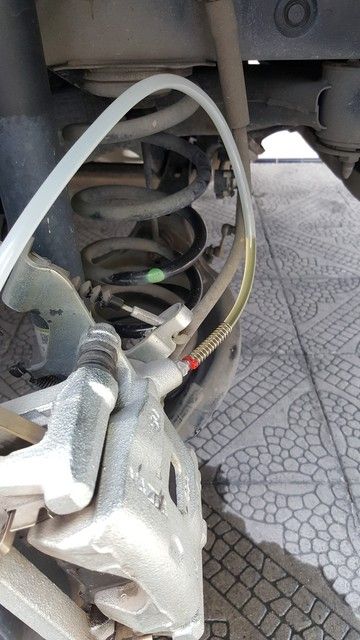

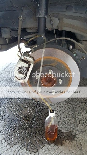

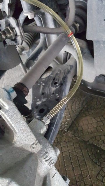

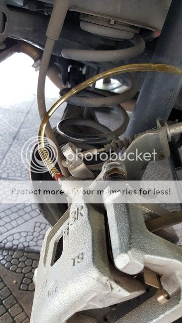

Step 3 : Working on Driver side rear . Remove wheel . Using 10mm spanner to crack loose the nipple of the brake caliper, attach the fluid catcher bottle tool to the nipple , in the car push the brake pedal 5 times or more . Refill up the brake fluid in the bottle reservoir. Repeat this step until you can see fresh brake fluid from the brake fluid catcher tubing and make sure there are no more air bubbles before tightening back the nipple. Re install Driver side rear wheel.

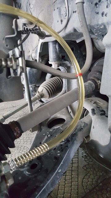

Example below are the bubbles you have to get out off the brake system.

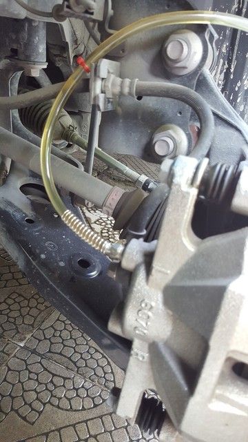

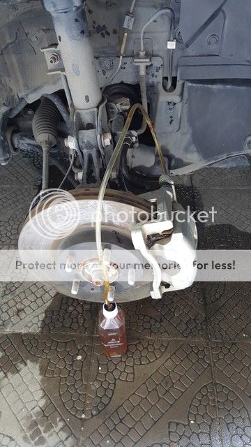

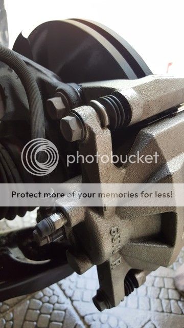

Step 4 : Working on Passenger side front . Remove wheel . Using 10mm spanner to crack loose the nipple of the brake caliper, attach the fluid catcher bottle tool to the nipple , in the car push the brake pedal 5 times or more . Refill up the brake fluid in the bottle reservoir. Repeat this step until you can see fresh brake fluid from the brake fluid catcher tubing and make sure there are no more air bubbles before tightening back the nipple. Re install Passenger side front wheel.
Step 5 : Working on Driver side front . Remove wheel . Using 10mm spanner to crack loose the nipple of the brake caliper, attach the fluid catcher bottle tool to the nipple , in the car push the brake pedal 5 times or more . Refill up the brake fluid in the bottle reservoir. Repeat this step until you can see fresh brake fluid from the brake fluid catcher tubing and make sure there are no more air bubbles before tightening back the nipple. Re install Driver side front wheel.

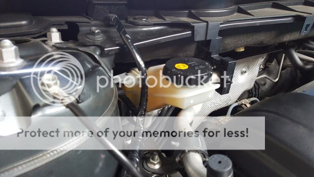

Step 6 : In the engine bay clean the brake fluid reservoir and fill it up till the full mark and close the filler cap. Press pedal couple more times . Start the vehicle make sure no ABS warning light are on in the dash .

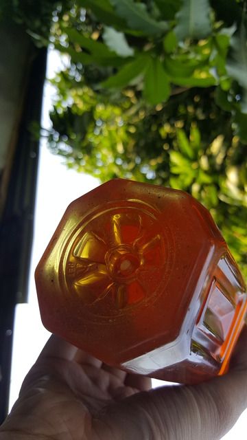

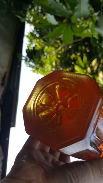

Conclusion If the job were performed right and in the correct manner the brake pedal and braking power should feel more responsive. Here are the result from 20000kms of 3 years ownership under normal driving condition. The old brake fluid were so bad in color , there's a lot of dirt particle in it as shown below .

The end of the tube, has to be submersed in fluid at all times, right?

Opening the nipple at the caliper and then pushing the brake is not the best way to do this, you are allowing air to enter the system. You should have someone push the brake and then open the nipple. The fluid was very dirty for only 20k kms (14k miles or so)! (boom01)
Yes the other way of doing this is by 2 person job but in my case had only 1 person . If there's a bubble left over in the system you will be able to see it before tightening back the nipple thus you will have to repeat the process until it is clear before tightening the nipple.

Sometimes air can be drawn in through the threads of the nipples if its loosened too much and you might not see it.
I have already purchased one of these, but I have not used it yet. But I will do it next time, when I work on my brakes.
Please let us know how the suction method works. A how -to would be great.

Also noticing the dirt particles in the master cylinder, probably would've sucked the fluid out of there to get the dirt so as not to draw it through the ABS unit. ABS units typically don't handle dirt well, some have thrown a code because of it. Good pics, though.
Where can I purchase a replacement the blue filter? I had a shop perform a fluid flush about 2 years ago...its gone.
The best place to find that blue filter is at Mazda dealer. But I suspect you have to get the whole brake fluid reservoir which includes the filter. You may try salvage yard but again you may have to get the whole brake fluid reservoir and master cylinder.
How do you get that blue filter out of the reservoir? I've bled my brakes 3 times so far. But I can never get that filter out to remove the old fluid first. On past cars I could just lift it out. This one is in the reservoir and is snapped in on the four corners. I tried a sponge but just could only get one up at a time.
I gently pulled mine out with needle nose pliers.
Opening the nipple at the caliper and then pushing the brake is not the best way to do this, you are allowing air to enter the system. You should have someone push the brake and then open the nipple. (boom01)
Not entirely true for two reasons.
1. The placement of the end of the tubing under the level of old brake fluid in the bottle does not allow the air to be sucked in and
2. secondly, there is a pressure difference (height difference) between the car's brake fluid reservoir and the wheel nipple so the tendency of the brake fluid is to flow down towards to the nipple, very slowly by gravity.
The only thing that I would do differently is to attach the end of the plastic pipe to the nipple before cracking the nipple itself open so that there is absolutely no chance of air getting in (even if you did not have gravity to help you). I have a triple safe method and that is the tube that is immersed in the plastic bottle has also a one way valve attached to it and it is under the brake fluid level (and of course the gravity is on your side too). What I have noticed in practice is that the moment you crack open the nipple, the brake fluid starts flowing down that pipe slowly. You could literally do gravity assisted brake fluid change without pumping the pedals but it would take a long time. Just my two cents.

In theory this suction method makes most sense and is the safest but in practice there is often air leak around the plastic tubing attached to the nipple and that appears as bubbles in the plastic draining tube causing a lot of confusion. Is it air bubbles in the brake system or is it just the air being sucked in due to bad seal between the plastic tube and the nipple? One way of minimising that would be to apply low suction so that outside air does not get sucked in at the nipple tip.
