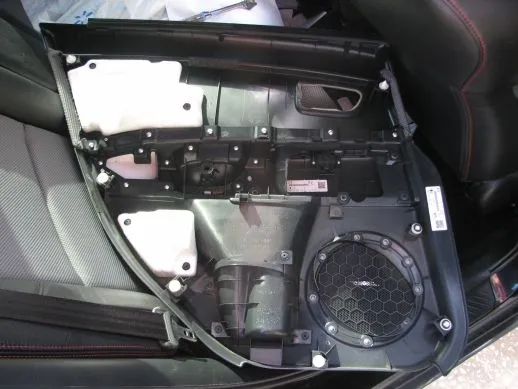

SO, with that brief background, lets look at the MS3 speaker enclosures
Now, I have yet to figure out how to embed a photo, and no one has told me, so, sort thru the attachments (moon)
pic1

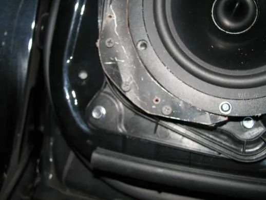

this is the inside of our door
there is NOTHING stiff or sealed about it. the folks at Cerwin-vega do not make sub enclosures from thin sheetmetal and injection molded plastic
it is the farthest thing from ideal.

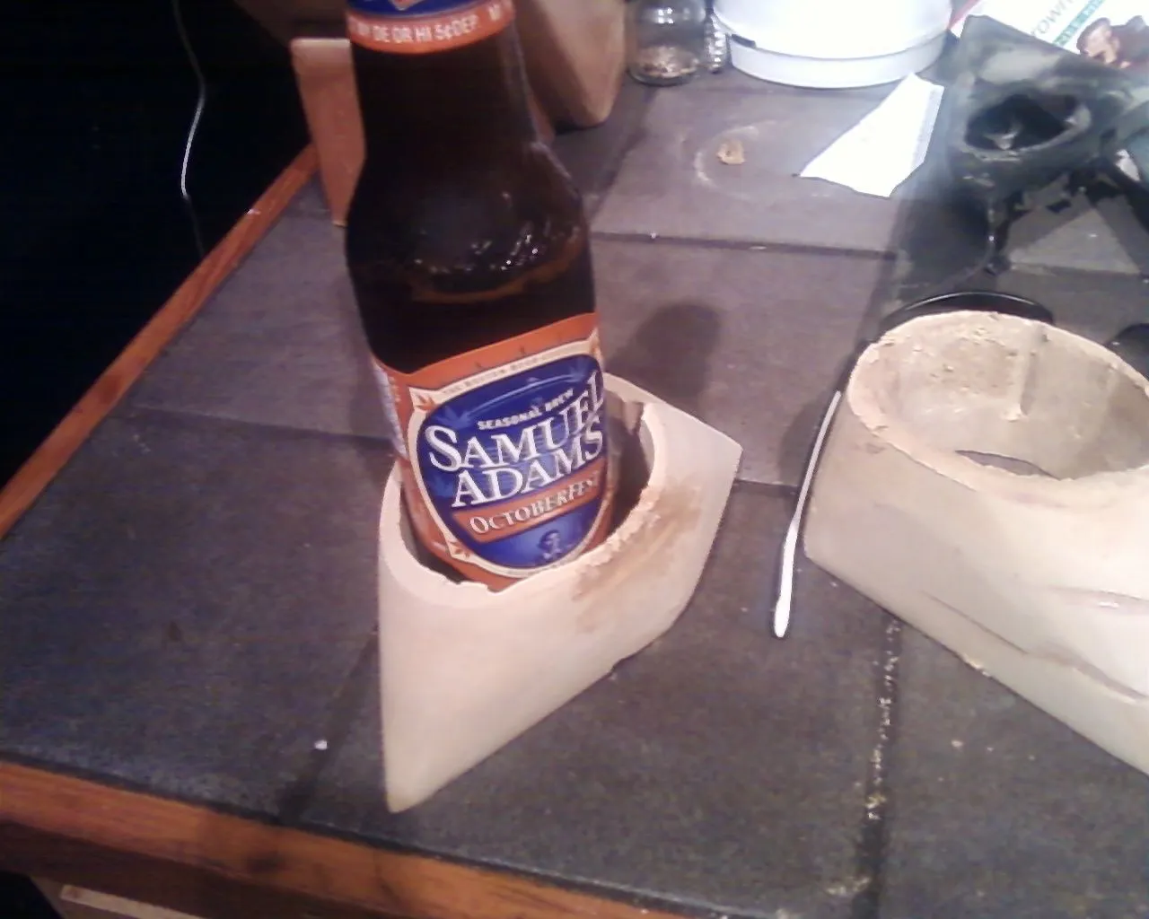

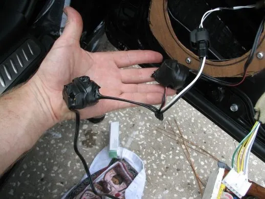

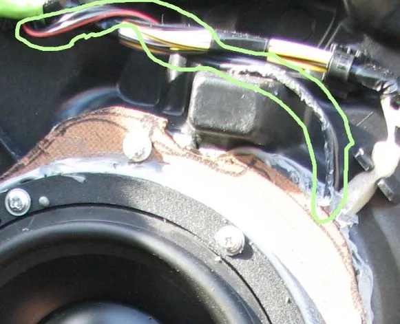

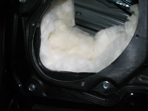

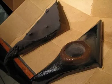

MITIGATION
nothing is perfect and bad things can be made better
pic 2 and 3

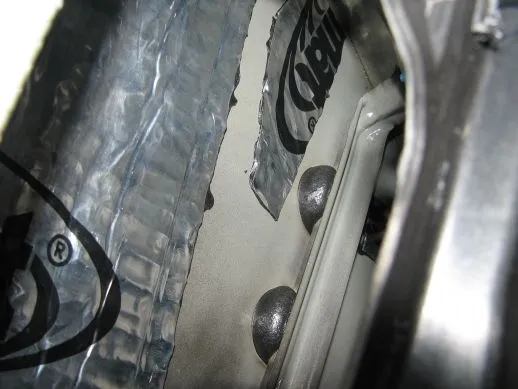

deaden vibration and damp waves
now we have a crappy enclosure that at least does not buzz and vibrate like it did before. we can now slam it with rear waves, without a ton of passive radiation and stray non-musical sounds
we move on.

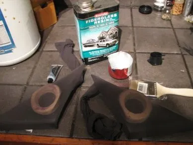

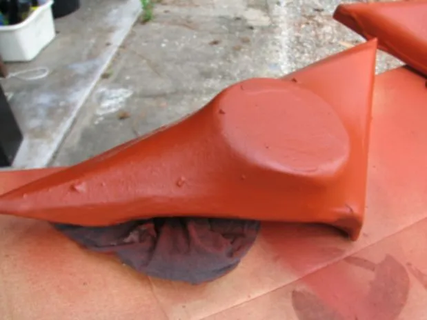

front stage
Humans are VERY sensitive to the physical location of sound, and much more so when the freq is higher, the phase of the sound matters most with lower freq
this is why the rear door speakers are not much help, they are behind you. Why tweets in the rear sails are useless, they distract your brain terribly
set it up like your home stereo. a pair, of well balanced full range speakers equidistant, and level with your ears. Placed in a room with non reflective walls.
ha ha
Oops, we are in a car. front speakers by our feet. left tweet 18 inches away, right is 4 feet away a large amount of the surface is glass, volume is littered with reflective/absorbitive objects
what to do?

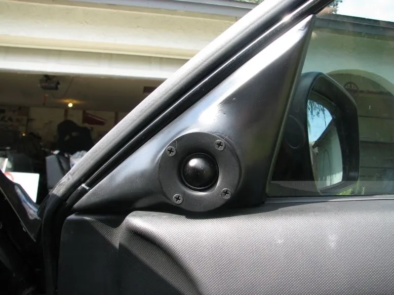

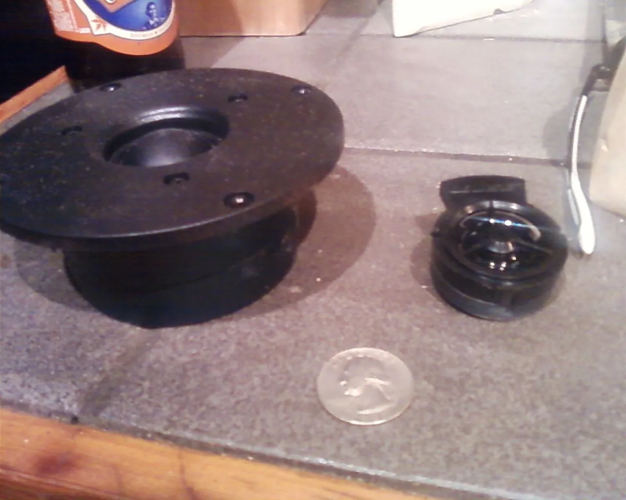

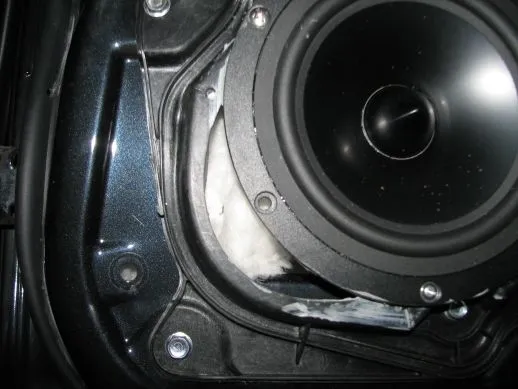

use the tweets as much as you can. (lower xover point) this raises the frontstage up to be more level with your ears. use the rears at a lower freq and lower volume, essentially just a bit of fill
this requires a real good tweeter that can take some power, we added power with the new amp, AND funneled more of the total portion of load to it by lowering the xover point
pic4,5,6,7.8

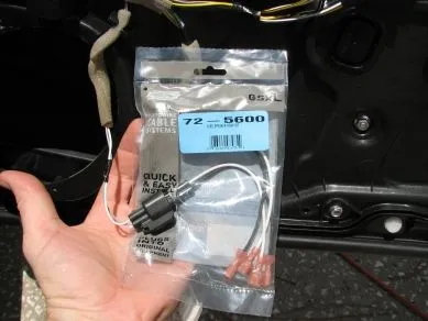

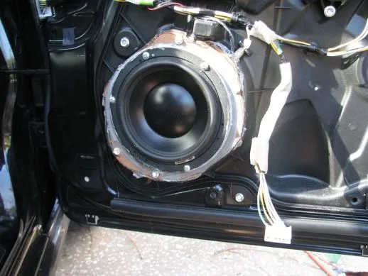

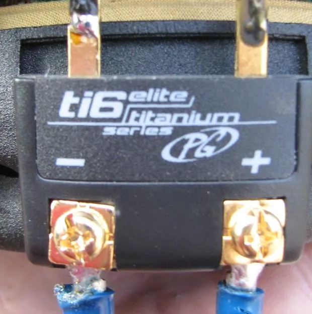

ok now, punch up the front door with the majority of the power handling capability and clean tight reproduction
IE spend money
next pics
this is a nice unit, there are others
use componets, avoid coaxials, they put high freqs out down low near your feet

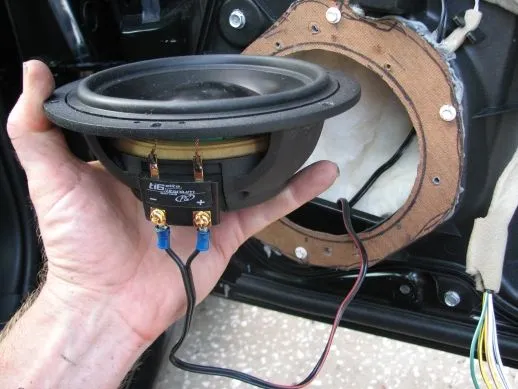

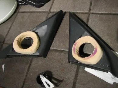

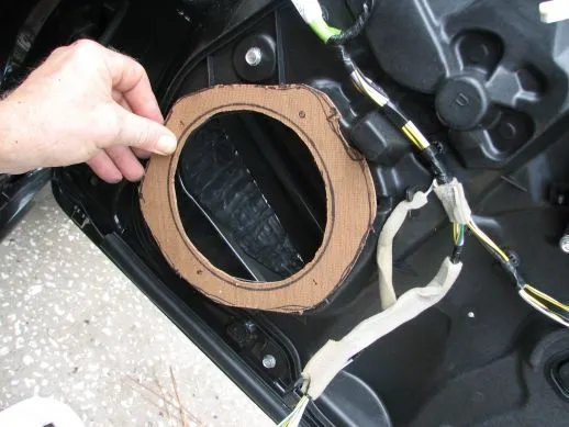

the mounting

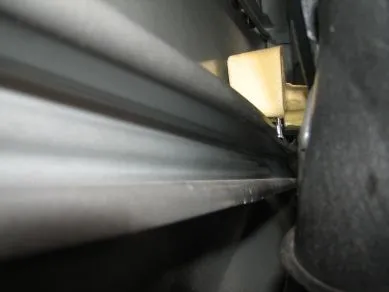

the front used a smaller dia driver, so I made a plate to adapt. the rear I used a 7 inch driver and only need to fill in a small area
you just need a tight mount and caulk the gaps.
depths are listed at like 3.25 and 3.75 f and r, main issue fitment wise, is the door panel has a plastic ridge wich may hit the surround just shave it off with a sharp knife. last pic I illistrate the tweet wire coming out and runnin up toward the sail

part 4
next pic shows the crossovers
these are the taped up things
you may buy a component set with xovers all nice and made up. use them, they will likely serve you well
I used a 12db 2nd order

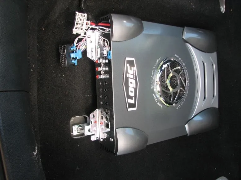

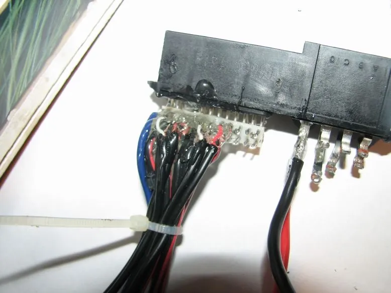

allright, so what feeds the crossovers??
clean flat signal (with the exception of the amps internal xovr) from a HIGH quality amp which amplifies.
not distorts, adds, subtracts, whines, hums, etc
it must be fed CLEAN signal, it will amplify every thing (crap in, Lotsa crap out
located in an area with air movement since it is not 100% efficient, it gets hot
it gets three sets of wires runnig in and out
power wires
input signal
speaker level output
speaker wire is pretty imune to screwup

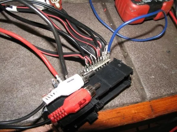

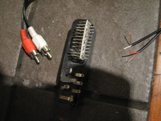

run the input (rca from the HU) and power(12+ from the radio freq generating alternator) parallel to each other, close enough,and for enough distance, and your input will act like a little antenna and infuse itself with alternator sounds which get amplified
OH Joy
mazda avoided this.
I took signal and power from the mazda connector, and made no parallel paths with the very short pieces I added.
I have NO whine.
I am happy
run fat ass 4 g amp wire and rca from the back of a aftermarket HU at your own risk
I used the connetor from the bose amp so I could avoid making joints on the 3 inches of wire sticking out of the carpet. I did my soldering on the kitchen counter with good light and a nice chair. the car it self remains unmodified, only the bose amp was injured in this process.
spca (Society for the Prevention of Cruelty to Amplifiers 1-800-111-2233

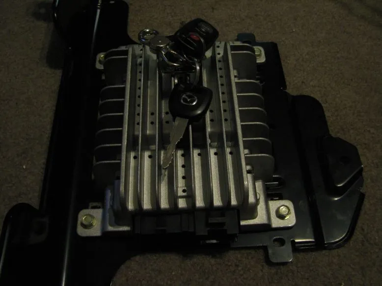

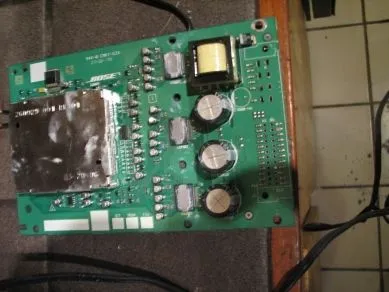

Physical mounting
per one of my parameters
Dead stock appearance
the new amp goes where the old amp was
I used the 2 convienent studs mazda provided and made a couple brackets
you can see the red power wire if you look for it, and the mazda cable for the seat position sensor ( friggin car knows where I sit)! sticks out a bit
this took some time and I want to thank my two assistants for keeping the area free of lizards so I could work

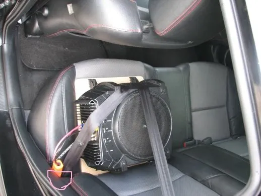

part7

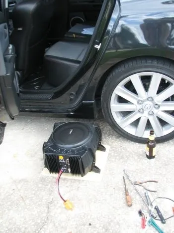

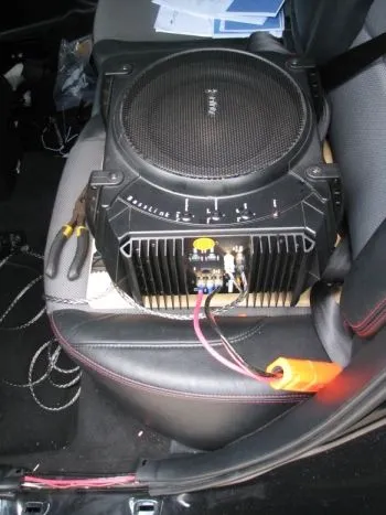

THE SUB
I originally bought a blaupunkt sub that would fit under the seat where the blose rich bass system goes.
this piece of crap wasted alot of my time and 80 bux
not happy with that
I bought a basslink from infinity to replace it, it is well rated, I have used it for a day now and I agree. and flexible between the gain , Db, and cutoff, you can get it where you want it.
it is a high value unit
the problem
I screwed up when I researched the basslink
it will not meet a parameter
fails the stock appearance clause
so I improvised
I have two kids
15 and 17
it is exceedingly rare when I need to have 4 people in the car
I am Tall, and the seat (throne, friggin bus height seating) is always all the way back (except autoX, 2-3clicks up)
I value hatchspace more than rear seat space. shopping etc
besides, a sub in the hatch, how do you hear that???
flip the seat down? fail
pound sound thru the hatch cover?... fail
SOOO

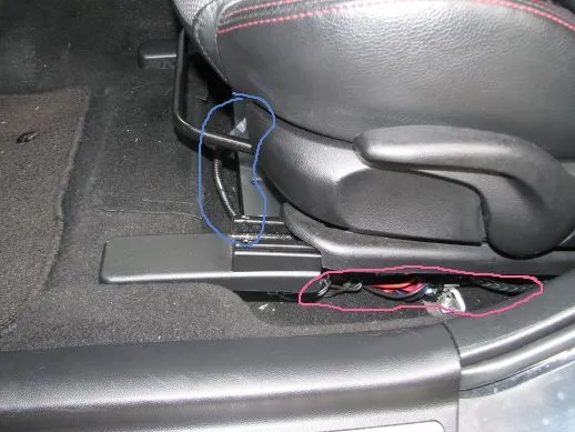

I hid the wires (power) along the left side and signal, under the mat, then seat. NO whine
then using the convienence of the standard 120v grounded connectors
three conductors...... 12+, ground, remote12v
I made a quick disconnect sub setup sitting on the rear seat behind me.
circled area is all that will show when removed, small female half of the connector
sounds GREAT
permits seating 2 passengers anytime
removes to store in the hatch in less than 30 sec

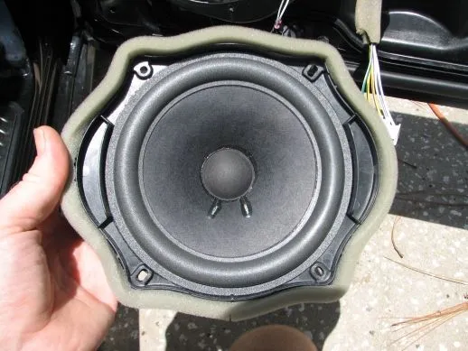

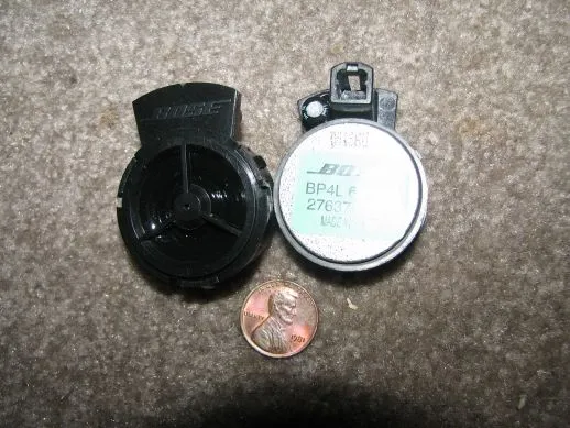

The last 2 shots are of the stock bose drivers
the four doors are identical
they are NOT like all these shots we have seen of sport owners drivers
they are NOT 6x8 like crutchfield proclaims, though the mount likely is
they look nice, I think they would take 20-30 RMS and do 100-5k very well.
I may use them to make a tiny guitar setup with a 25 watt tube amp I have laying around
the tweets, of course are a joke, and the single worst part of the system, the second being the circuitry in the amp which is biased to protect them.

I hate to break it to you, but you got the original Basslink, the 200w one. I had that in my last car, it was OK (to be fair, it was in the trunk of a sedan). I have the Basslink II (250w, upgradeable amp) mounted upright in the hatch bungie-corded to the child seat latch on the 40% side of the 60/40 rear seat.
I haven't had much time to tinker with it, and right now I'm getting the signal from the rear pre-amp channels. Tomorrow I'm going to tap into the front pre-amps and see if there's any difference. But as of now, I'm liking the low-range oomph and minimal loss of hatch space.
Thanks
basslink 1
I misspoke
I have the gain down to 50-70% so, glad I don't need the extra
Nice work on the install. I've never seen anyone use the stock amp connector before, lol.
So this continues to support the theory that the HU and pre-amp wiring is more than sufficient for a stealth install - without the need for a complex signal converter. Mine is going in early next year, so I'll be sure to post accordingly.
BTW, you might consider linking this from the Electronics Forum since this won't get a lot of traffic. (2thumbs)
What gauge is the factory power wire? Just curious how much current it can handle. I'm still debating whether I want to get an amplified sub or just run a passive sub off channels 3 & 4 on my amp (I did this on the Mazda6) and not use the rear speakers at all.

the "rich bass system" is just a nice tiny, isobaric sub not self powered. Interestingly, its speaker wires come from the power/groung section of the amp connector, separate from the signal in/speaker out section.
You would not be wrong to run without the rear doors, technically very correct. From a front stage perspective. BUT you will be asking your front doors to run down to under 200 at least, likely to 125 to avoid a hole. the front door internal volume is way to big for a 6.5 driver, and as the only woofer running between 125 and 1k , it will have to hump it pretty hard without much support from an enclosure when you turn it up. You will also feel the door vibrate, and likely have a buzz or rattle to deal with. The rear door is smaller, and much easier to deaden, and stuff so it is a better woofer enclosure.
Guage? dunno, 10 I'd guess
I did cheat, when I was trying to run the blaupunkt powered sub under the Pass seat, I tapped this fat ass pink wire (just with 12 g though)and ran it down under the pass seat.
when I installed the main amp, I figgured I'd help it out and snuck the 12g over the hump under the center console. I left the carpet intacct and used black wire for the run, its visible, but you really have to look to see it. so, it is fed with the stock wire, and a 8-9 ft run of 12g
I have not heard my system starve for power, but this would be a very ideal place to use a cap, and I will likely get one

well. here we go to further the cause, I found some tweets that will take 100 rms and I can x em at 1600
snug in several ways, I have a third order setup to chop it off harder and they present 1.9 ohm to the amp when run in parrallel.
also, I think the sail panel pop connector is not made for a pound of tweet magnet
epoxy should help
I believe I have elevated my front stage

but if someone local with a blose wants to pop there fav CD into my system and report back to the group...............
Thanks for trying to shed a little more light on something that many members find difficult.
I have one issue though, how do you feel that a big ugly sub on the seat is stealth? I realize it comes out, but then you have half a system.
I personally chose the jack sub option pumping over 300 watts to that poor little 8". This setup does not pound like the two tens in my truck, but in conjunction with the stock sub, (I left in), makes some tight bass and qualifies as stealth. Long story short, the stock system, (Bose or not) is pathetic for a car this new and requires extensive mods to make an audiofile happy.
I know it's a lot of car for the money, but if you're going to offer an audio upgrade it should include more than just decals.
Keep the ideas coming though.
I know the sub is not stealthy, but it was all I could do with it when it became apparent it was not going to fit where the rich bass piggy bank resides.
The jack box is my alternate choice, for sure, but I just do not see getting enough volume to make a correct enclosure and stay flush. Though sticking out there would be minimally intrusive.
Strick has a very nice ilooking nstall, but it reduces the hatch to a couple bags of groceries, that could still fall onto the sub.
Most of the time, I have a rewarding audio experience, on rare occasions, I have both seats folded all the way down, and a bunch of crap laid in the hatch. when that happens, I still have the rear doors runnin strong down to 150Hz.
If I could get the jack box volume to tune to a f3 of say, 25, or even 30 would be tolerable I would go that route.
I have a nice black shroud over the basslink now (nana)
