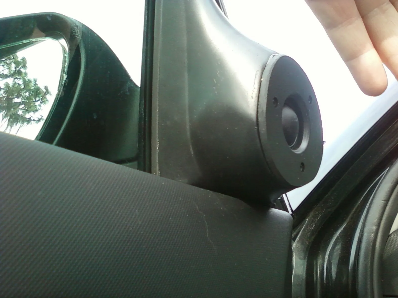

Pics of the tweets crossed at 1600hz below the vertical line is a photo artifact, and I tidyed up the edge of the tweet itself post install

My only concern here is about those tweeters. They look like home speakers, which are designed for a different audio environment. I hope they don`t end up sounding wrong in the car. What are they, exactly?
http://www.parts-express.com/pe/sho... &FTR=264-526&CFID=15756718&CFTOKEN=85853601
they are mebbe a bit directional for a car, the sound though is quite good, and they are bright enough I was able to lose the EQ and I am screwing around with the fader treble and bass in the plus minus 2 range for tweeking
