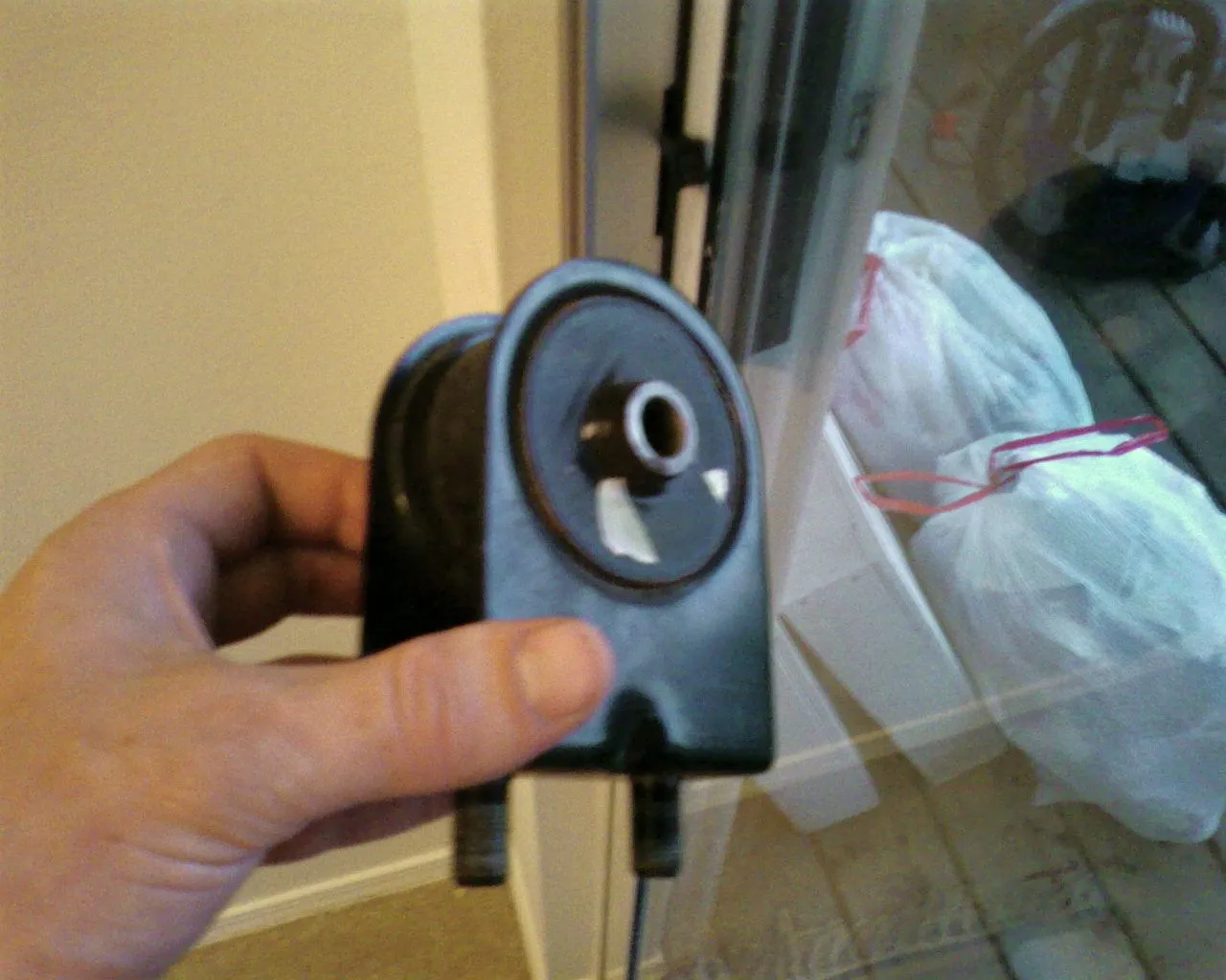

joined the club. stoped all the motor movement. Ill chime in if it gives me any problems.
I can't remember when I last chimed in, but it's been at least a year and I have 0 regrets for this mod.
I wonder how stiff the AWR mounts are, but I don't know if I'd like the mounts any stiffer.
that looks really good!! what did you use to fill it in?
two tubes of 1 min epoxy. I read through all the selections at the store and they said that this bonds to metal and ruber and stets flexable and resists cracking! almost like they made it just for this aplication LOL. having probs getting the rear mount off though.
