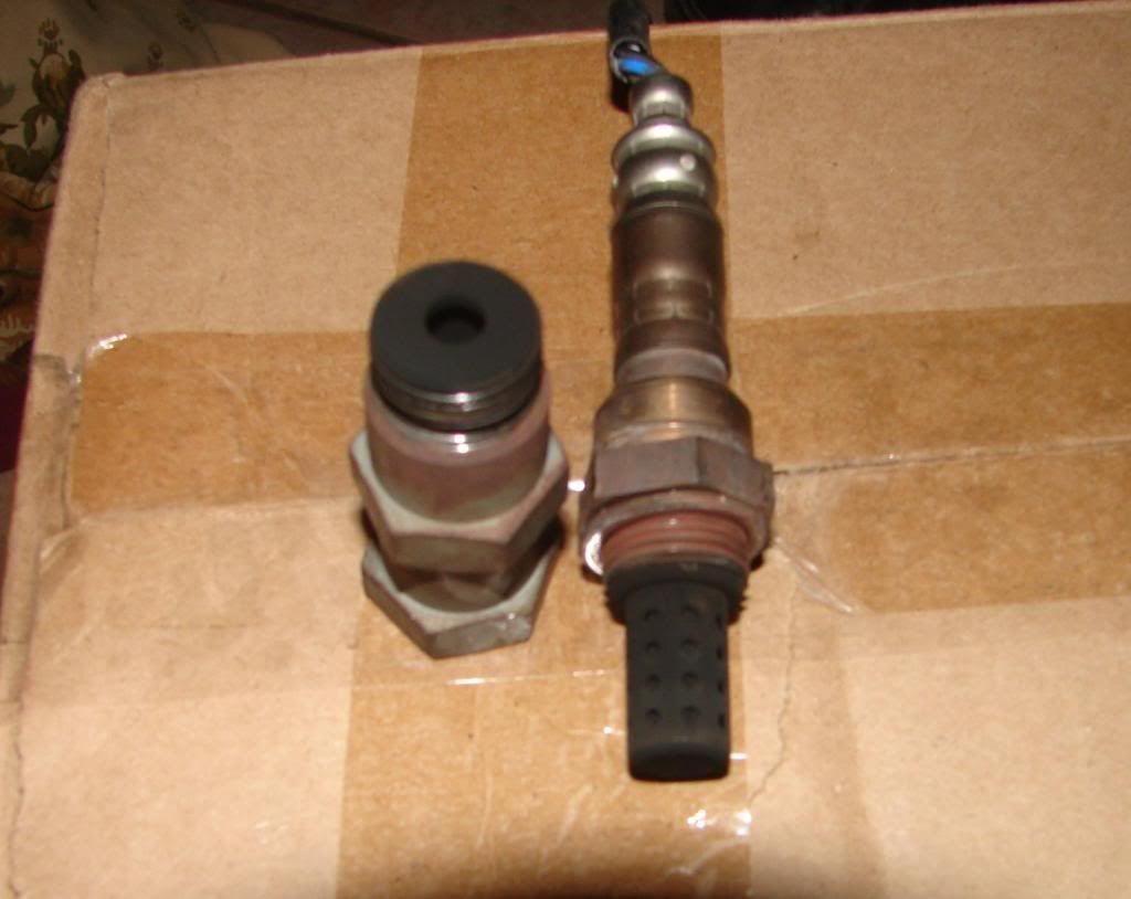

I got mine at Advance Auto in the "Help!" section, it came with two gaskets.
amsgator said:
did that come w/ only one gasket or two? it looks like one in this picture but in some of the others it looks like two...
what part number? i got the 42002 and it didnt come w/ any. and it was help brand too....idk
I got mine from NAPA with the part number from the first few post, which I assume is the same as the above pic, and it didnt have any gaskets, but I have had no problems without them anyways so it dont really matter I dont think.

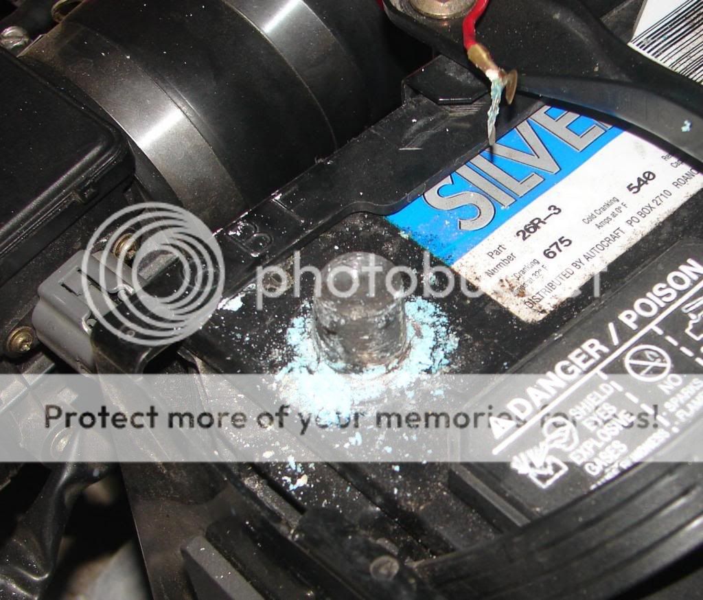

On another note... Ive had the non-fouler in for quite some time now and about a month ago I got a CEL, but sence I was 99% sure it was because of the header I reset it. Now, hundreds of miles later it comes back, so I stop off at auto zone and get it read. It was a 2nd O2 sensor code just as I thought so I came home and cleaned off the non-fouler and O2 sensor. Also my battery was getting some nasty corossion on it as well so I cleaned that up. Question is, do these look too dirty? They looked about normal to me...
I cleaned them up anyways and reinstalled them, as for my battery, it was just a 5 min job....
As a result of cleaning my battery terminal I have reset the code and hopefully it wont come back, because having to rest all my custom settings on my radio is becomming a pain in my ass. I have no real question here, I just wanted to update on everything, but why the heck not while im here... Can reseting the ECU too many times be stressful on the motor or the computer systems at all? Thanks:)
my o2 sensor isnt that dirty but the non fouler is. idk if that helps or not. coke on the corrosion works wonders! just rinse of the stickyness :)
Yeah, I didn't clean the O2 when I did the header install, I think I probably shoulda. Ive heard coke works well on the corrosion but I still cant bring myself to pouring coke in my engine bay. I got it cleaned up tho:)
