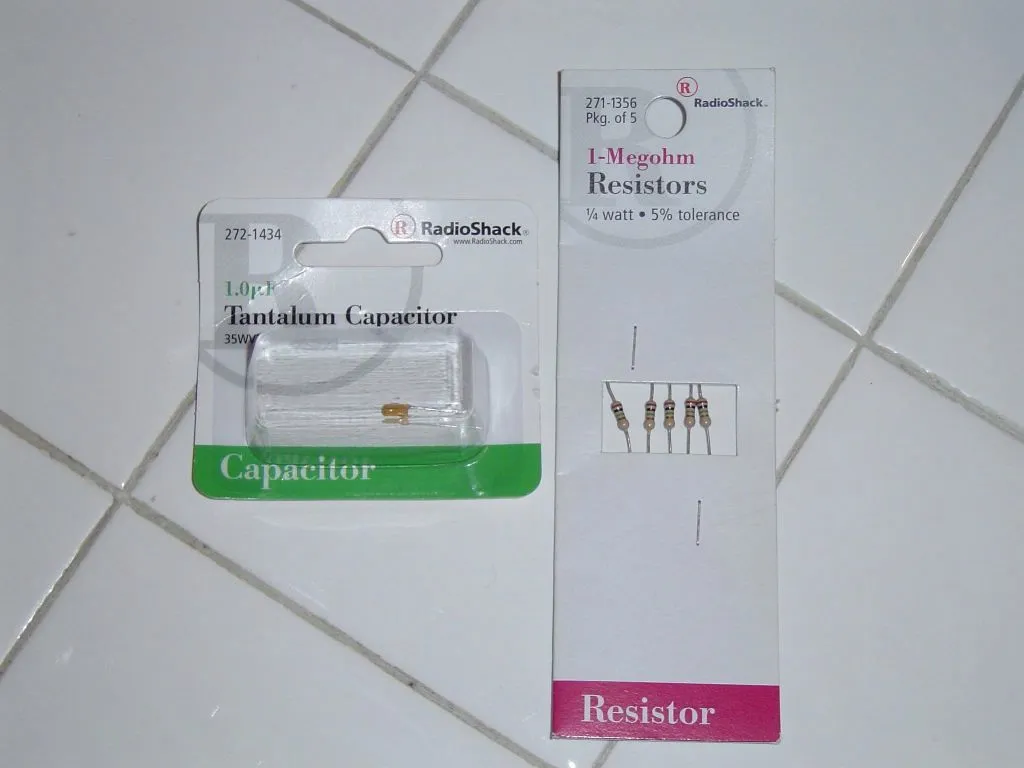

How big/small should the resistor and capacitor be, physical size wise? They have a couple of different ones there. I got the 1/4 watt resistor and the 35wvdc capacitor. They are real small and from what memory serves, they are the same size as the ones I put in my friends WRX. I'll take some pics later, my battery is dead.

Should be smaller than a cig in girth(width..and as small as your nail in lenght)!

Check out this pic. You can tell the size by comparing it to the staple in the package. I'm pretty sure the capacitor is correct, but the question is the resistor. The 1/2 watt one is a little bigger, like this size plus another half of it added on. What would happen if you put too small of one in there, would it do any damage? Zoom in if it isn't too clear of the size.
looks right to me..it really shouldn't do any damage..if it's not done correctly..it can cause the ecu..to put out a CEL saying that the Sensor is Bad..but really the connection is not correct!
