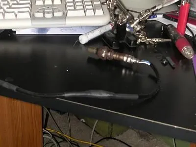

edit: here's a pic of my modified O2 sensor, looks kinda discrete

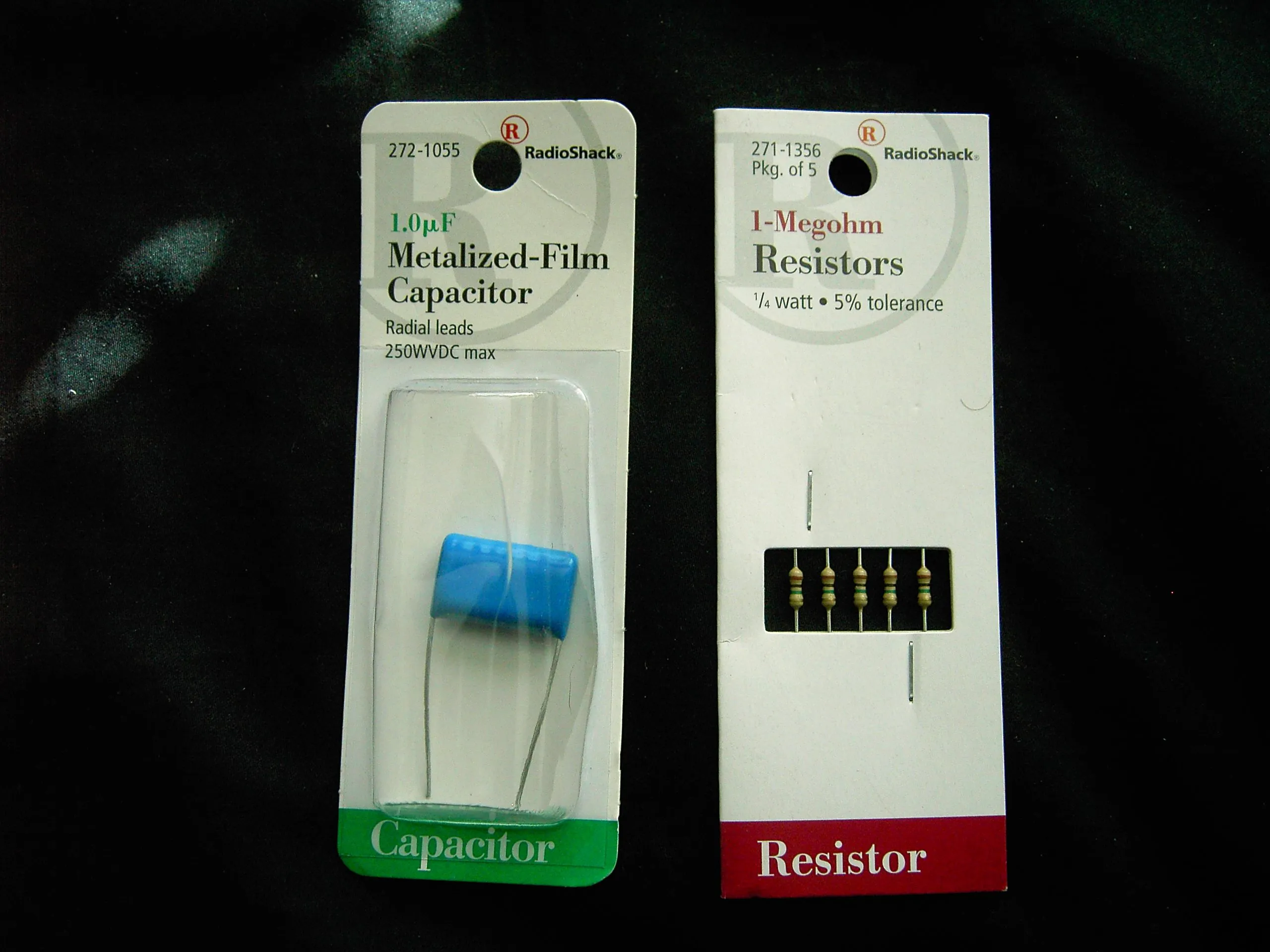

Picture of the pair I purchased
RadioShack Part #s:
271-1356 :: 1-Megohm Resistors (1/4 watt - 5% tolerance)
272-1055 :: 1.0uF Metalized-Film Capacitor (radial leads 250WVDC max)
UPDATE:
After 144.3 Miles I threw a CEL. Going to try a smaller resistor.
