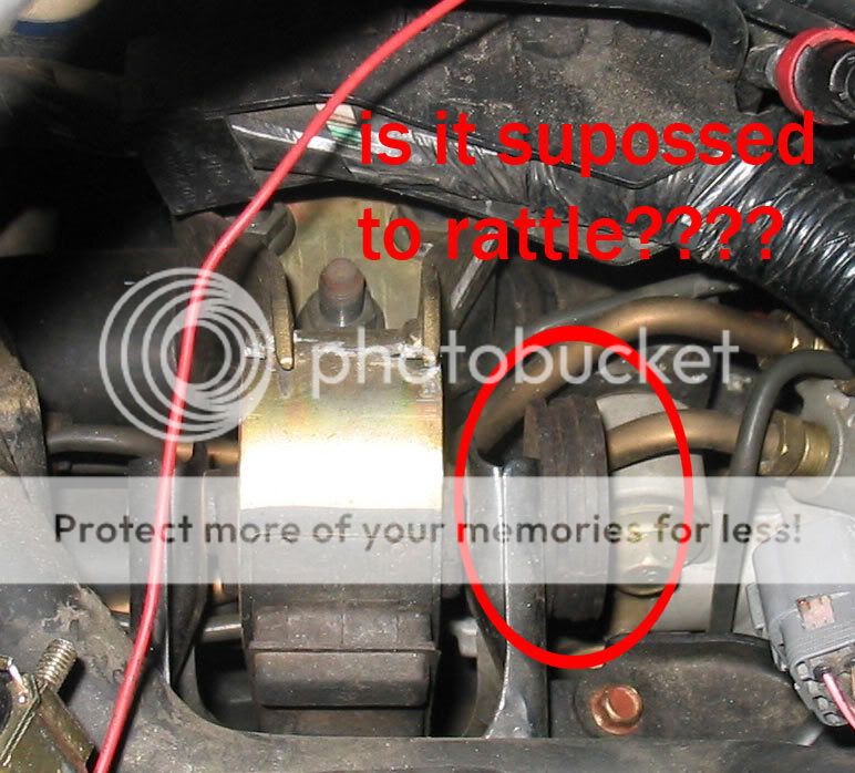

I was trying to clean my EGR valve when I noticed something.
This part right next to the rear motor mount is very loose, to the point that it rattles a lot. I tried tightening the bolt but it wasnt doing anything at all, I spin it for like 30 mins straight (due to the space limitation I had to do very little at a time, so it took a whole for a complete spin) and still its just as loose as before.
I don't know what it's supposed to do but it should'nt be loose...i've seen this on mine changing for awr's.I recall there's a flat somewhere on the circle side so it should be a kind of rotation stopper. tightenning the main bolt should get it tight though. maybe the rubber is so worn you where just getting the bolt head throught it while tightenning.??
I seriously hope that is NOT Your rear motor mount!! If it is get a new one fast...
dude is your rear motor mount cracked or is that just a bad welding job? i think that may be your rattling problem b/c it definetely looks cracked to me!
yeah i don't think there's anything about that crack being awesome. haha. would it be reliable being welded back together possible or having to buy a new one? i'm curious how that broke? i guess you guys are right, it's caused from the awesomeness power of the MSP. ha.
Ya get that crack looked at. And for those that even consider cabin vibration to be even the slightest issue, do not do the rear motor mount. Even with the softest urathane bushing, it's alot more noticable than stock, and even way more than what you feel between a stock front and urathane front. I'd look into side inserts instead.
