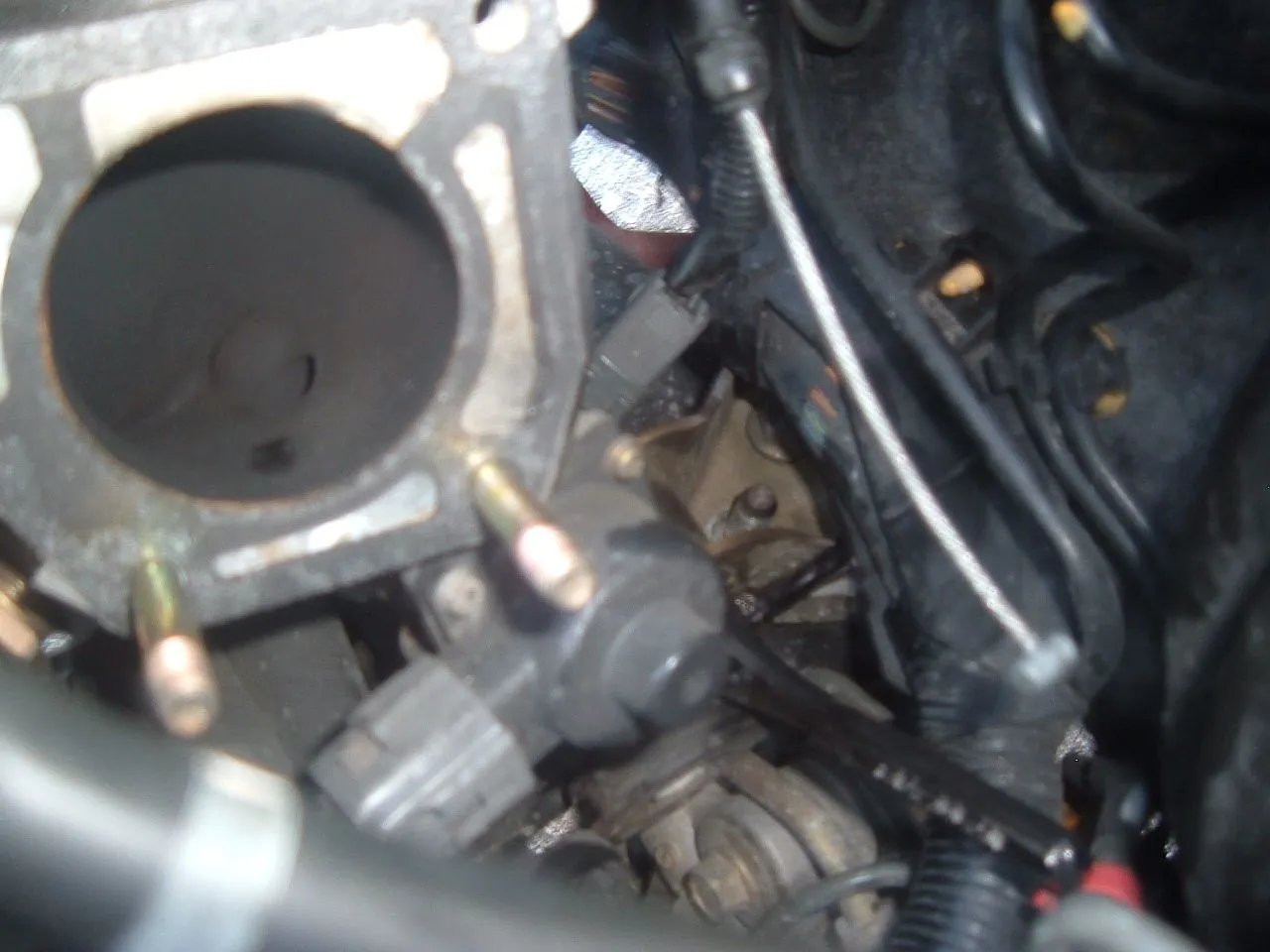

Would it piss you off that I can get that bottom nut off within 10min if that once I have access to it?
yes it would. even if u would, then how will u take the nut out without breaking that stud?
I just wedge the socket down onto the nut and pry against that stud to get straight onto the nut for easy removal.
The ratchet I used was one size smaller then your standard size. Going one size smaller leaves plenty of room between the raise part of the mount for the deep socket to get onto that bottom nut without hitting aything for that firewall bracket.
Edit: You don't have to remove the TB but I did to give myself more room.
