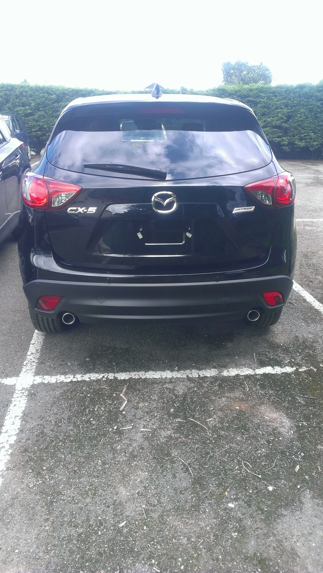

waited soooo long
Hi all the cars here now the fun begins so many mods waiting to apply
