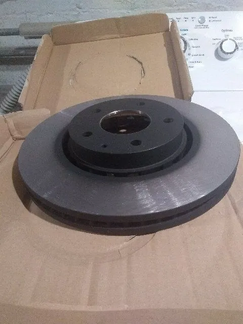

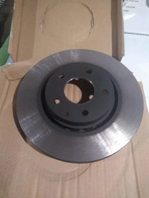

Here's something about my 2016 and front rotors. I'm planning on changing front rotors and pads next week. Now, I always use Centric rotors, they're my favorite, but for some reason front rotors from Centric aren't available, from Tire Rack at least and a few other outlets, until December of this year, so I opted to go OEM. The dealer needed my VIN because Mazda apparently used 2 different rotors for the 2016 model year, something you won't find in aftermarkets, at least Centric didn't specify 2 different rotors. It's a decent looking rotor, $83 a piece, Centric rotors from Tire Rack were $79 for one. I'm going with the Akebono pads. Dealer, by the way wanted $94 for a set of front pads, none MV. Almost a $26 jump from 2 years ago when I replaced front pads on my 2014.
attachment.php
attachment.php
